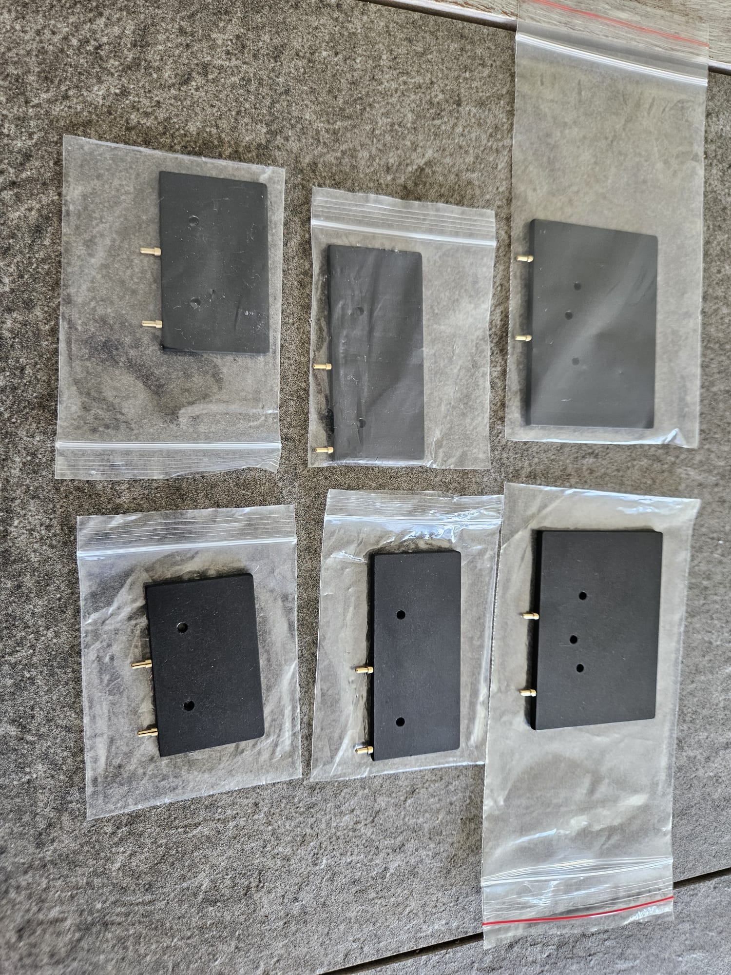

We're excited to share some great news, which we hope will enhance your amplifier building experience.
The Wolverine team is thrilled to announce that anodized heat sinks are now available for our project.
These heat sinks are specifically designed to fit perfectly with our current boards. Here's what we've got:
  • Heat sinks suitable for the IPS Boards V4.9.
  • Pre-driver heat sinks designed for V4.2 of the EF3-3 & EF3-4 Output Stage Boards (OPS Boards).
  • Driver heat sinks for V4.2 of the EF3-3 Output Stage Boards.
We are offering full sets of these heat sinks, which include installed Mill-Max pins:
  • EF3-3 IPS, Pre-Driver & Driver: $27.5 USD (6 Heatsink Total)
  • EF3-4 IPS & Pre-Driver: $22.5 USD (4 Heatsink Total)
Thank you for your continued support of the Wolverine projects. If you have any questions or would like to place an order, feel free to reach out via PM.
@jjs is in the USA, and I am in Australia, so please PM whoever is closer to you, and we'll arrange some for you.
Happy building!
Best regards,
Stuart & the Wolverine Team

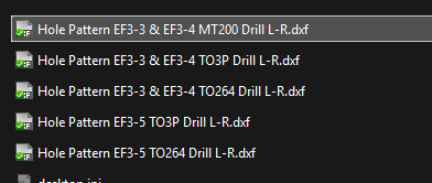

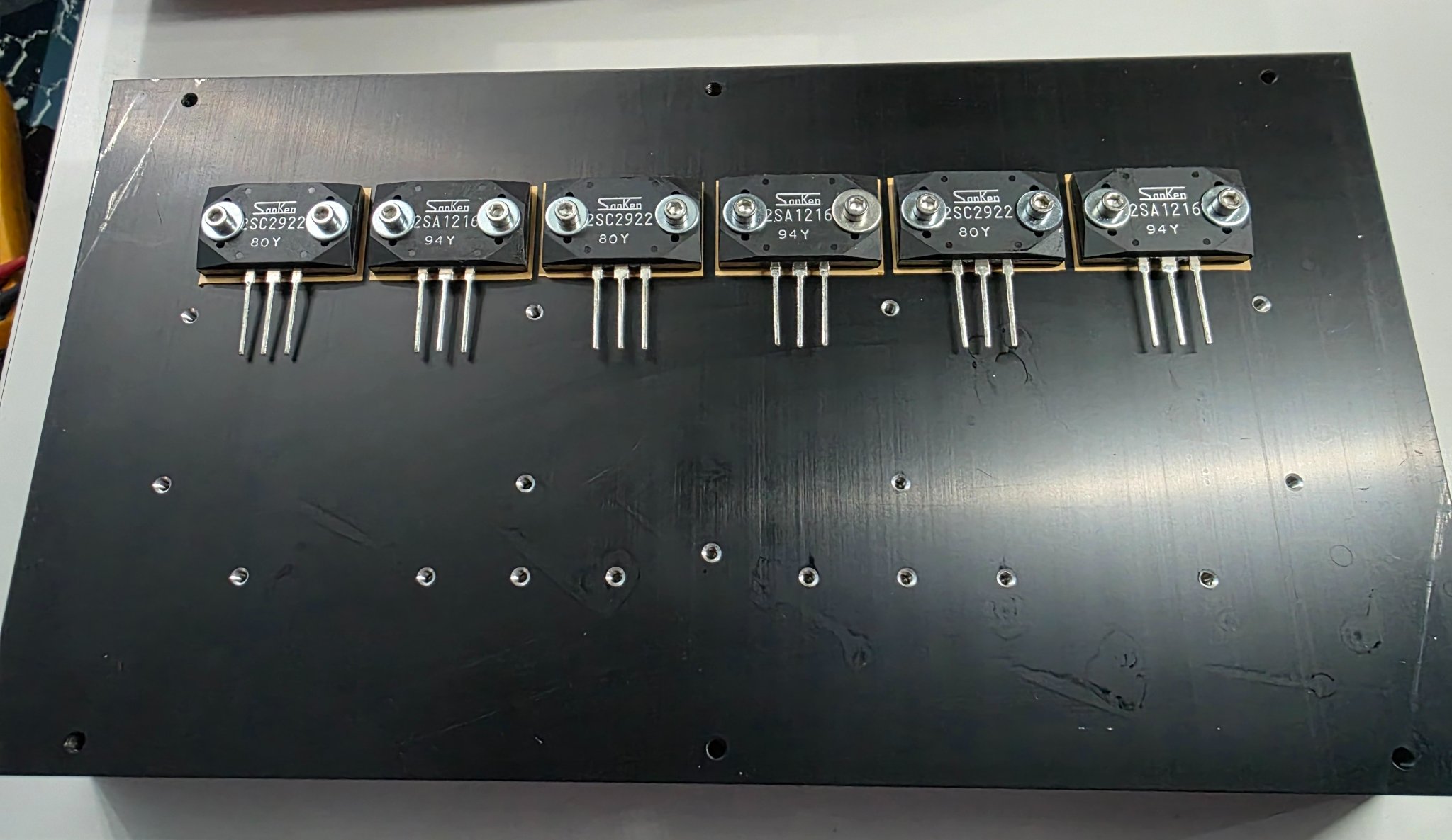

Hello, i have found 4 couples of SANKEN MT-200 2SA1216 / 2SC2922. Can I use the 3 couples for the Wolverine EF3-3 boards (V 4.2) ?​
I don't think is known the drill pattern for the 3 couples. I want to build 2 wolverines. One sanken 3-3 and one v5 for 4 or 5 couples....
You can use MT-200 packages on the EF3-3 & EF3-4 only. You can specify this at the modushop here.

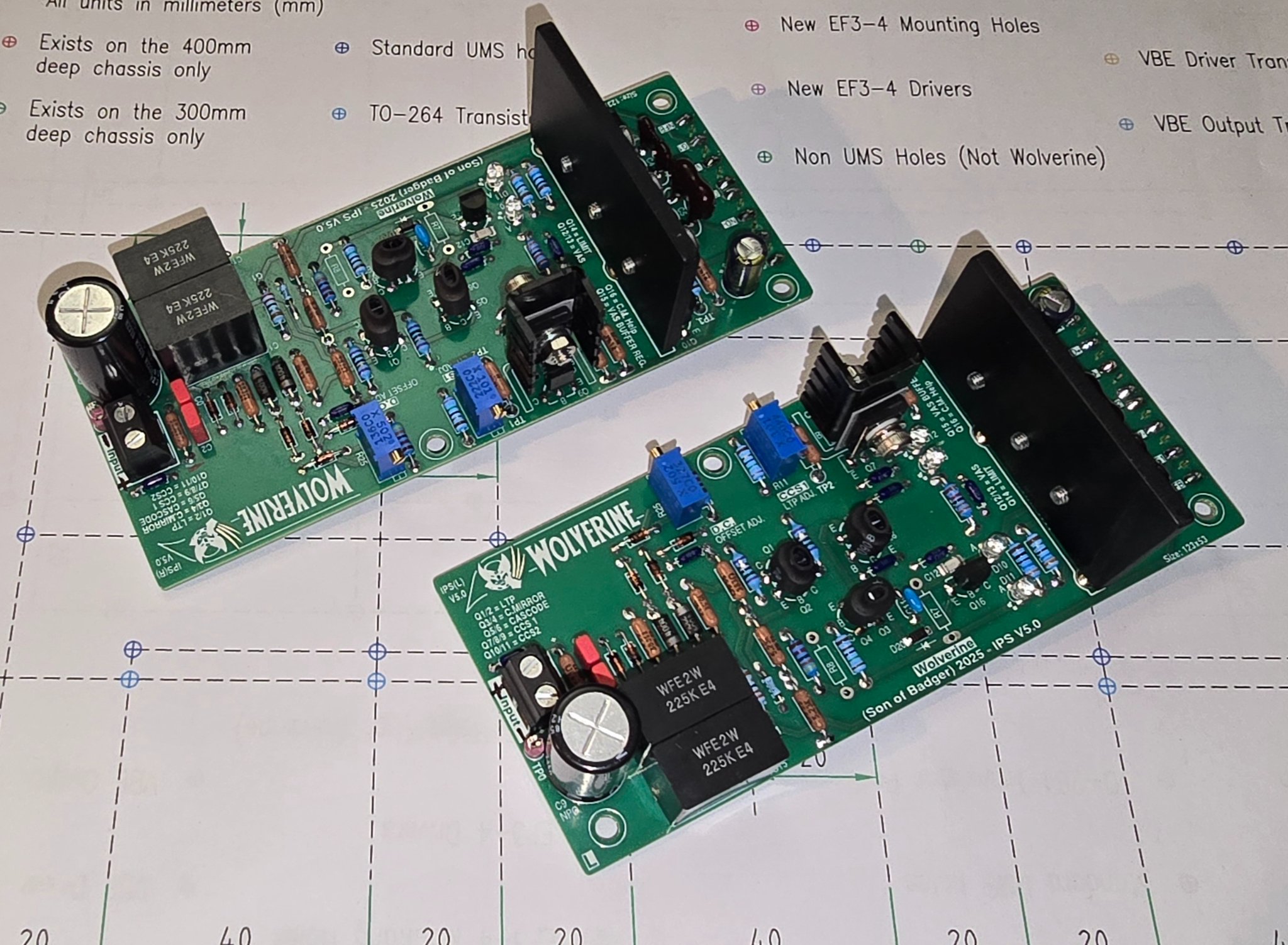

Hi Wolverine amplifier builders,
We would like to announce another option for the Wolverine Version 5.

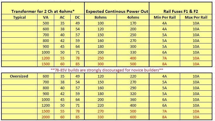

If you are planning on getting in on the PCB group buy, the V5 EF3-5 option which has 5 pairs of ouput devices is capable of running higher supply rail voltage for some more serious output power options 🥳
Due to the voltages involved this is for experienced builders only....
Please see table attached with the various rail voltage options and a scope capture with a 4 Ohm load.
- Daniel
