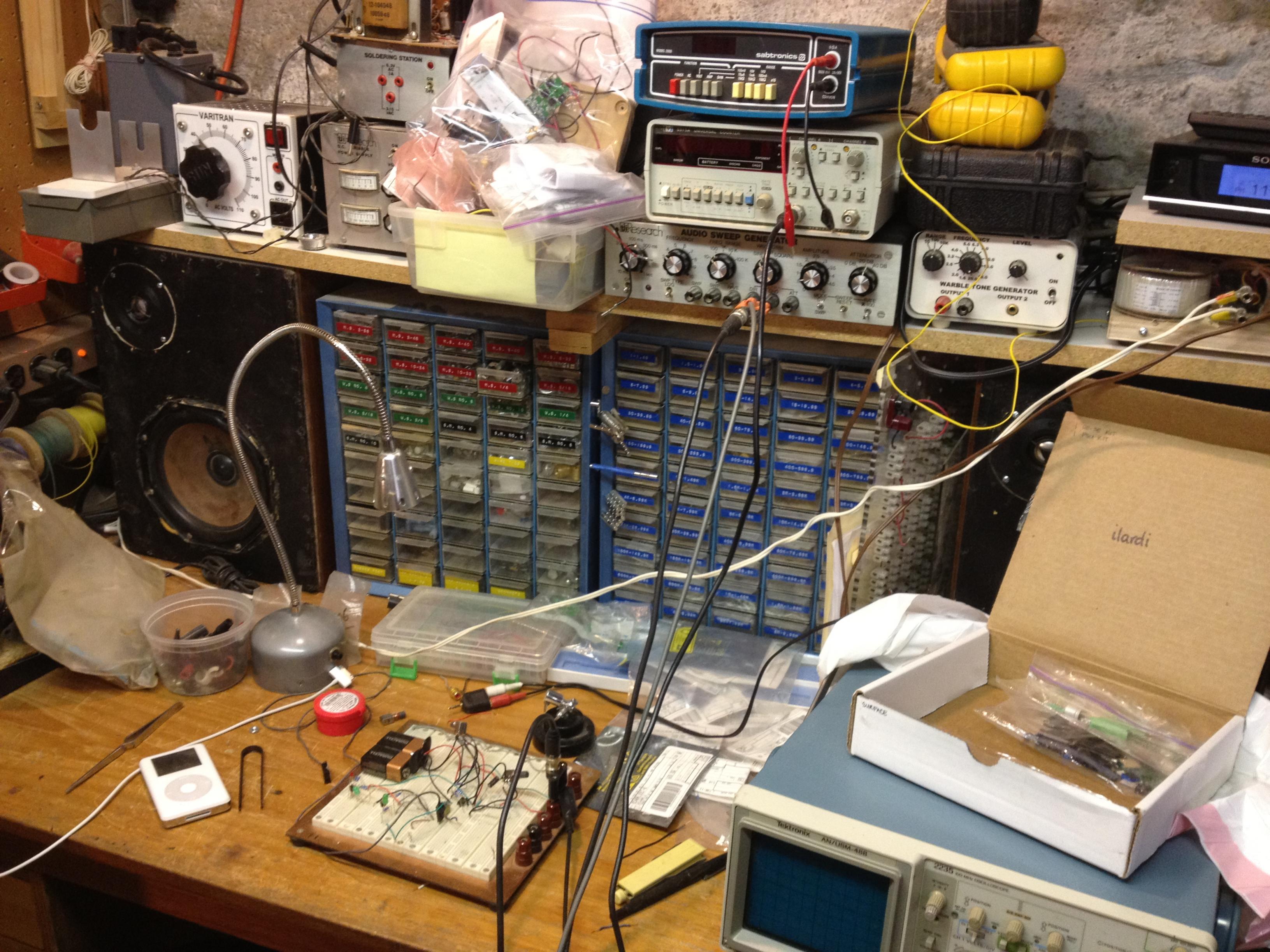

Wolfsin feelzSlightly more relaxed now about allowing others to glimpse his lousy soldering 🙂 A messy desk is a sign of an orderly mind!
@ilardi -- pls post pix of yours so we can all feel better.
hey!! workshop = chaos, soldering is generally fastidious. at least there is only parts from 2 broad ranging projects on there at the moment. it gets cleared off for any substantial build, but small ones tend to accumulate.
but yes i'm all for someone else showing their mess to make me feel better

lucky we are using 2oz copper and no stepper motors with the boards characterised with lower noise than an AP2 can measure hey?
yeah thats not bad. i need to get some of those large parts organisers you have there rather than the portable type i'm using combined with stuffing things in cupboards, i'm building some simple dowel racks for the kilometres of wire that should free up quite a bit of space. first of all though, is dedicating the next few months to finishing off current projects including casework, before taking on any more.....
