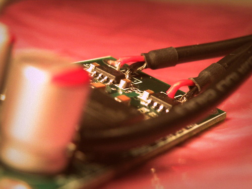

Hey all, I built the Wire BAL-SE, all I can say is BEAUTIFUL! Thanks OPC 🙂 So grrrrreat!
And yes, OPC is correct, with any recorded music in your collection, unity gain for the BAL-SE is more than enough. Having said that, if you are in a recording studio situation (where the signals feeding The Wire are-cue mixes which aren't yet mastered), the levels going into The Wire might not be hot enough to get your headphones to a happy level. This isn't The Wire's fault, it's just that the incoming signals are low.
So, I am going to try boosting the gain on the BAL-SE version - and although I saw some suggestions for the SE-SE, as far as I could search, nothing has been posted about values for the BAL-SE version. I think I can figure out the values myself, but just to be sure, I wanted to run it by the collective expertise.
So, I'm looking for a gain of about 1.6X (even 2X is needlessly too much for my purposes). For BAL-SE, I would love to know which ONE of the following would result in maintaining the best performance of this superb headphone amp:
1) Decreasing R1,R5,R7,R11 to 620ohms
2) Increasing R2,R6,R8,R12 to 1.6kohm
That is assuming my calculation is correct, that we want to increase the ratio of R2/R1 (and the other 3 pairs) to about 1.6 Another option would be to reconfigure U1-A, U2-A, U5-A, U6-A to run at gain of 1.6X, but I am going to rule that out since it would require re-designing the PCB.
Any thoughts?
PS see attached photo of my Wire 🙂

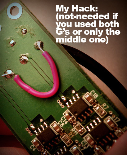

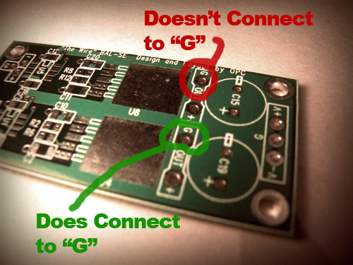

[very] Small bug on the BAL-SE, nothing major...
Hey Guys - I forgot to mention in my post yesterday what I believe is a super-minor bug in the BAL-SE PCB (and I'm hoping OPC will be able to confirm this)...
Like I said, it is very minor, but one of the two "G" headphone output pads on the PCB isn't connected to anything on the PCB at all, it appears to be 100% floating pad (unless it goes to a mysterious floating 4th inner shield layer). I discovered this by accident when at first I wired only one of the G pads to my headphones, and it happened to be the one that was floating. The remedy is very simple, just use the other "G" pad when connecting to your headphones (or probably what OPC intended, use both)!
I have another blank BAL-SE PCB, and confirmed via multimeter continuity test that the pad is indeed floating one. I have attached photos to show which one is the floating one, as well as my lazy fix (until I wire it into a proper enclosure). I would NOT go so far as to call this bug... I just wanted to document it here in case anyone else like me gets stumped as I was for 5 minutes (trying to figure out why the amp sounded so wonky).
OPC has done a seriously great job with this project, best headphone amp I've ever heard, and so simple, so satisfying. Wow!
PS Regarding those who are patiently waiting, my PCB was part of the Dec.22 batch, but I am also in Canada like OPC... still pleasantly surprised at the speed considering holiday madness with the postal system
PS #2 [edit] thank you qusp for your thoughts on the resistor values for adjusting the gain! going to give it a shot very shortly!

fualcr:
Great work on the build! Your BAL-SE looks excellent.
As soon as I saw your note about the second ground pad I grabbed a board and gave it a measure, and you are indeed exactly correct, it is not connected!
I also double checked the the gerber files and for some very strange reason, that pad didn't get any spokes despite being on the GND net. I have no idea why it happened, but it did.
Anyhow, as you mentioned, it's really not a big deal since it's purely a 3-pin system. I just need to make sure peope know to avoid using the floating pad!
I'll update the construction wiki and add a note. Thanks for the good catch!
