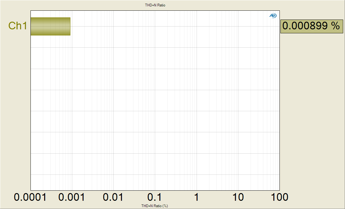

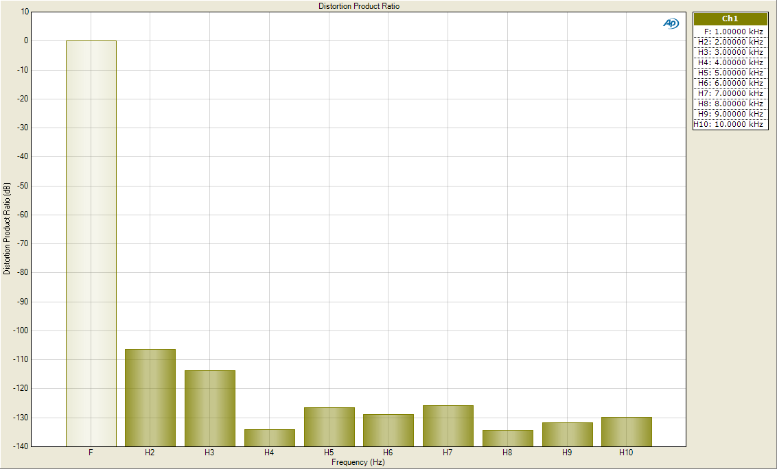

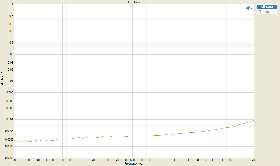

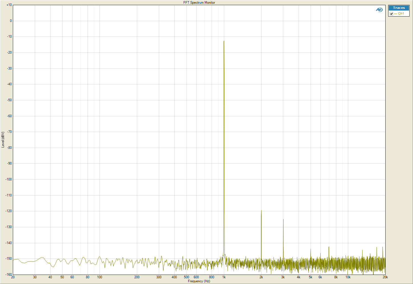

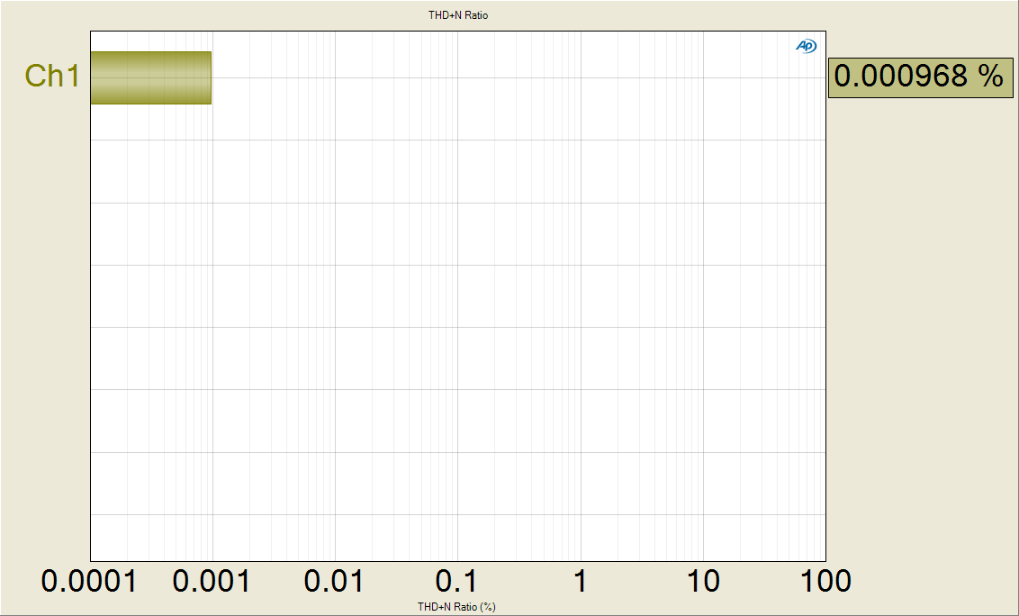

Quite a few people were asking about single ended performance, so I took some measurements the other day to show people what SE performance was like.
These measurements were taken with the - terminal tied to ground at the input of this amp. It was fed with a single ended source, and measured single ended on the output with a 32 ohms load. Drive level was 250mV.
As you can see in the graphs below, you don't give up too much performance going to SE input, so I would fully endorse using the amplifier in this manner. 2nd and 3rd harmonics are up about 10dB, but you still retain a very low noise floor and excellent drive capability. Overall distortion is still extremely low, and so is the noise floor.

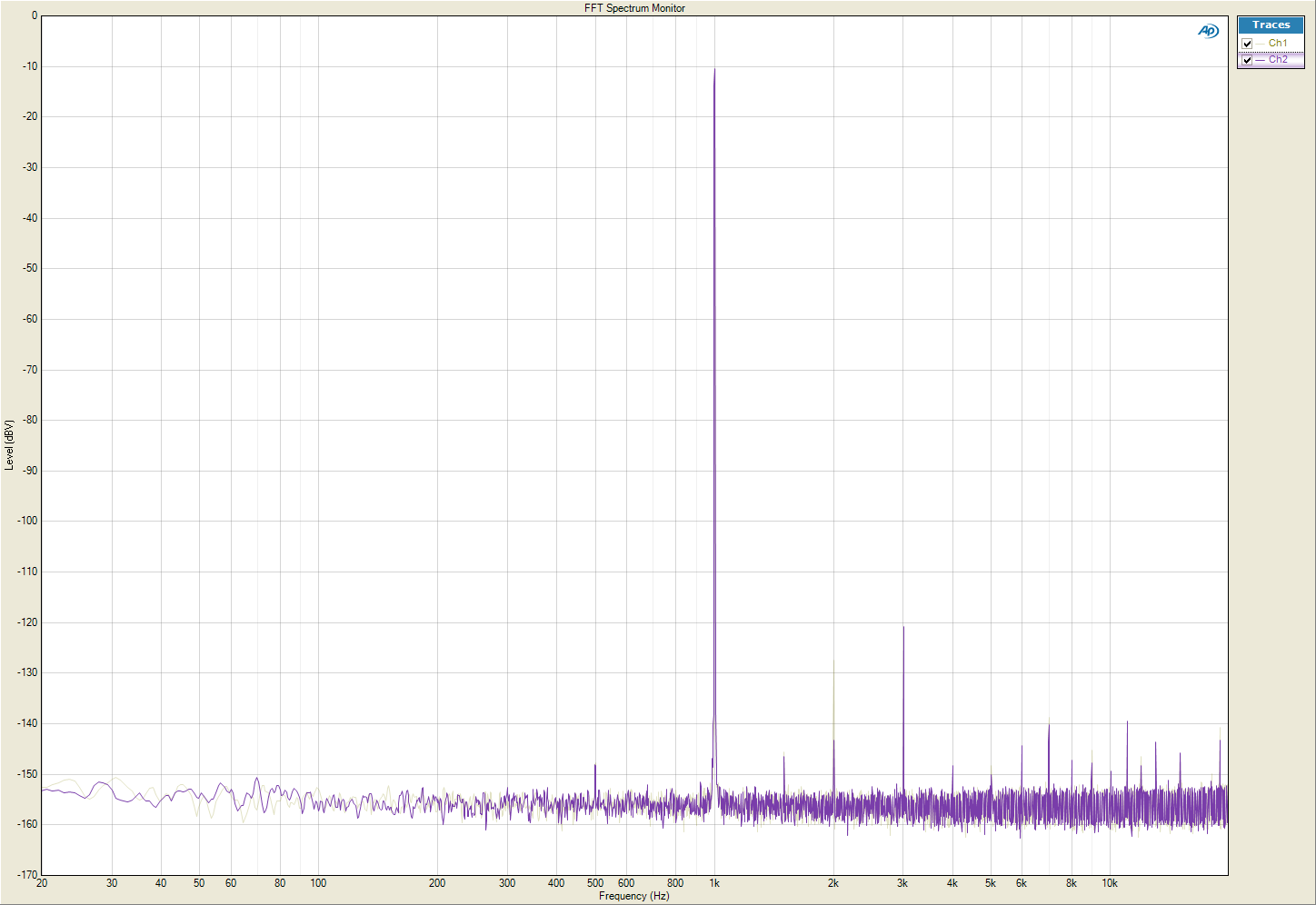

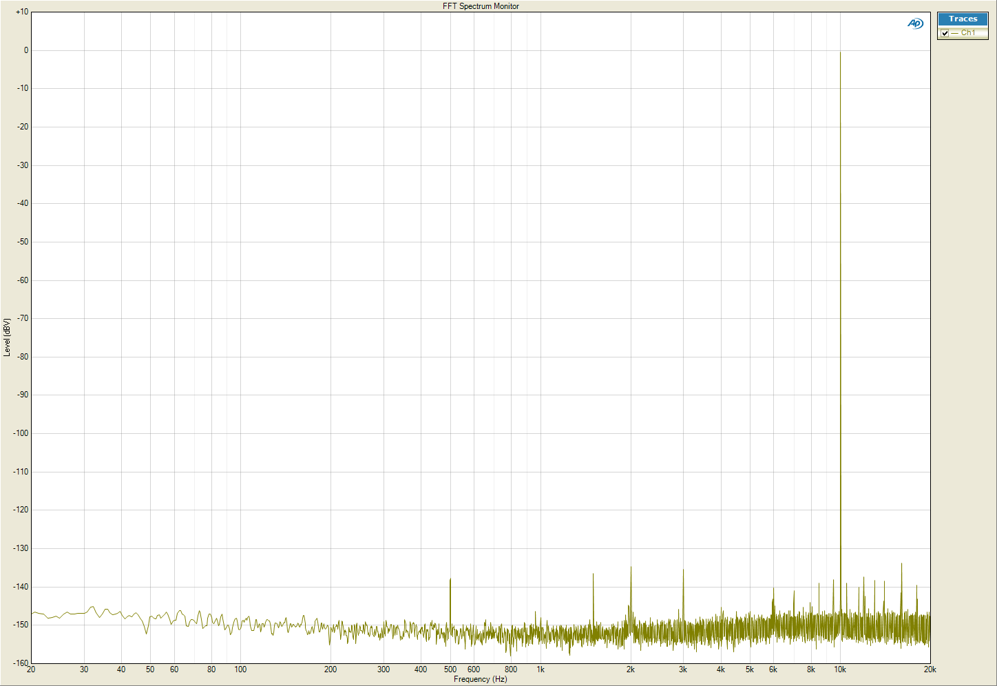

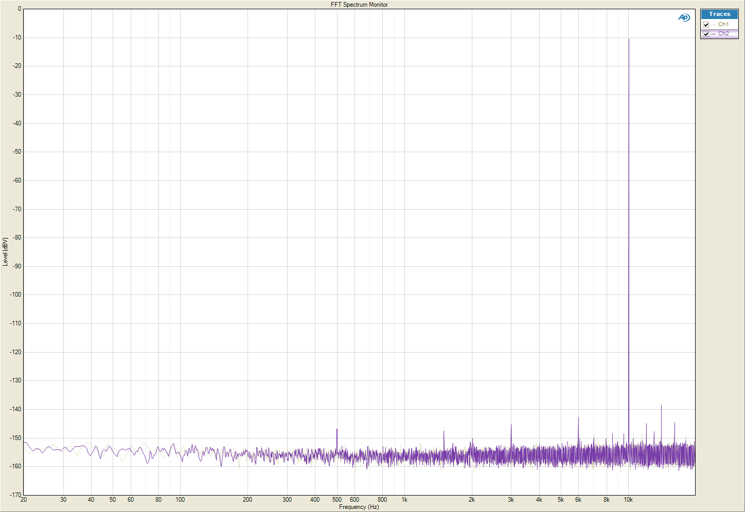

There were also some questions about FFT plots with a 10k tone, as well as capacitive loads on the output and a THD vs FREQ plot.
I performed several more measurements to capture most of this stuff, and they are all attached below.
The first three plots are all FFTs (balanced input):
1. 10k FFT at 1V into a 32 ohms load
2. 1k FFT at 2V with a 50 ohm load and a 220pF capacitor in parallel.
3. 10k FFT at 325mV with a 50 ohm load and a 220pF capacitor in parallel.
As you can see, there are no HF distortion issues, and even at 10kHz distortion is extremely low. The amplifier is also more or less unaffected by capacitive loads, and I even did a run with a purely capacitive load (only the 220pF) and there were no issues.

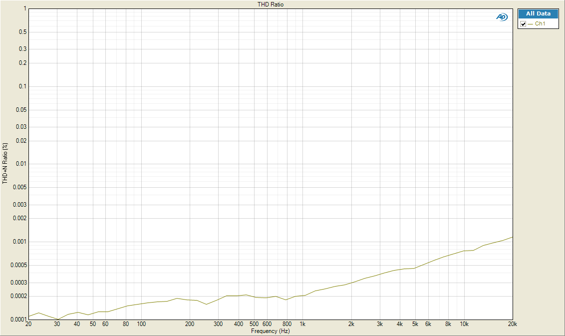

Next up we have distortion vs. frequency measurements. These are sweeps from 20Hz to 20kHz with no HF or LF filters in place. I performed these measurements with a variety of different loads and drive levels:
1. 32 ohm, 2VRMS
2. 50 ohm // 220pF, 2VRMS
3. 50 ohm // 220pF, 1VRMS
Hopefully this is enough to cover all the bases. I won't be doing anymore measurements on this, as the graphs presented should be more than enough to give you a good idea of performance, and there's far more information here than you would ever get with a commercial product.
