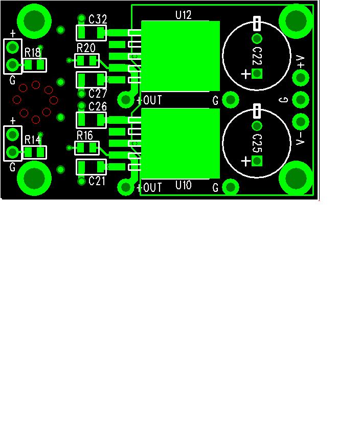

I plan to drill eight tiny holes so the metal HAt in the LME49720HA is on the same side of the pcb as the buffers and the leads protrude on the side where the 49990s would have been on a rework SE-SE. The pinout is nearly perfect for this but the power is for both opamps. Should I increase the 1uf bypass in value?
I know the resulting noise level, crosstalk, etc. will degrade slightly but I believe so strongly in ceteris paribus (and I have 720s looking for a home 🙂
I promise to also rework one and use 49990's so qusp will still call me buddy.

WOw, you guys are going to have to post pics of some of these frankenwires!
Until the wireHAt is actually working I will not post pix. I have posted an image to show where the eight 1mm holes should be drilled in the TO-99 pattern. It will be more difficult to drill these after components have been added. The holes should not affect construction of the board in any way if using the specified components.
The LME49720HA offers dual opamps so one will handle both buffers. Keep in mind that the leads must be insulated when passing through the pcb to avoid contact with the inner layer. The part is similar to the popular 4910HA but distortion and crosstalk will not be as good as the 49990 and its cost is greater :-( I have a specific reason for wanting two of these for comparison with the BAL-BAL but cannot imagine many others wanting such a frankenwire.

Running at +/- 17V
Hi OPC (and all other interested!)
Provided I use electrolytic caps with a higher voltage rating, do you think it would be harmful in any way to power the Wire at +/- 17V instead of 15V (or 12V) as recommended (stability, heat, anything else)? For me the only issue might be fitting the larger capacitor on the tight board...
The reason is to simplify power supply efforts (semi-long story) but I'll be using a similar LM317/337 power supply to the one designed by OPC, only it is running at +/- 17V
Thanks for your thoughts in advance!

Fualcr:
+/- 17V is probably not optimal, but it will work if you need to use it. The official suggested voltage is +/- 12VDC, and +/- 15VDC is also not a problem if you really need the extra headroom.
At +/-17V the LME49990 op amps will run very hot, but they are rated for it, so I don't think it will be an issue. The LM49600 will also be a little warmer, but again, it shouldn't be an issue.

how much copper pour is allocated to each buffer on the pcb? i may need to use alternative heatsinks in my portable, just some small BGA heatsinks like these, which are ~20x20x6.35mm but i need to factor in the rating of the copper area, which may actually be ok depending on how it behaves in my setup.i could maybe even just stick a bit of extra copper foil to the top
