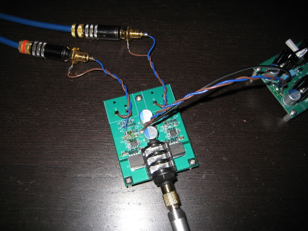

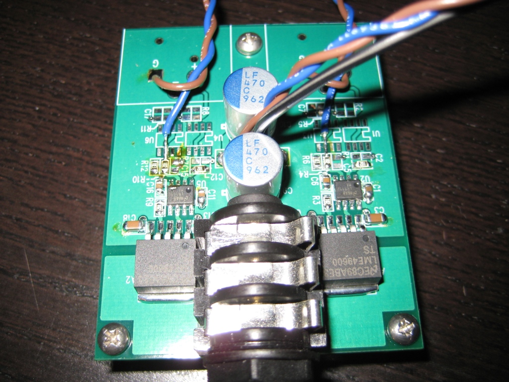

Hi Guys,
I've attached a few pictures of my evening tonight. I enjoyed a pretty spectacular sunset with a glass of wine on the balcony, and then spent the rest of the night auditioning the SE-SE headphone amp test circuit done up on the previous version of The Wire.
I've got measurements I'll post tomorrow, but in terms of listening, it sounds exactly like the BAL-SE version which is a good thing! The bottom end is superb and it's dead quiet in terms of background noise. I tried two different SE sources and both worked very well. It would be decadent overkill for a portable setup, but I think that's what I'll be doing with at least one of my boards.
By the way, if you haven't listened to the album XX by The XX, then you really should get on it.
Owen

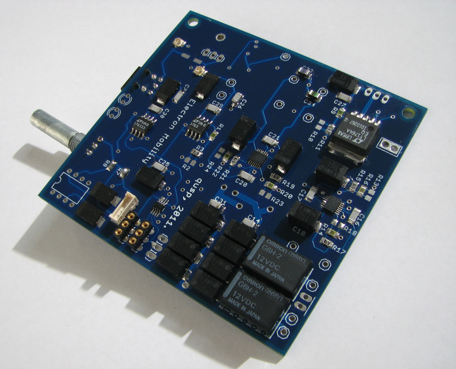

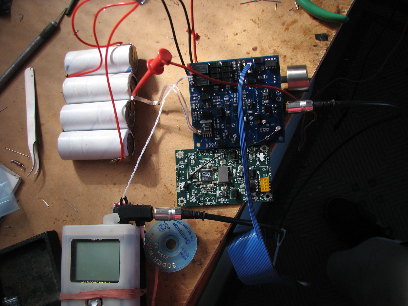

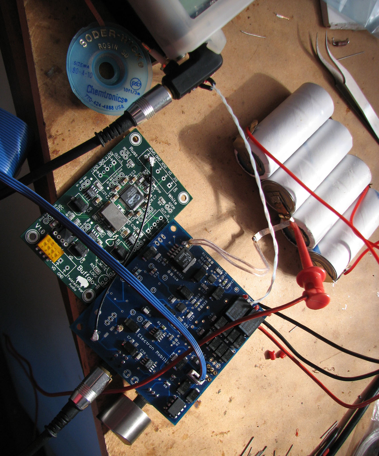

if thats decadent overkill, whats this? which is what i intend driving the bal-bal with, ive already lashed up a bal-bal using 2 x bal-se boards and the sound is pretty brilliant!!
has onboard regs for a transformer coupled spdif comparator (separate board not pictured) on mini bnc, reg for buffalo dac with separate reg with sense/feedback for the xo, onboard toslink, a basic volumite like circuit and dual mono bipolar supplies for the balanced IV, i'll run the wire direct from the batteries and possibly put additional decoupling at the psu input. but the batteries have insanely low outputz and very high current capability so no reg shouldnt be a problem, i dont think the bipolar chips will cut it as far as current for the balanced wire, we'll see
oh i know what you'll say...insanity..... its insanity
also has start up/shutdown and battery voltage monitoring and indication that puts the regs into low voltage shutdown by driving the shdn pins low
