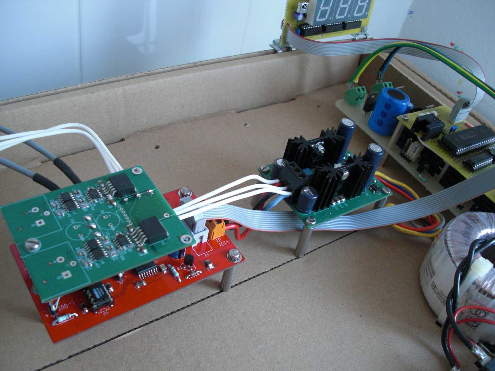

Hi guys,
I have been quite busy lately between destructive earthquake and nuclear disasters, but today I managed to find time to remove the balliste from the legato and try "The wire".
I still have this strange bias problem, removing the legato did not change anything. With only one channel connected I have no bias, with both I have 125mV on the output of the headphone amp.
Any more test or measurement that I can do ?

do the 2 channels of legato use separate supplies?

No, I have only one power supply for both channels. I also tried to power both "The wire" and the legato with the same power supply, but nothing changes.
Also with a load, nothing changes.

So, I managed to chase the DC bias problem, that is not a DC bias problem, but HF oscillation.
I started to suspect that when I saw that the position of my hands had effect on what I was measuring as a bias. Scope confirmed that.
10 nF at the input signal to ground had a huge effect, but I still have some.
What's the best way to avoid it ?
The output of the legato has coupling caps 100uF and bleeder 220K.
Thanks,
Davide

hf oscillation of legato, or 'the wire' ? if its the wire try lifting the BW pin (pin 1) on one of the output buffers. this will lower the bandwidth and hopefully get rid of the oscillations for you. try one channel first and then if its a success, the other. just lift it and leave it floating. otherwise you may try shielding the connecting wires, casing it up in a grounded metal case, or placing some filter capacitance in the input opamp inverting fb loop. i guess you live in a high rf area and this amp is VERY wide bandwidth and with no filter of any kind this keeps it very linear, at the risk of oscillation in areas with high interference
