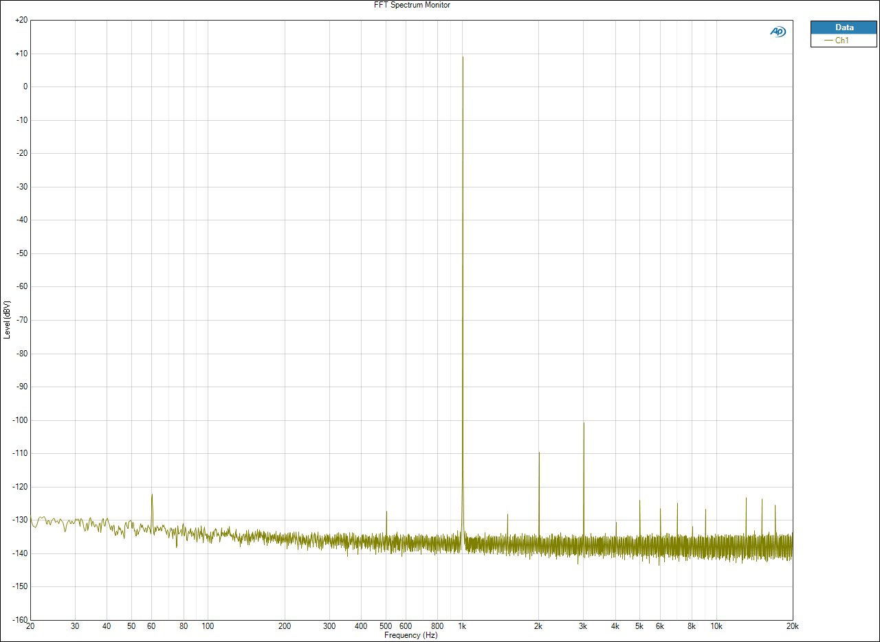

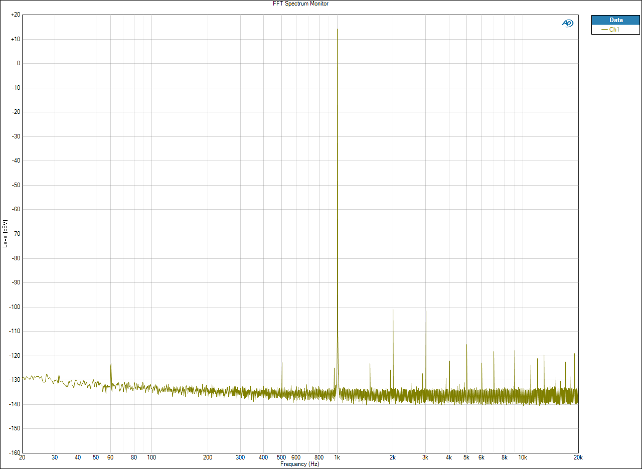

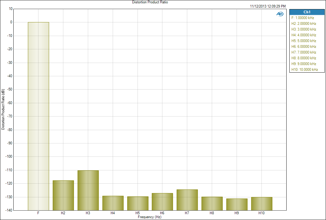

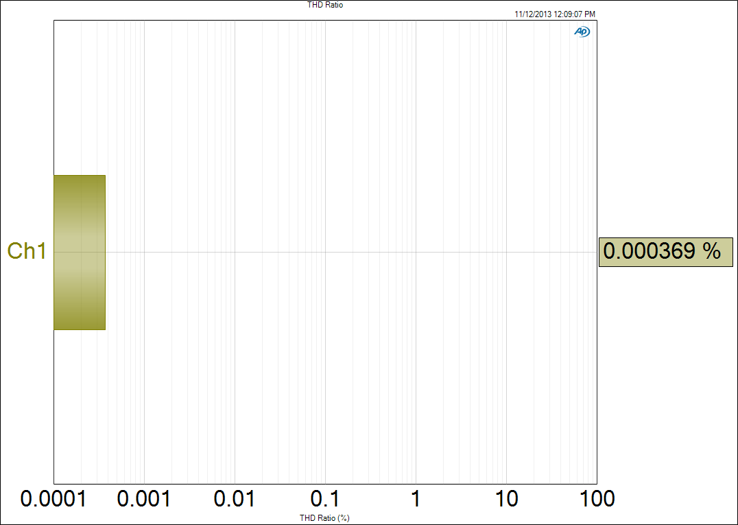

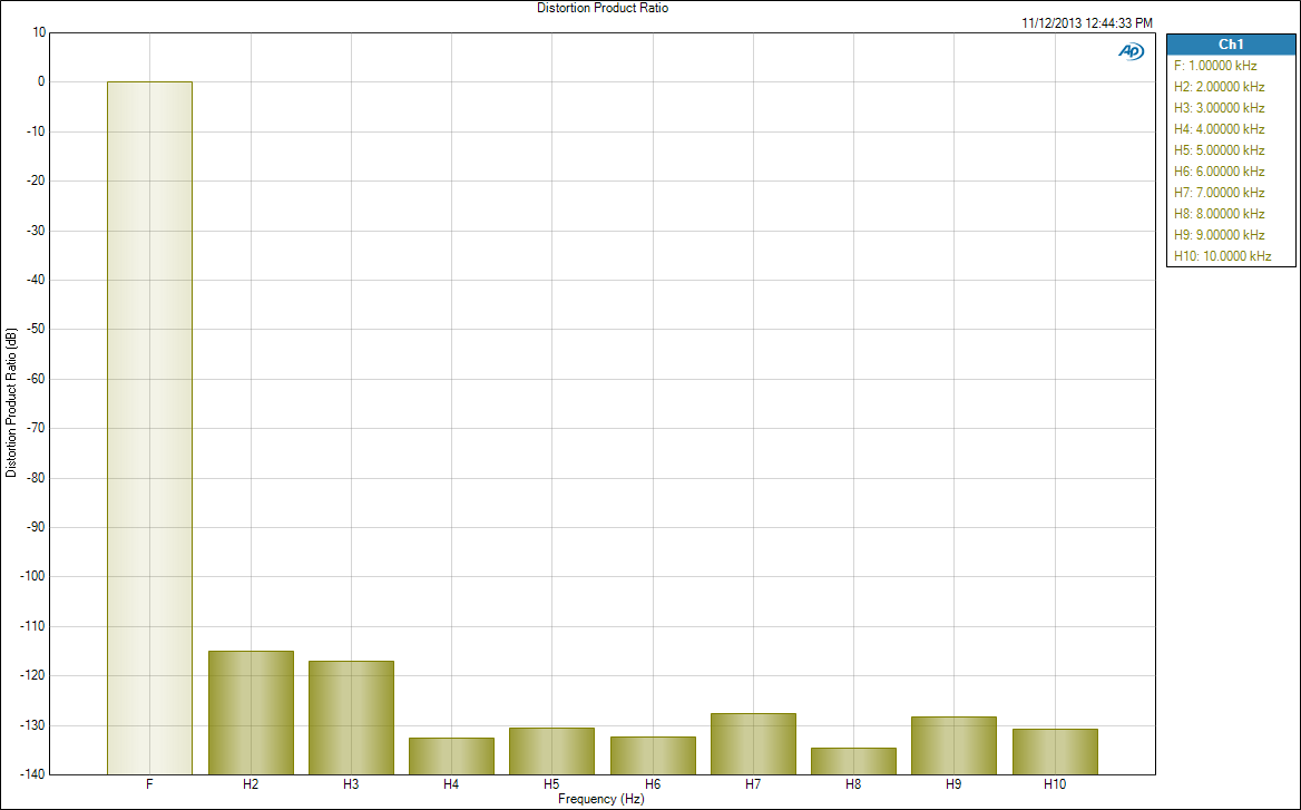

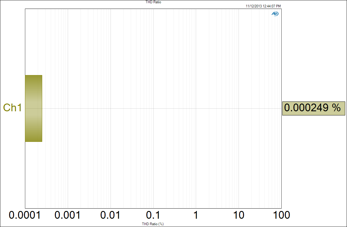

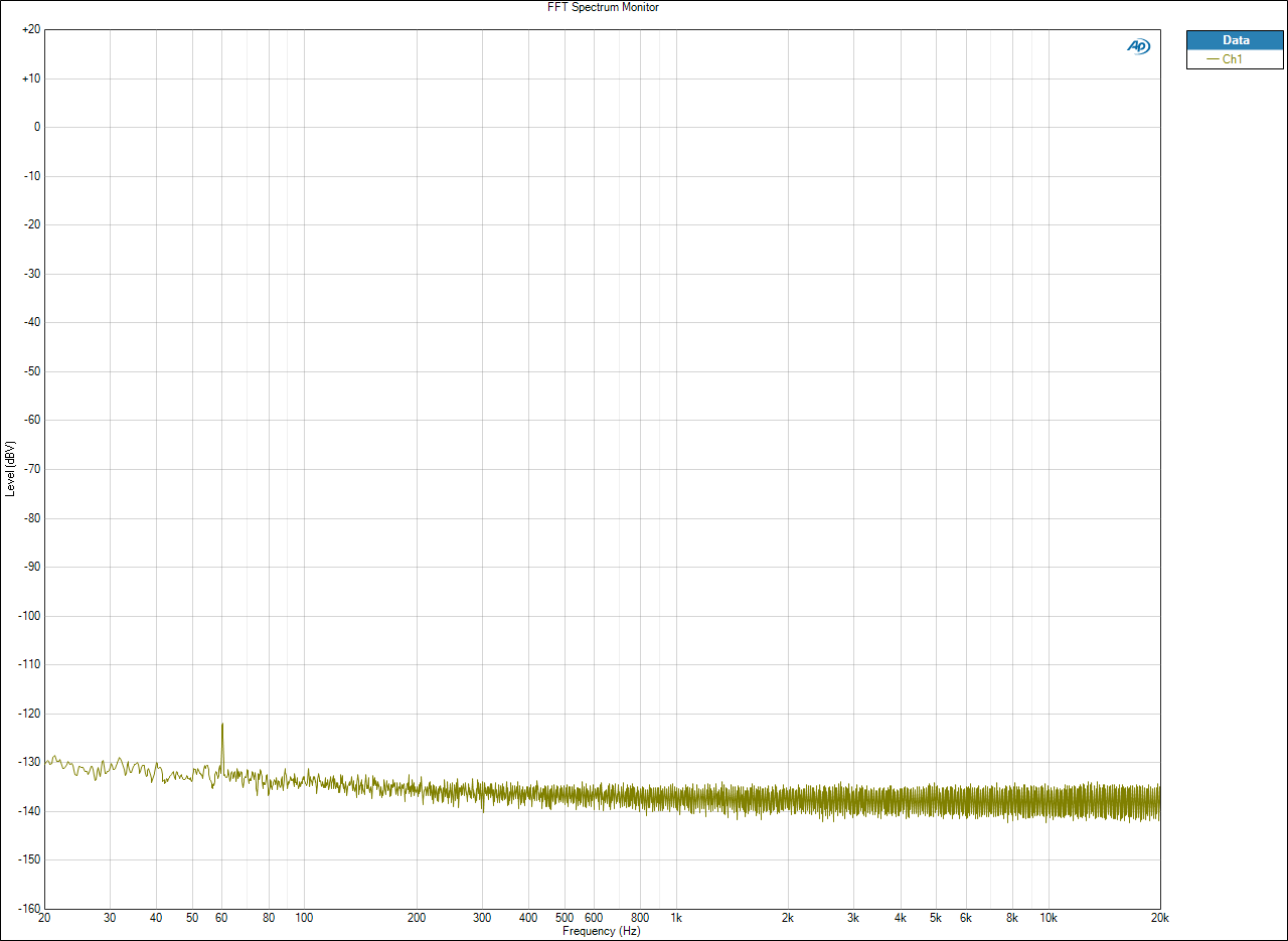

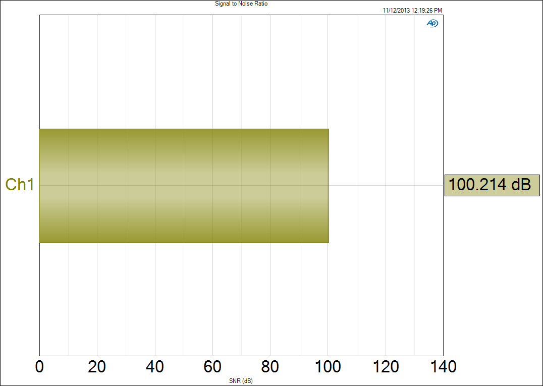

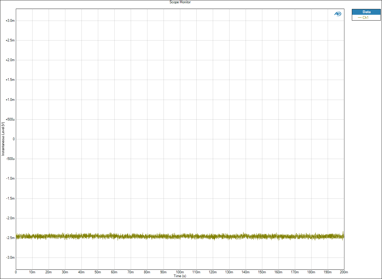

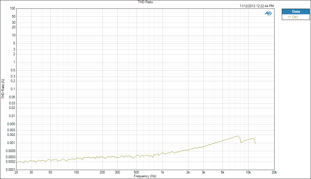

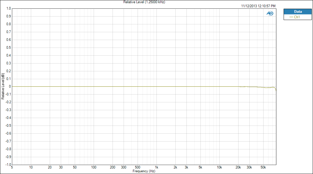

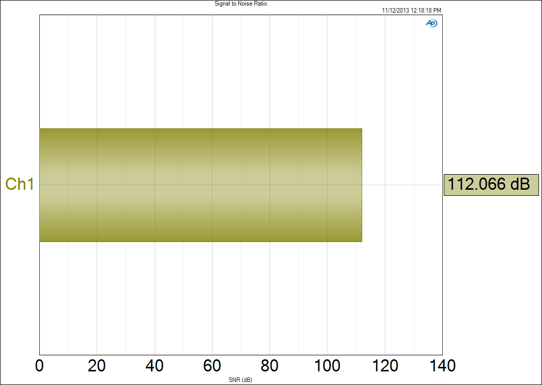

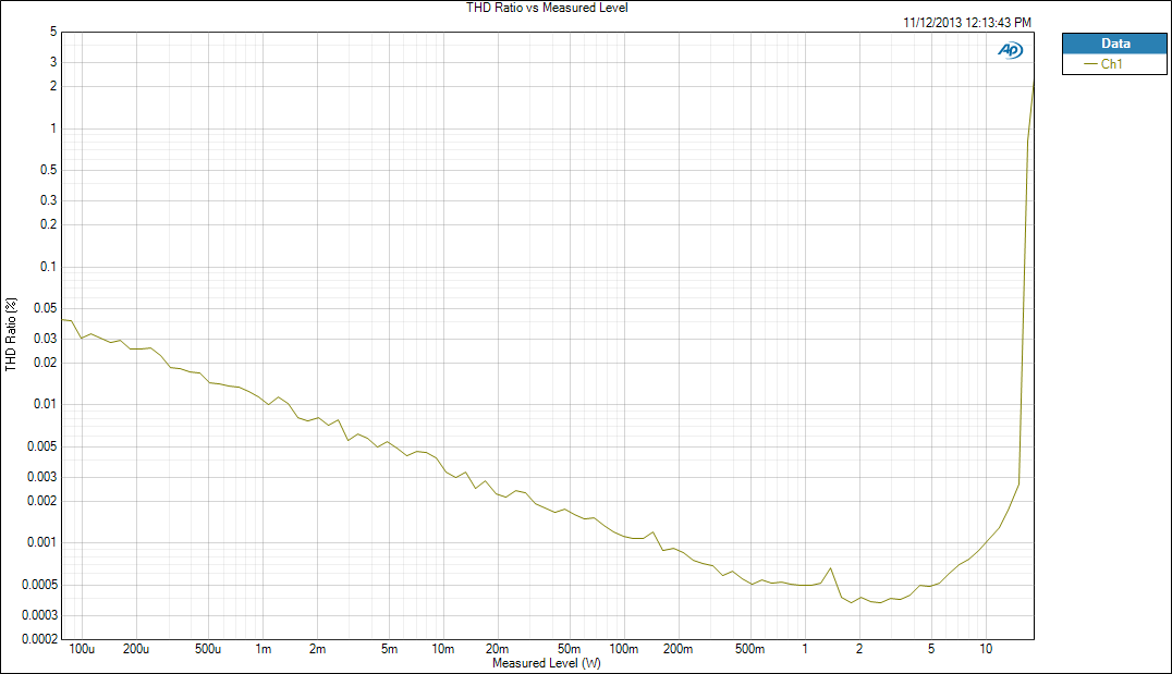

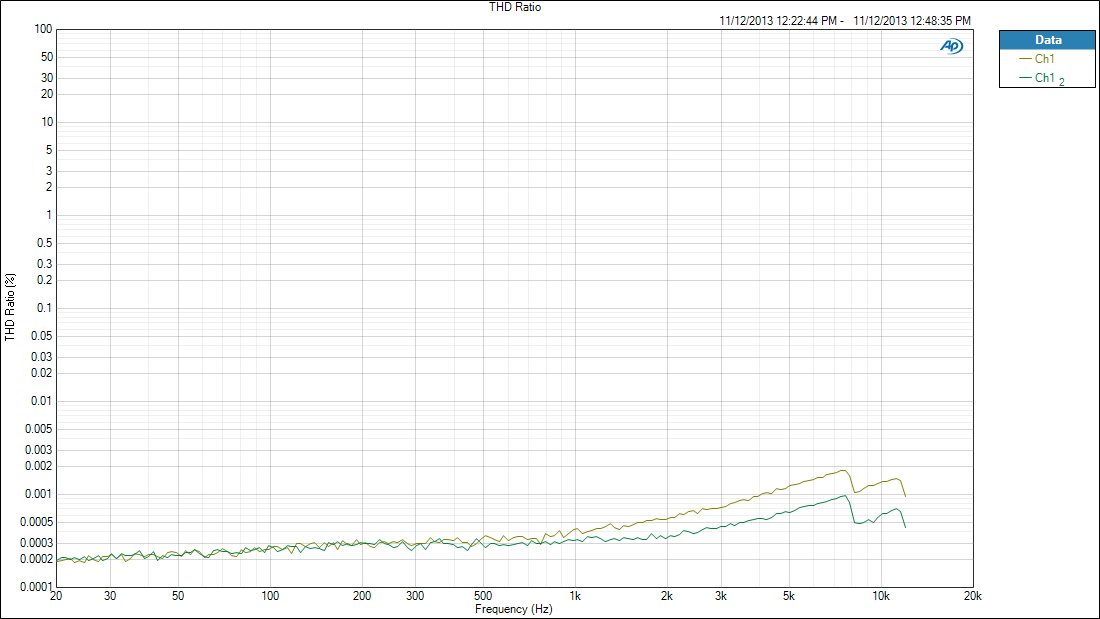

Lateral FET Amp
Hi Guys,
Attached are the measurements for the high power lateral FET amp.
These were all taken with dual regulated supplies feeding the amp. The PSU V2 was used at +/-24V to power the LME49830, and a LT1185 based supply fed the mosfets with +/-20V.
Power is obviously limited in this setup, but I was mostly just curious to see what the amp could do with lower noise supplies.
All measurements are done into an 8 ohm load, and the first set were done at 450mA bias.
I will also post a second set done at 900mA bias to show the improvement in distortion.
Owen
Hi Guys,
Owen

On the LME49830 amp ... I've had a quick glance at the DPS600 measurements (I've only got access to my dropbox on my phone though at the moment so small screen only) so these new regulated supplies are a small improvement on the DPS600 performance in noise floor and THD+N though in that case I think we're comparing 450mA to 600mA bias with the DPS600 tests so I'm allowing for that in the way I read these. One question, Owen, the distortion product ratios ... those values include noise, right?
I was actually expecting more of a difference in terms of noise with the full linear regs, but indeed they aren't much better than the DPS600. The real advantage to the LME49830 based amp is the much higher output potential, and the DPS600 lets you capitalize on that aspect while still keeping noise low.
Unless you really only need 50W or less, then the DPS would be my first choice for a supply.
As for the DPR measurements, my understanding is that they do not include noise with the exception of that which falls into the bands where the AP is looking for harmonics. Usually anything below 130dB is just noise that happens to be correlated with that harmonic at the instant the capture is made. The DPR measurements do not use averaging, so those upper harmonics are bouncing all over the place in real time, and their position is random when I save the graph. I could save three graphs in a row and the 2nd and 3rd harmonics wouldn't budge, but anything higher would be all over the place, varying randomly by 6-10dB.
If higher harmonics are present, then it easily points them out (eg, they are stable and repeatable) but in these cases, the upper harmonics are so close to the noise floor that they are basically one in the same unless you start averaging and finding some correlation. For that you can look at the FFT with the 1kHz tone.
Owen
