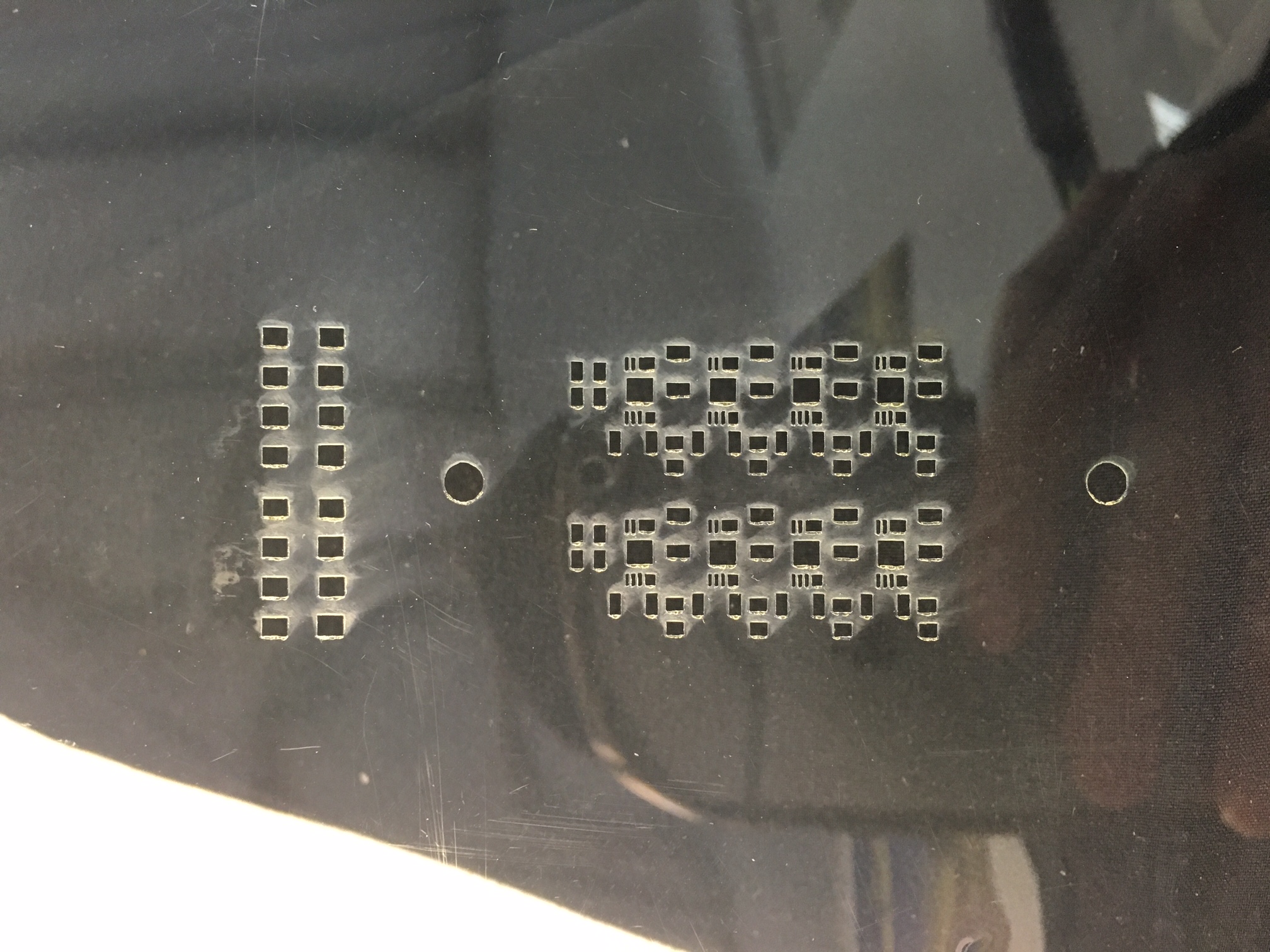

My first attempt with a stencil. The laser wasn't as clean as I thought it'd be, but looks like it will do just fine. I'll try to made a video of the oven reflow process. Will be on my el' cheapo aoyue 866 rework station. Between the hotplate and hotair on top, should be straight forward.
Anyone have any tips for me before my first attempt? i've never used the reflow oven/hotplate part of this rework station. Should be interesting to see how well it works. The soldering iron on this thing is "meh" compared to my Hakko FX-951. But I'm not about to shell out money for a Hakko air station, or weller. Maybe if I find one used somewhere.

I bet the stencil will work ok... looks sufficient to me!

I make all of my boards now using laser-cut stainless steel stencils and low melting point paste from Chip Quick. I bake my boards, as opposed to the hot air, but the end result is the same with perhaps a little less thermal stress on the parts with the baking method (controlled ramp-up and cool down). I order the stencils when I order the boards. They are usually around $75. I got into the habit while building the HPUHP and MPUHP amps both of which take a full day (8 hours) of soldering without a stencil, or about an hour with a stencil! Now, there's no going back...
Your stencil clearly worked well, but in the future I should be able to provide you a proper gerber for the paste layer which should save you some time in the translation.
Here are a few tips for the solder past application:
1. I always use the paste right out of the fridge (cold), and a flexible stainless scraper (from lee valley tools) to spread it. The cold paste is much firmer, and holds the shape of the stecil better, which prevents the pooling effect you can see in some of your pictures.
2. Clean everything with IPA before applying the paste, and then between each board with the same stencil.
3. Work quickly when applying the parts. The less time the paste spends drying out at room temp, the better. Be organized, have all parts on hand, and don't spend forever messing with part alignment. Everything gets pulled into place within reason.
4. Bake the boards in the center of a convection toaster over (one that is dedicated to PCB building... don't use the family toaster!). Monitor board surface temp with a thermocouple if possible. If not, just eyeball it.
5. Don't take too long to get the boards up to melting point while baking, or you risk drying up the flux before you hit the melting point of the solder. A small "soak time" is good, but don't overdo it.
For the rest of it, you should be all set. Its worth taking the time to probe around to check for shorts before power up, but I didn't see any in the video you posted.
