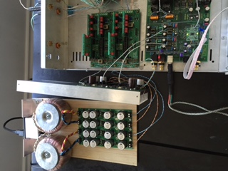

Just because I'm so damn inpatient I put some Silmic II 100uF 35V and hooked it up to a couple 26.5vac. With 32vdc on the rails I can only trim to 1.48v. So thats the bad news, as for the good news the thing seems to make music. Oh the glorious music, with only 4 hours of burning around 55*C, it makes wood instruments sound correct and even hits the metal notes too. I can't believe the improvement over the 4 lme49990 I was using prior. Now don't get me wrong the Opamps didn't make anything bad but the NTD1 is no doubt an improvement.
Thank you OPC this is a great addition to my collection.😀
Now its time to place an order with Antek....

Hi Dan,
Congrats on the build!
Double check the polarity of the voltage at the source of the FET (The input to the NTD1) as it needs to be +1.65 relative to GND. It's easy to get the polarity wrong and adjust this to be -1.65 which then triggers the body diodes inside the DAC and limits it to ~-1.4V and doesn't allow for further adjustment.
I have done this myself before and was baffled as to why it wouldn't adjust any further. A quick look at the leads on my DMM reveled that they were reversed and I was holding the red lead on GND and the black lead on the source.
This won't damage anything, but it does result in higher distortion and worse performance.
