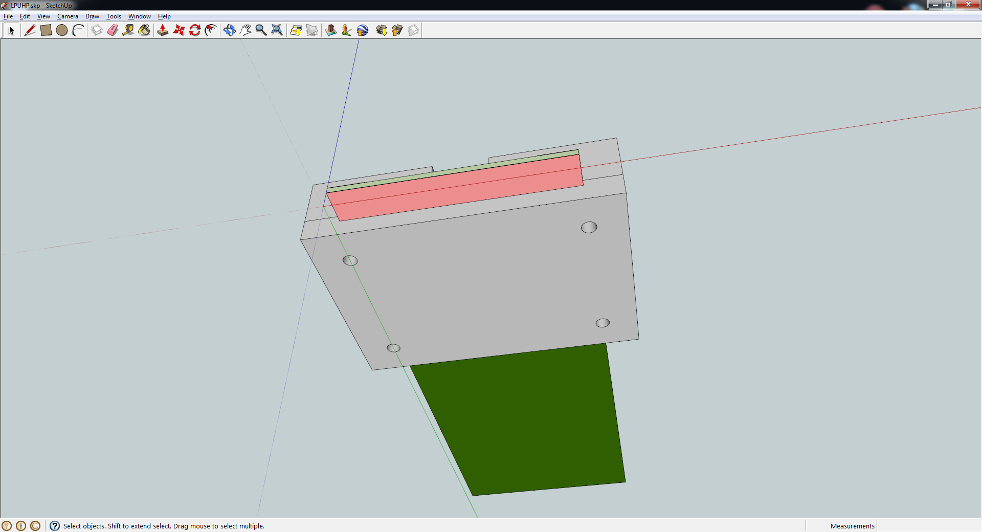

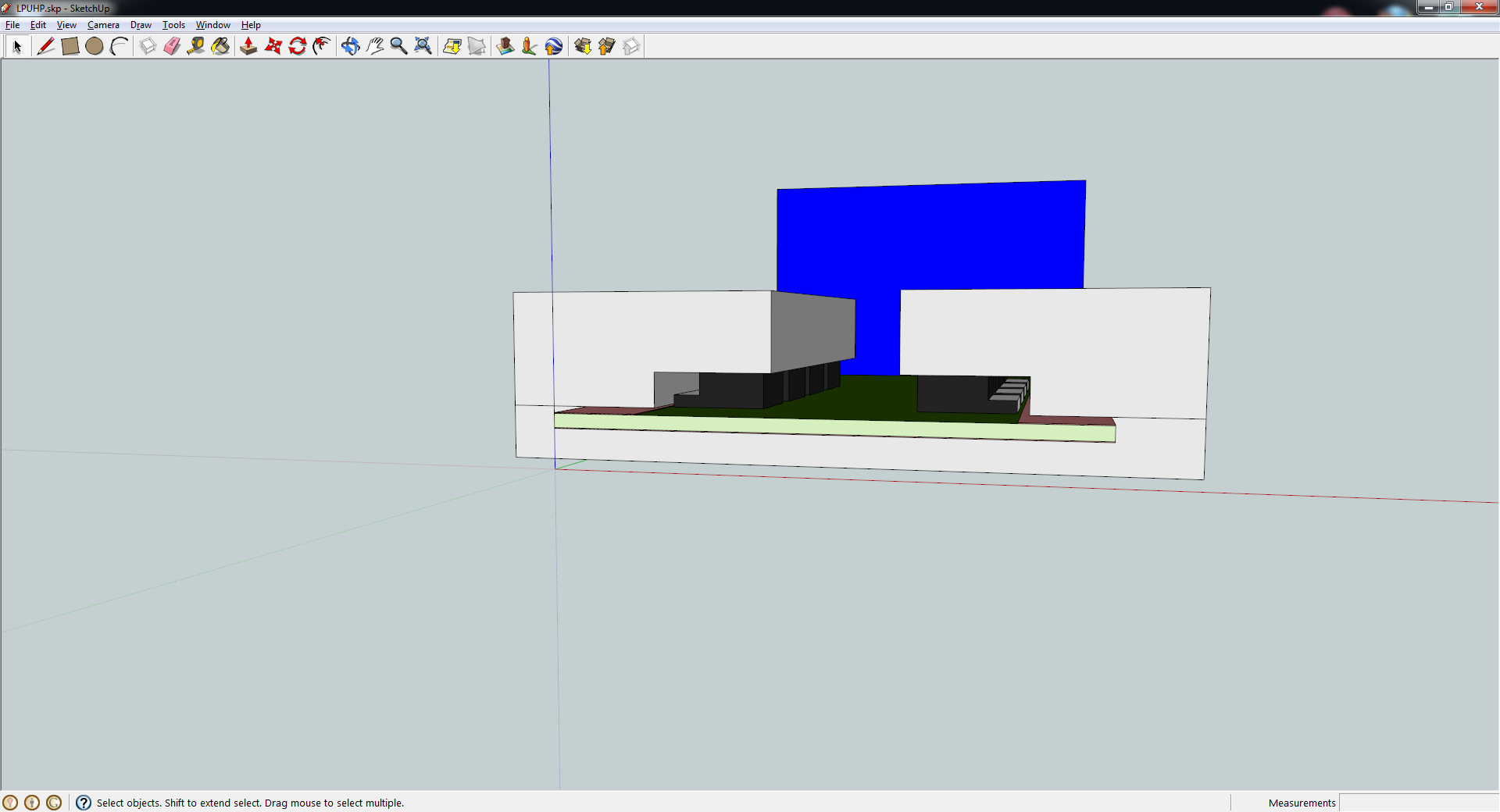

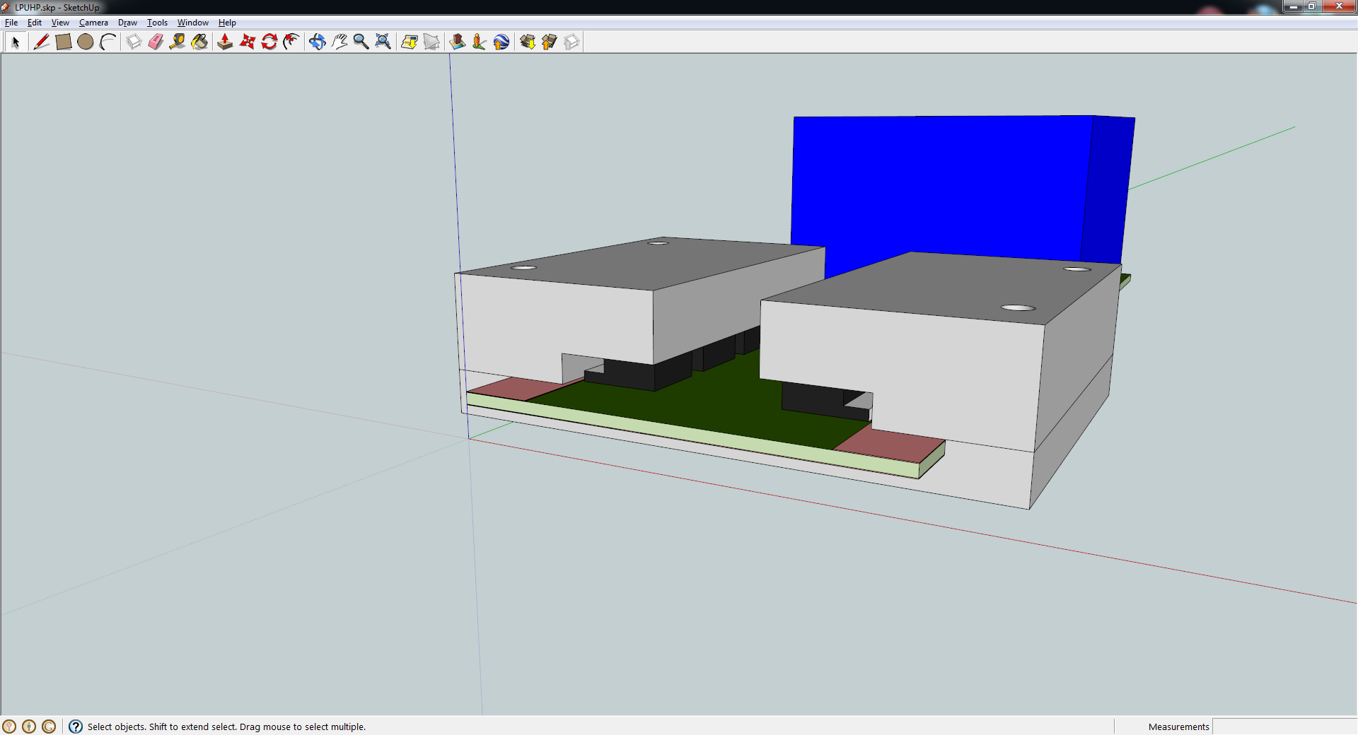

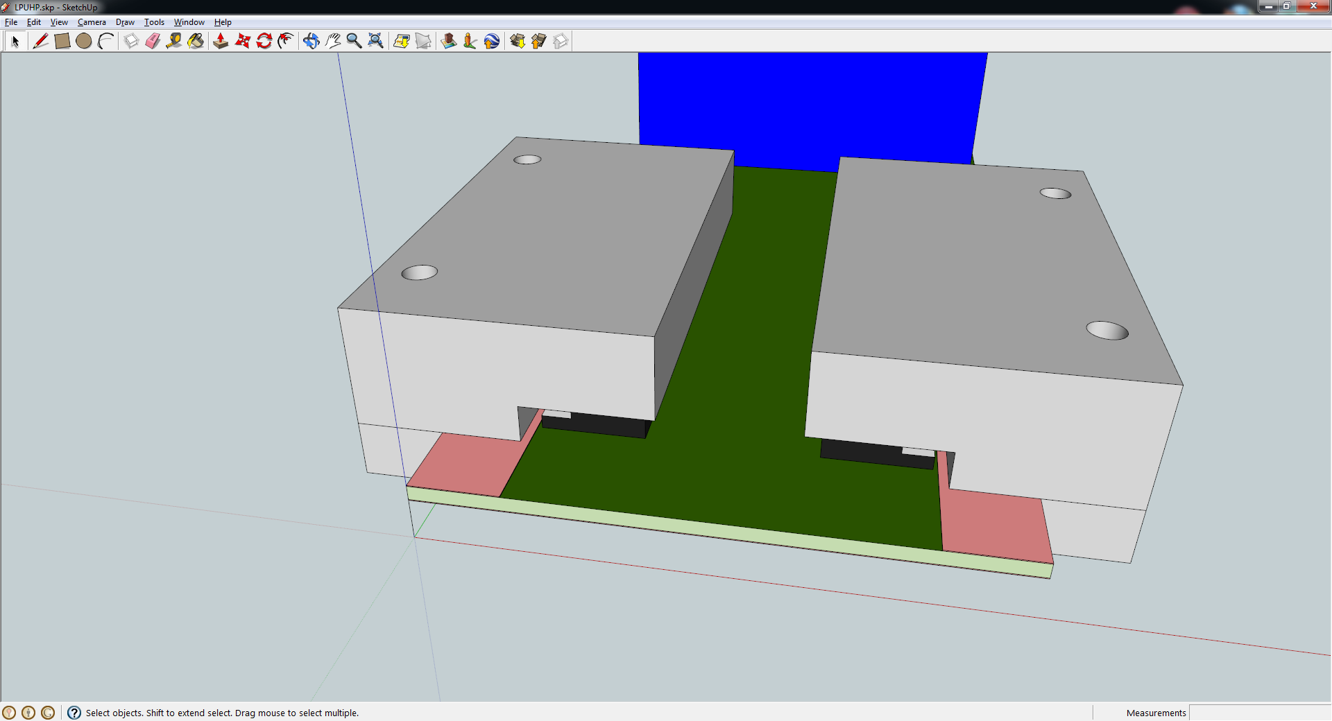

In the meantime, I drew up a possible suggestion for a chassis mount heatsink that would be very effective at removing heat, but does look a little plain (sorry qusp!)
I would propose a base plate with two clamshell style clamps that bolt down from the top. This assembly could be bolted onto the board using a single thin piece of insulator across the bottom and folded up around the side onto the top. It would be very reasy to machine, and would be effective at pulling heat off both the PCB and the top of the parts.
The bottom plate could be made any standard thickness, and normal standoffs could be used to support the rear. The bottom plate could be threaded and allow it to be bolted to the bottom of any flat aluminum chassis.
This could allow a variety of different extruded chassis to be used including something like this:
Box Enclosures - New Page
You would simply need to drill six clearance holes in the bottom, toss the amp in, and screw it in place from the outside bottom.
