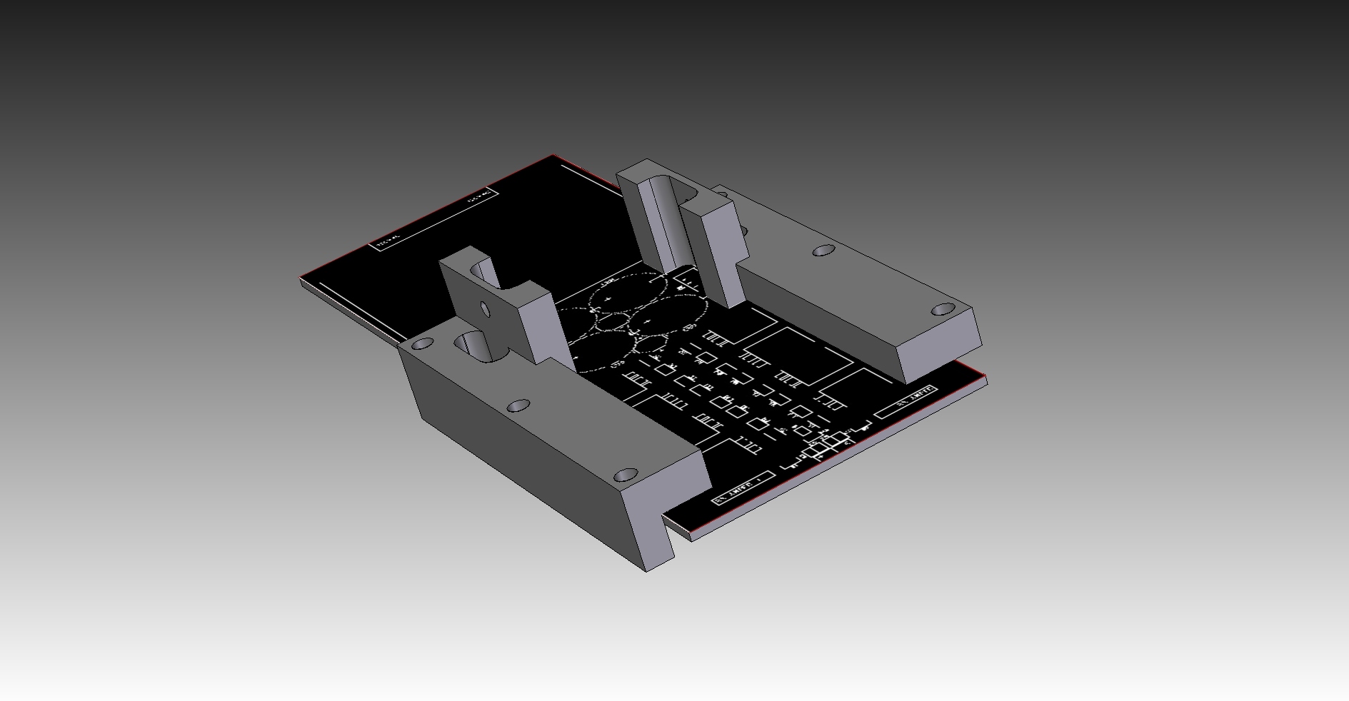

Here is a quick model of a part that would enable the chassis to work as the heatsink.
Could be made to cover the top of the buffers as well.
Would be attached to the PCB from underneath using the buffer heatsink screw holes. Not sure what would be required with regard to electrical insulation.
It could be simplified if the variable resistors were placed underneath the board, but it's no problem either way.

Looking good mate!! I see no problem with the pots installed on te bottom personally, as it should pretty much be set before you stuff the amp section anyway using a dummy load and then since you could safely run without heatsinks for setup, then just stuff the remainder of the board. we could build, set then install in the chassis when all is confirmed kosher.
Looking good mate!!
Looks great!!
Pots per standard bom are 9.8mm high + 1.3mm for adjusting screw so we won't be using 10mm spacer if mounting them underneath. Alternatively there is a T93XA variant of the same pot that has a side mounted adjustment screw. That is 9.8mm high so would still be a pretty damn tight fit with a 10mm spacer.
Simplest option might be to move board to 15mm above floor of enclosure.
I might be a little slow; could you help me understand where the contact is between those aluminum pieces and the chassis?Here is a quick model of a part that would enable the chassis to work as the heatsink.

454Casull: the chassis would be machined in a way that would allow the aluminium bars to bolt on using the 3 holes either side of the board.
I could extend the bars downwards further so they could be bolted to any chassis though. Attached pic to show what I mean:

You run into the same problem that you did elsewhere; if the distance between the chassis and the top of the board isn't exactly how you design it (tolerance-wise, too), you'll either end up with a loose clamp or a gap between the aluminum bridges and the chassis. If you design something so that the clamp is separate from the heat bridge, it should be much easier to guarantee tight contact on both interfaces.Thanks guys.
