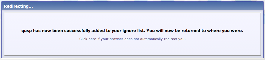

you are hilarious, welcome to ignore. I have resisted doing that for a while as occasionally you have something interesting to offer, but now you have tipped the scales so that my frustration far outweighs that and these arguments all center on this needless and thankless complication you seem to love.
I have better things to do with my time; one of which includes building this amp..as is
