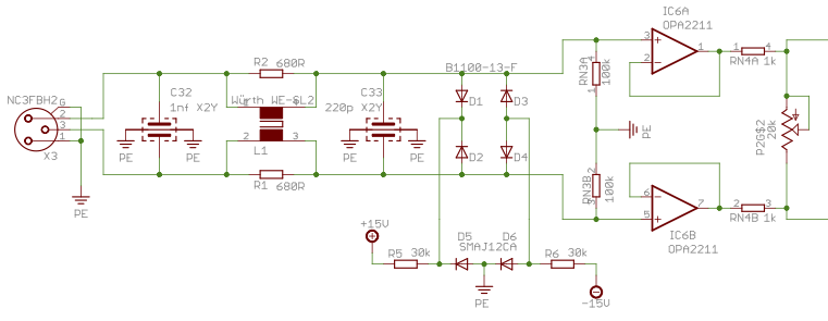

Considering a DAC like a BII/BIII as the single (i.e. only) source of analog signals, isn't having a relay-type attenuator with predefined input levels the functional equivalent of telling your controller to switch both channels and volume in the digital domain simultaneously?
functionally yes, but adding 7 components in each phase, including 2 integrated circuits (at least one of which has THD numbers worse than the dac) and a transformer, with what is likely not a small amount of feedback, where nothing at all is needed; is hardly the same thing.
When you say integrated circuits, are you referring to the IC's that control the relays? In a relay attenuator, the specs of any ICs in the attenuator control circuit shouldn't matter since they're not in the signal path. 😕

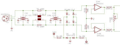

Are you referring to my post? Just to clarify, what you were looking at in my schematic is an RFI filter. No reason to bash...
The schematic served the purpose of making clear that priorities and use cases can vary with each of us. It has nothing to do with my other point about volume control. Buffer and pot could of course be replaced with something else, like a relais ladder or a rotary switch.
I just wanted to make it a point that THE WIRE can also be built by not going with the flow, as being minimalist for the sake of being minimalist can be wrong, likewise. Say, for example, you use the amp for serious things, like, working with people in something that could be called professional audio. You have this amazing, minimalistic gear that looks and sounds all fancy, wired to some other gear (that you might not have control of). And then someone puts their cell phone into close proximity. Booom bzzr bzzr bzzr, credibility lost.
[...] adding extra components can only degrade performance and in your circuit, linearity, noise and expense are all increased for no reason.
Wrong statement, and subjectivist on top. I can easily prove that an EMI filter improves performance (with regard to EMI). Can you prove your statement that it degrades performance (with regard to sound quality)? But I'm not here to argue. 😉
You see, leaving out components can degrade performance, too. As long as there's an improvement, the added complexity is justified. You can't interface THE WIRE to absolutely anything, anywhere you go. But the EMI filter you see in above schematic (common mode choke, X2Y caps, ESD protection using TVS diodes) is such a tiny SMD circuit that it can be bypassed with a simple jumper on the PCB in case it is not required...

sek, you are the one talking about magic devices. higher THD (the PGA) improves THD now? the filter is perfect and thus only effects the higher frequencies? the inductor is linear? this is a rhetorical post, because neither can possibly be true. lets get back on topic, you can argue with reason by PM if you must
qusp, are you referring to my post again? 😉
How do you come up with PGAs when looking at my schematic and reading my text? 😀
I never considered you the kind of DIYer calling RFI filters magic devices. Or cell phones. There are scenarios where you better have your equipment ruggedized, depending on what you want to do. Just saying...
