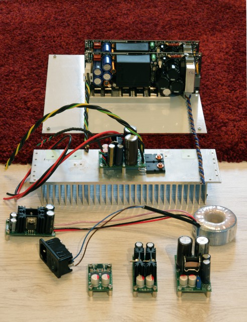

Stuff arrived in the post, things got put together, a few wires were trimmed and some soldering happened. A few small things left to buy, but I'm getting there...
In the pic:
2 x DPS600 45/55
2 x The Wire Amp [one just about ready for testing]
2 x The Wire psu [one hooked up is at +/-20Vdc]
1 x The Wire SE-SE HPA
Paul.

woW! i see the first pic.
Good heatsink..is a part of case or you bought separately?
You have already taken the first test? (bias and offset on resistive load).
I'm glad that you have assembled following my advice for dps-600 🙂

Not tested yet, need correct fuses & resistors first.
Heat sink was taken from a Yamaha DSP-E800 amp, the final heatsinks will be bigger...
Is a good layout for the dps-600's, with 10mm gap between units & under the base 🙂

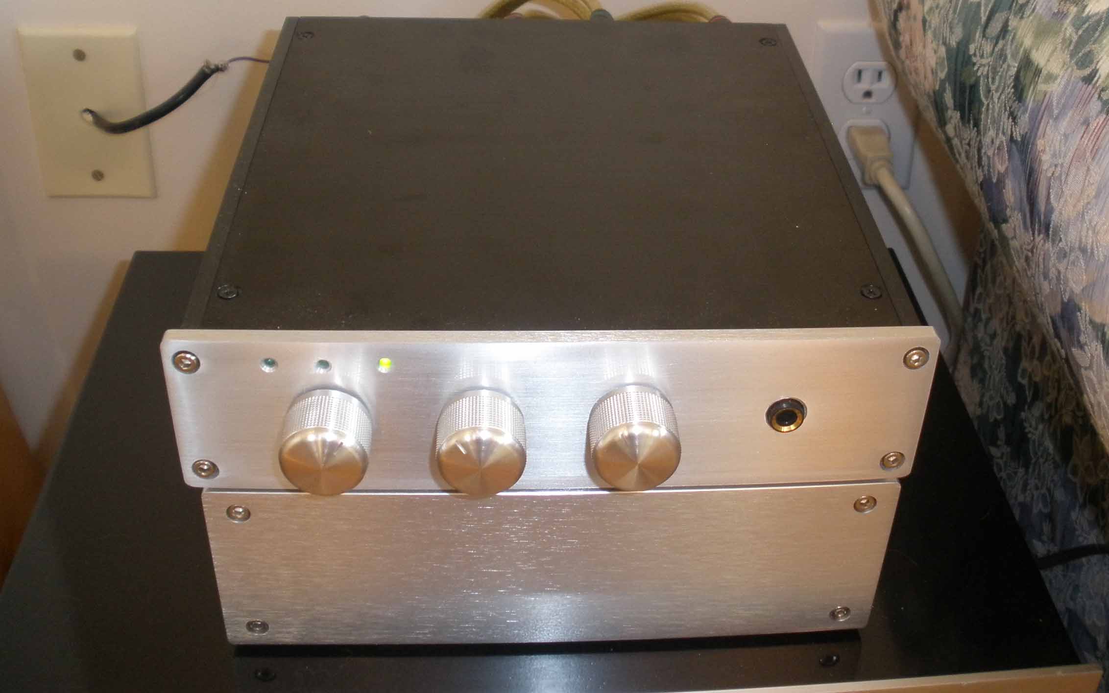

BuildMeSomething,
you showed me yours so I will show you mine.
The preamp is OPC's other balenced to single headphone amp. I left out a few parts and made it Se to Se and changed the gain to 3. I used a stepped volume and balance control. The box just underneath is the powersupply, a all fet reguladed supply from ebay.

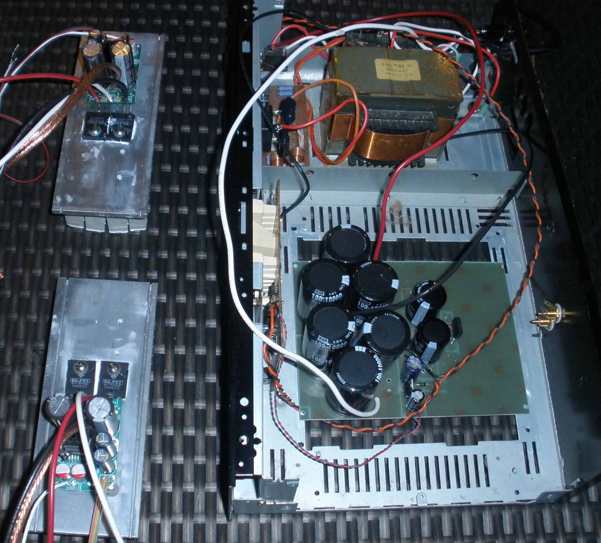

Just under the power supply is a FM tuner I rescued from the side of the road. A lot of sanding and cleaning and a new paint job. Runs well sounds fine.

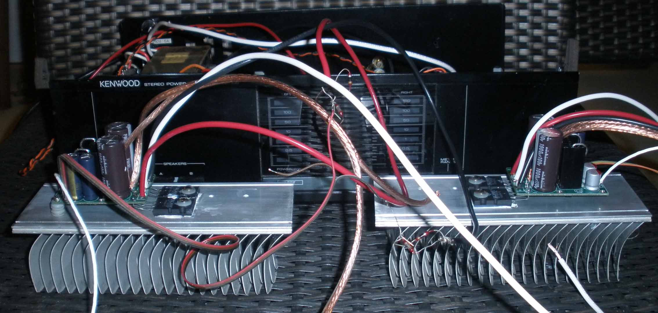

The chasis I will be using is a Kenwood KM106 that I got from ebay. One channel was defective so I bought it for $25. Rails are +/-68 volts. The amp was rated at 130 watts/channel and has a led/VU display. New power supply is ready to go. I don't know if I will add a higher supply for the LME chip. I will listen to it and decide later. Both boards have been tested with a bench power supply and initial bias was set to 200ma. The heatsinks are a bit on the small side. The heatsinks are the original from the amp. I have another working Km106 and have run it very hard and it does not get too warm. I will wait and see how warm the amp gets with the LME boards before I turn up the bias any higher.
Boards were tested on junk speaker so I can't tell how they sound.
