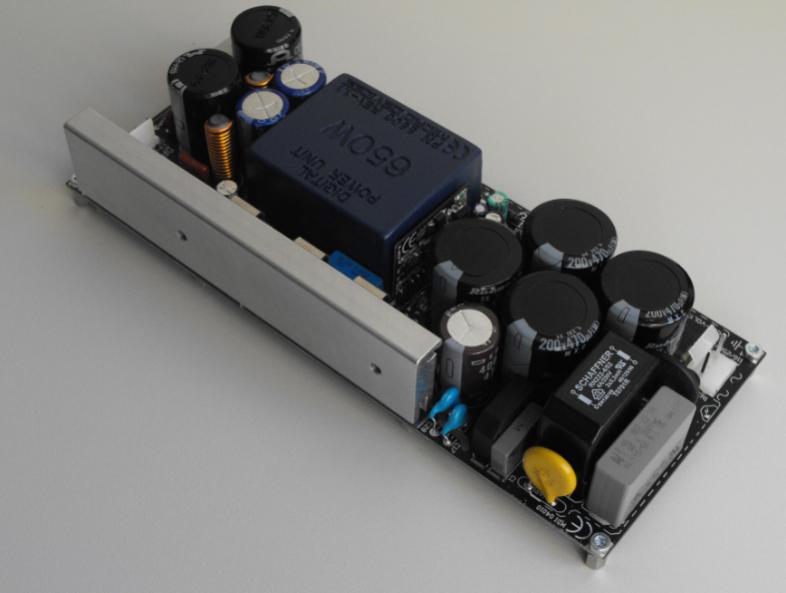

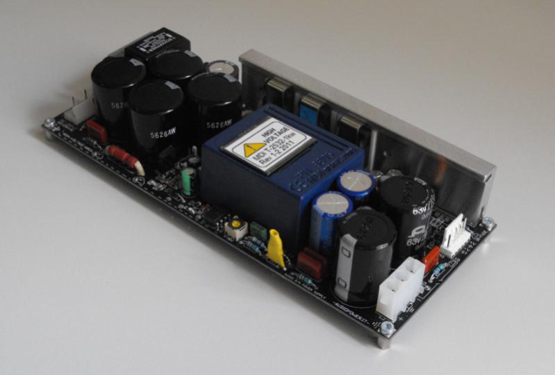

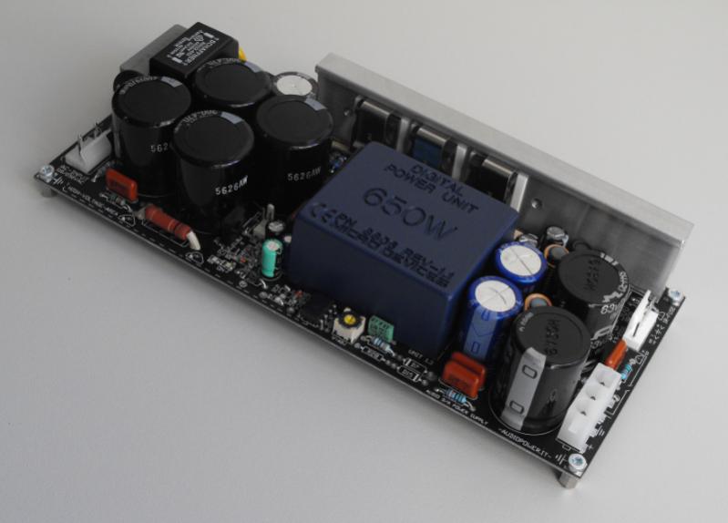

I have some new info.
Since the DPS-500 has a power unit very expensive, I thought that it is possible to mount the same power unit of the DPS-600 (do not need to make changes), so the difference is in the use 115VAC/230VAC with a small increase power, thanks to the cell filtering slightly larger.
This allows me to offer the DPS-500-WA with only +15 € difference.
Obvious that the original version is available (such as those that I'm sending to Owen for the test and measurement).
That's all for now.
I know well that the monetary crisis has spread out from Europe, so is not easy, spending money on unimportant things.
but if someone needs a good power supply for audio,with new performances on audio transient, this is the right one
Regards
Roberto

Original version "S" for WA.
This version can supply up to two amps (if AB class) up to 2x300W rms or
2x500w in case of D Class.
however, can provide repetitive peak power (33/66ms) of 1kw without fan.
sag voltage is around 2.7-3V, also (this power supply have two feedback) to get a very fast reset time. (load on one rail, not unbalanced the other side).
right for clarity. than the version not "S", changes the transformer and all components within the Power-Unit. the electronic circuit is identical
regards
