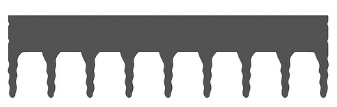

Maybe a small sidetrack for some but i thought this could be interesting to know for those still in search for chassis.
My 3U 400 mm depth pessante dissipante (modushop.biz) chassis has arrived and i'm positively surprised about the size and design of the heatsinks. The heatsinks included with the chassis have wavy fins like the picture shown. I haven't unwrapped it completely yet since i lack the space so it will stay in the package for now, but it weighs 10.5 kg in total so a fair amount of aluminum...
I ordered a separate 300x120x40 mm sink as well with straight fins otherwise they look the same. Here are the measurements of it:
The base slab is 7 mm thick, the fins are 3 mm at the bottom and 2 mm at the top, 10 mm spacing between the fins and it weighs in at 1.5 kg. To my surprise this is about the same as the conrad sinks qusp looked at. So i'm very pleased for the price so far, just hope everything fits together...

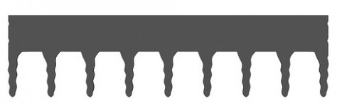

if thats the profile of the sinks it came with, its not all that similar to the conrad and wouldnt seem to match your measurements either, that profile linked is mostly base with very little fin, while the conrad is 48mm total, with 40mm of that being fin. I would use your other one, I have heard the ones those come with arent really rated too well but they may have changed. what is the c/w capacity?
