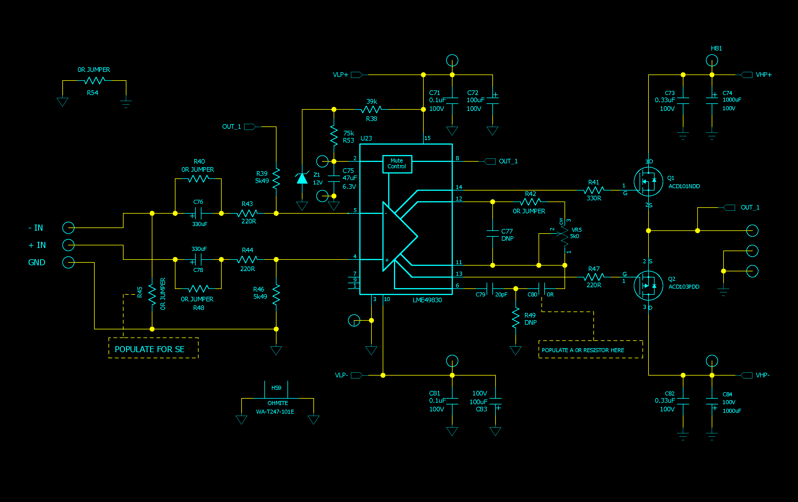

Post1 sch shows the Drains connected to the output.
Have the D & S labels been swapped?
Here is a resized copy of the final circuit (I don't remember what post it was on). It shows the sources connected to the outputs, as they should be.
The mistake in post 1 was picked up in Post #53 by Anthony Holton and corrected shortly after.
The schematic I'm using is the one posted with the build guide which is in this post by opc. I would have thought anyone building this amp would have been searching out the build guide and found the schematic at the same time... perhaps if opc is updating the first post he could put both of these there. I believe there was also an updated worksheet.
Perheps OPC can edit the first post with a link to the build guide and definitive schema.
Gr GJ
Opc can add an index to the first post.
That index can include a list of post links to relevant updates and/or revised schematics and/or build information.
With the help of the Moderators, the whole post could be replaced with all it's pics and other attachments.

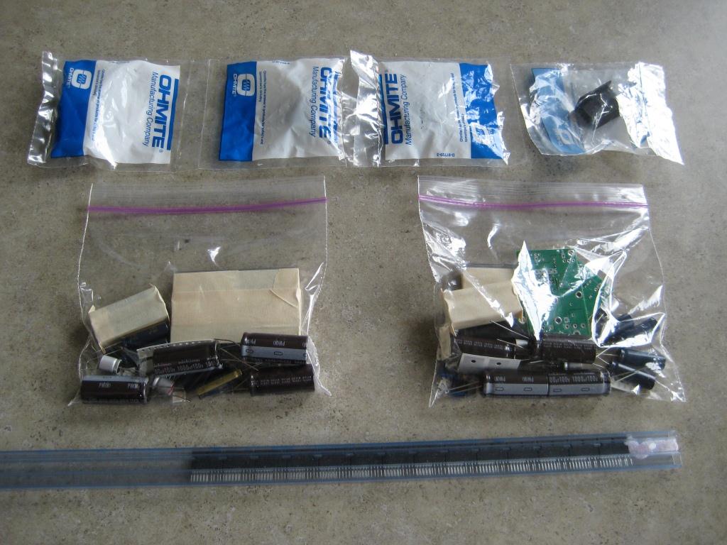

Hi Guys,
I updated the very first post with a link to the correct schematic and assembly guide. I cannot update the attachments, but as mentioned above if a moderator wants to give me update permissions for them, then I can update the attachments with the correct ones.
Along the same lines, I've finally packed up the last of the mosfet only orders and have a real official "final offerings" list which are all the items I have left that I'm not keeping for myself:
2 complete stereo pairs of The Wire power amp kits - include PCB and all parts.
$160 per pair, sold in pairs, or all four together only. No singles.
12 x LME49830 Driver IC's for The Wire power amp.
$6 each
If anyone is interested in the above kits or parts, simply post up here and it'll be first come first serve.
Owen
