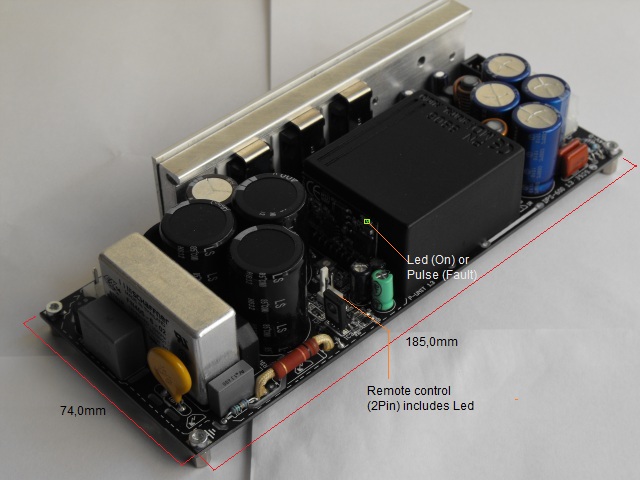

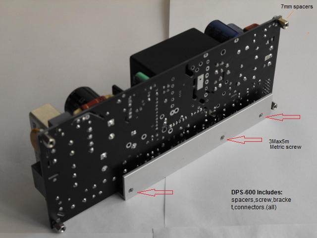

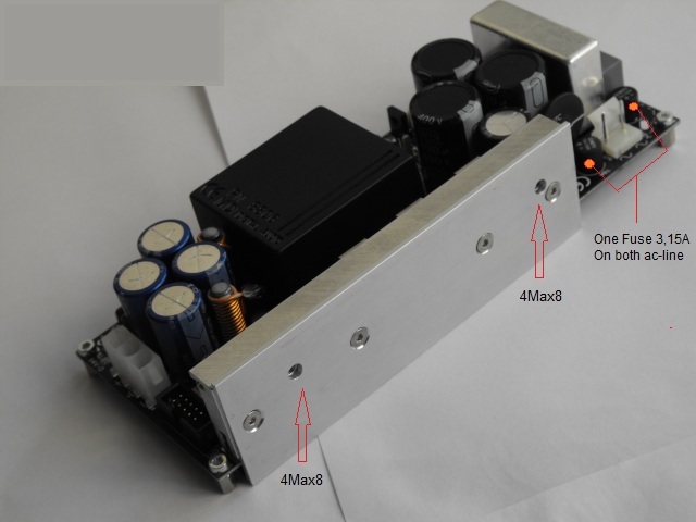

Think all know, just put on thread a standard version of DPS-600 suitable for this good Wire Amp.
Is better I finish datasheet instead put some features.
Just Important ..this model not work at 110Vac.
Some note on pic, as dimension, screw etc.
regards
