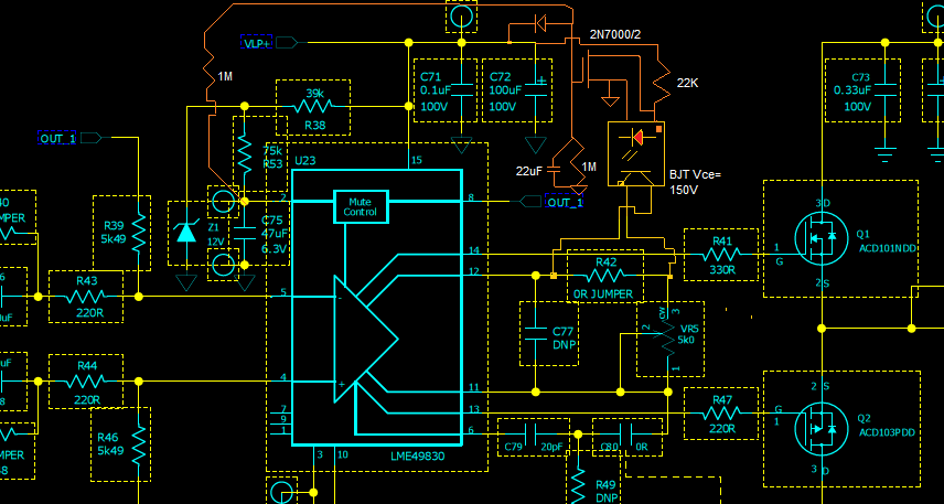

would it be better to have it so that 2 identical resistors were used, one in circuit all the time and another switched in in parallel? I presume lower resistance = higher current? this way there is never a time, no matter how short where there is an open circuit this way it could easily be 300 and 600ma, or calculate 200 and 600 easily enough
This is the way the Summer/Winter setting of one of the Krell Klones was done.

Regarding the bias adjust, to add a switch resistor in parallel sounds like a better idea. The relay can either connect or disconnect the second resistor. But wouldn't a digitally adjustable resistor cause less risk for transients during the change? Sure this increases complexity a lot.
But if the microcontroller is used it can also be made to handle mute on startup and shutdown by making something to detect the mains connection.

Other possible way (simple) without relay.
for bias switch.
Also in this scheme, you can add a photo diode (in series at the drain) to control the external bias.
this detect only on "time" when ready.
Obvius that can use comparator for detect voltage rail but i know that pcb is already printed,then think a simple external modify.

4. For the bias adjust, I should have been a little more clear. You definitely want the relay to put another resistor in parallel with the existing one to change bias levels. You do not want to change between two different resistors as the amp could behave very poorly if you do this. You can also add a capacitor across the main resistor to slow the change in the bias setpoint.
