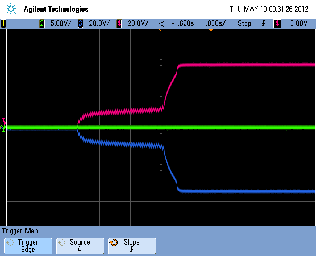

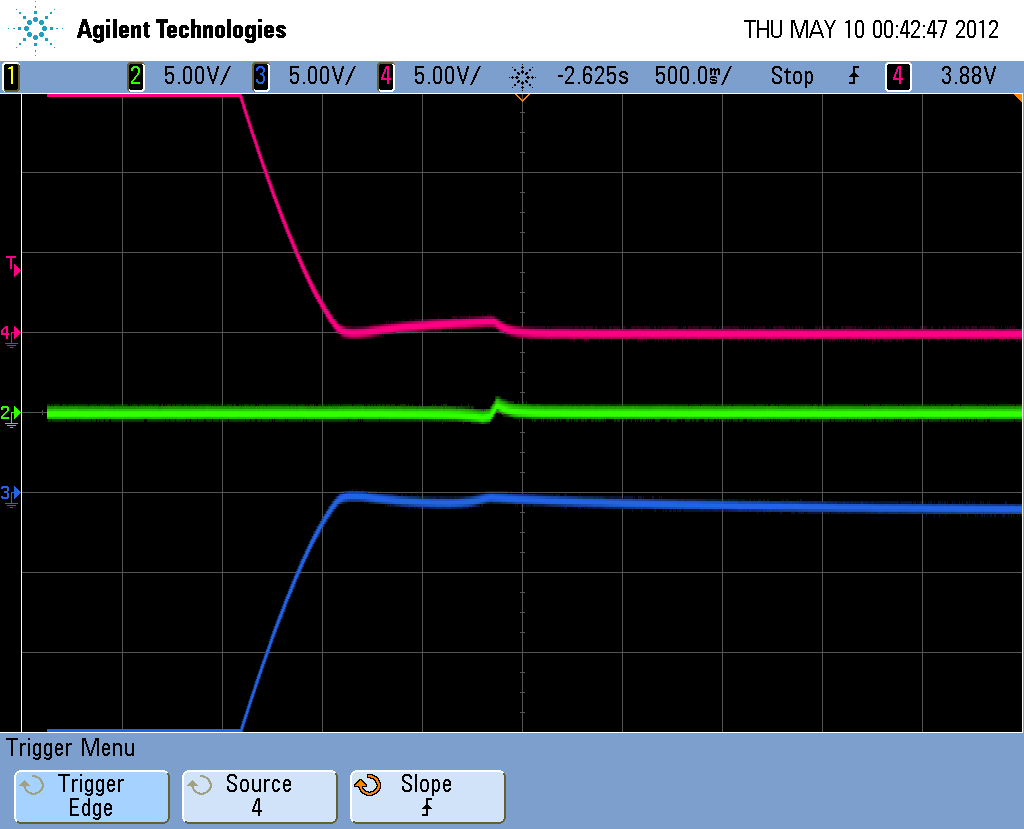

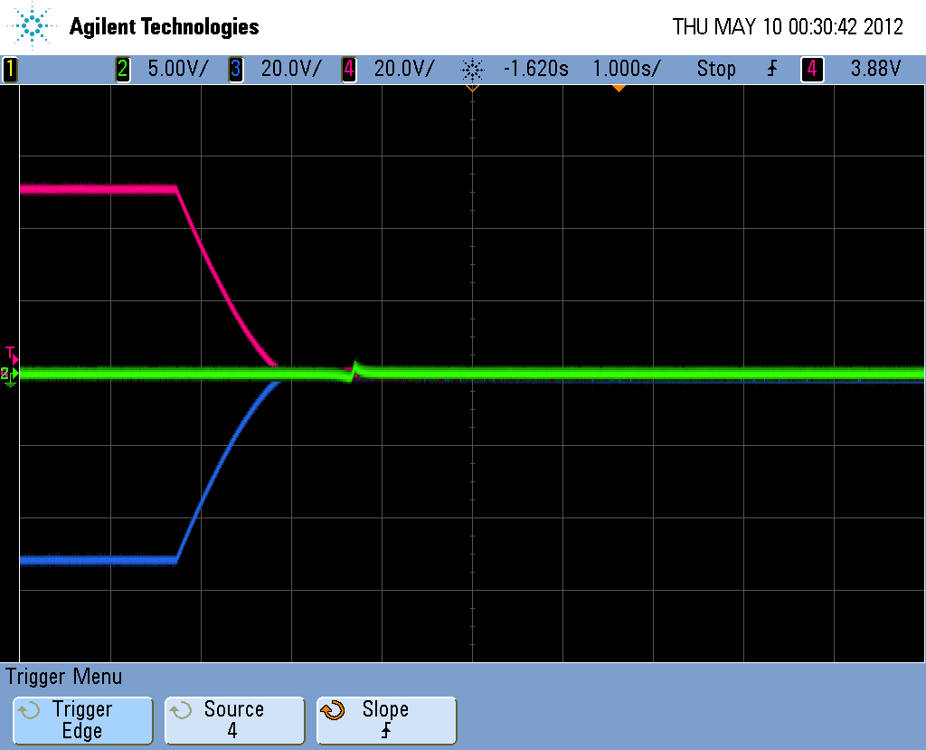

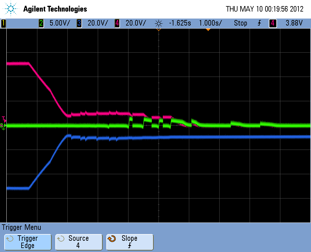

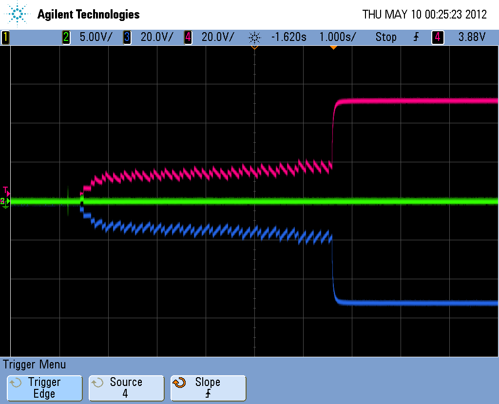

Hi Guys,
I've got a few more measurements to post up that I took today.
I measured the startup and shutdown behaviour of the DPS-400 and I re-did all the measurements for the DPS-600 since I had somehow misplaced the folder.
I'll start here with the current DPS-400 startup and shutdown behaviour.
In the scope captures, red is the + supply, blue is the - supply and green is the output. Note that the V/div scale is different for the output and the supplies to better show any voltage deflection on the output.
1. Failed startup at 400mA - plugging unit in fully discharged
2. Successful startup at 300mA - plugging unit in fully discharged
3. Successful startup at 400mA - Unit already plugged in, power SW used
4. Shutdown using switch @ 400mA
5. Shutdown using switch @ 400mA zoom in
6. Shutdown @ 400mA by unplugging unit
As a side note, I would indeed agree with Bill that the aggressive and rude posts are really not in very good taste. Everybody makes mistakes, and if you want a fully polished product with a warranty that has been thoroughly tested and verified then I'm afraid DIY audio is probably not the hobby for you.
Although I completely agree that these issues need to be fixed before the supply is suitable, I think going about it in a civil manner is more constructive than launching a full on attack against someone.
Let's give AP2 the benefit of the doubt and see if his fix works for us. Please try to keep in mind that he doesn't owe any of us anything, and he could just as easily shoot us all the bird and walk away. How about we drop the sense of entitlement and pick up the teamwork flag instead.

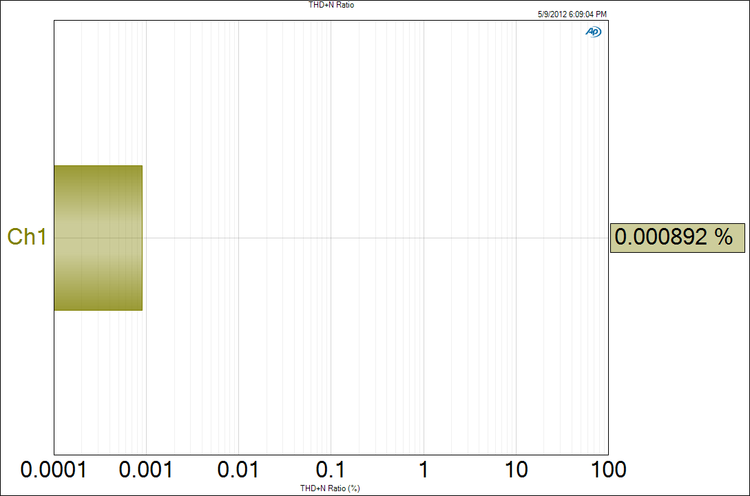

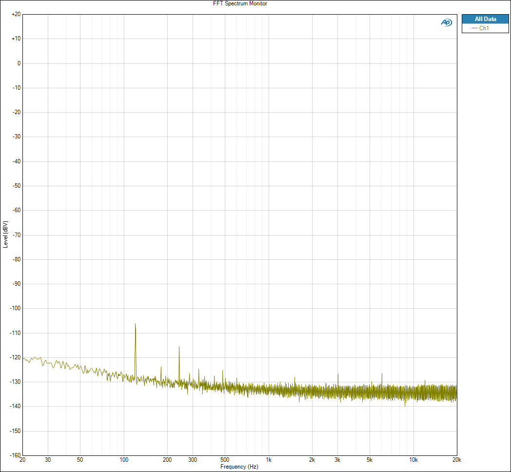

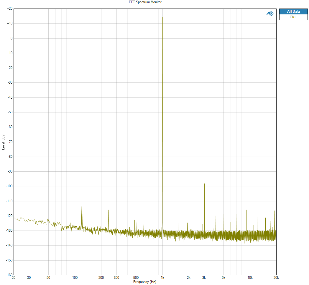

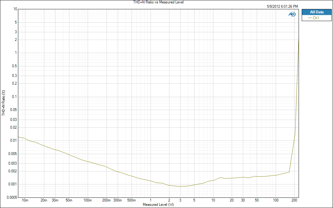

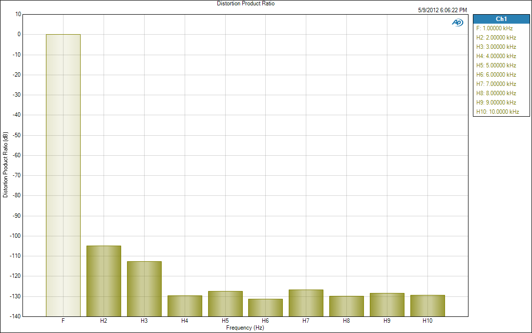

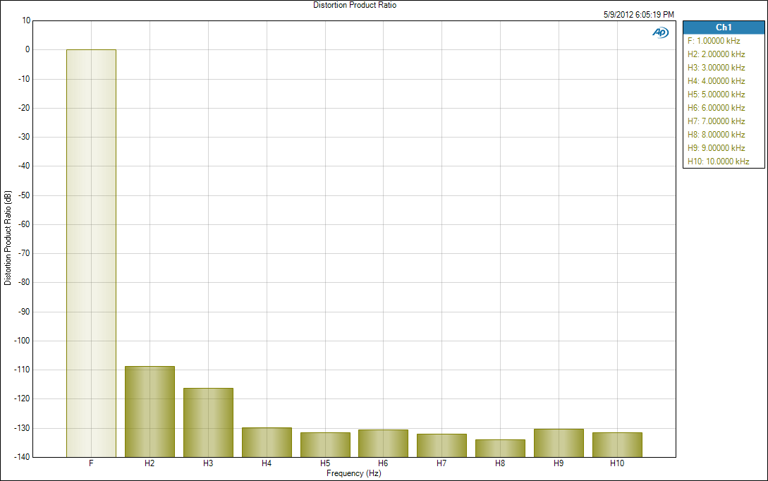

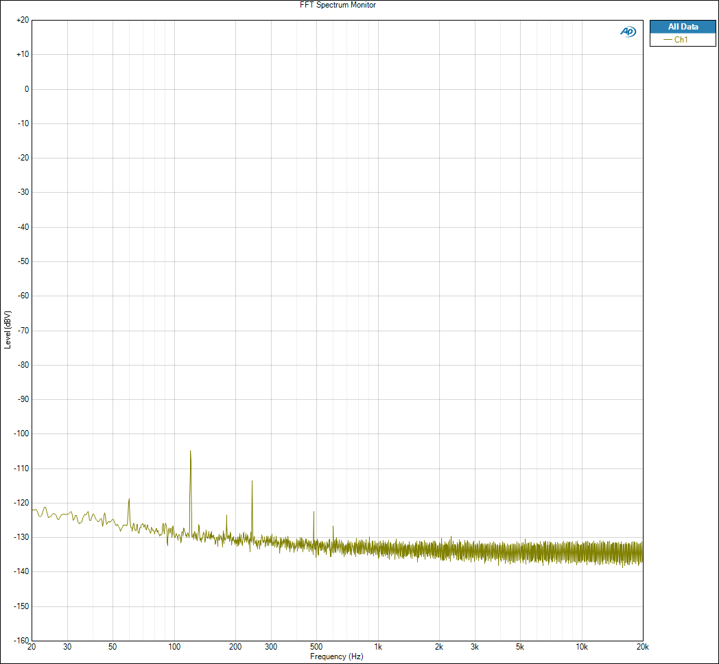

Next up are the results from the DPS600. Here are the test conditions:
Amp setup = SE
PSU = DPS600
+/- 67VDC on Mosfets
+/- 84VDC on LME
Bias level = 400mA (some 600mA - noted)
Gain = 28dB
Input = 200mV RMS
Output = 3W
Load = 8 ohms
Amp setup = SE
PSU = DPS600
+/- 84VDC on LME
Gain = 28dB
Input = 200mV RMS
Output = 3W
Load = 8 ohms

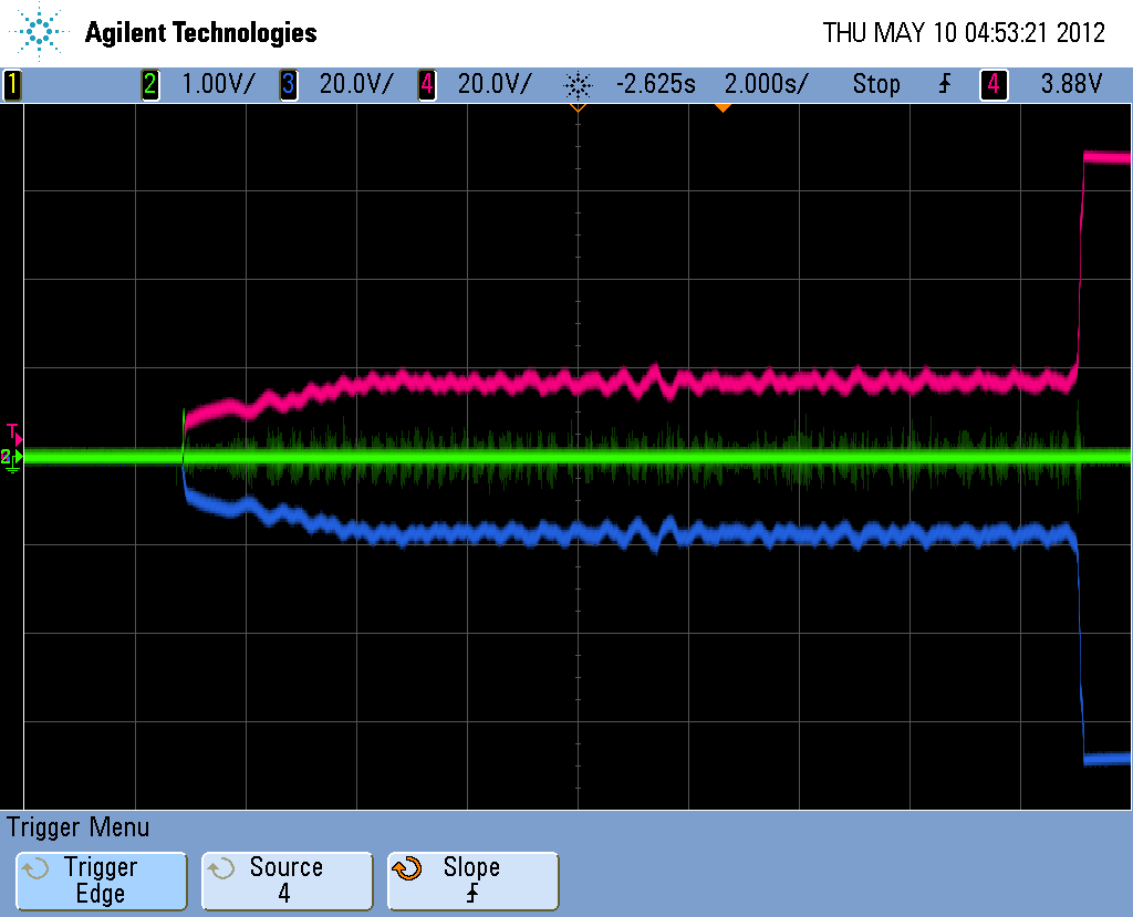

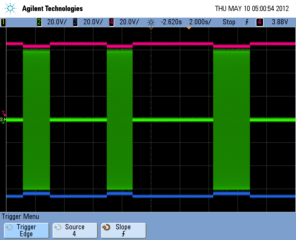

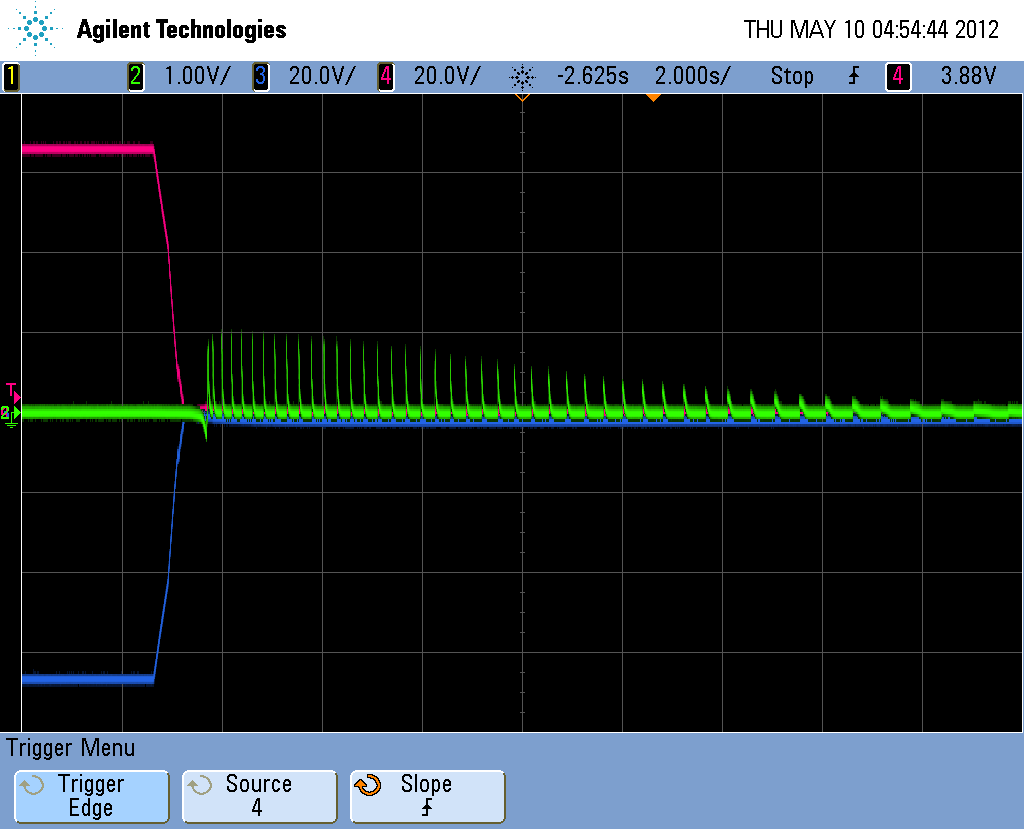

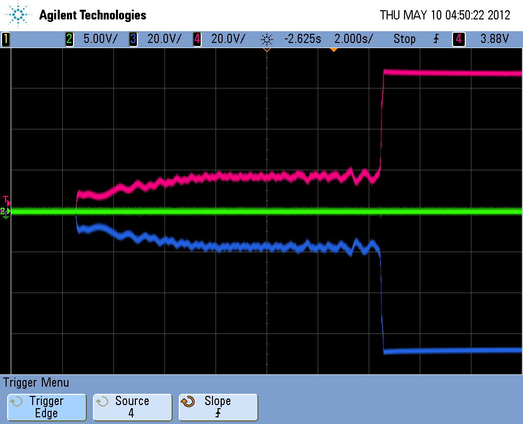

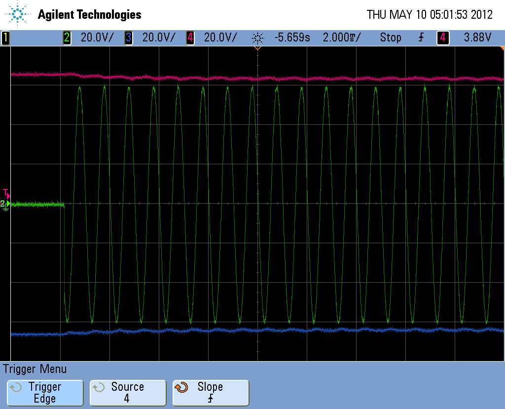

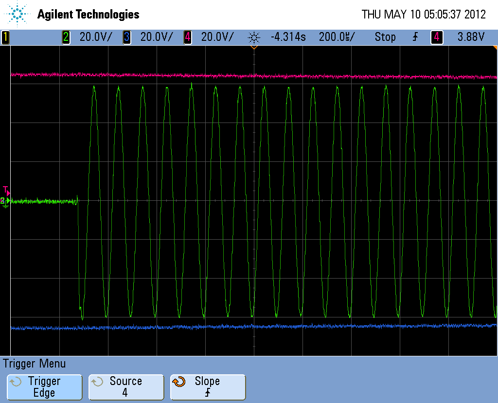

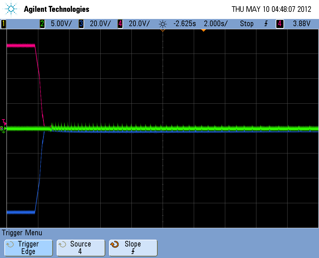

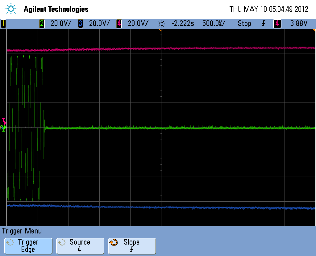

To go along with those I've got the startup and shutdown behaviour as well as the rail's reaction to full power bursts which helps show the performance of the supply's regulation.
1. Supply Startup - 400mA - fully discharged, plug-in
2. As above, but zoomed in
3. Supply Shutdown - 400mA - unplugged
4. As above, but zoomed in
5. 1kHz full power transients (225W)
6. 1kHz full power transients (225W) zoomed-in
7. 10kHz full power transients (225W) zoomed-in - start of transient
8. 10kHz full power transients (225W) zoomed-in - end of transient

Thanks Owen, very good setup on measure. i are happy when see burst zoomed with this smps,becouse without capacitors at output, see what is fast regulation,feedback and other.
with respect, some not have adequate knowledge to understand, looking at the modulation on the supply rails, which follows perfectly up to 10Khz. this would be sufficient compared with a linear transformer (this same measure), then it is simple even for those who do not have a profound preparation.
(67V to consider that we are almost out of range limit of the controller) I sent this version has the optimum range at 62-63V
impressive dynamic performance indeed!!. pic 4 above is a worry, but 5-8 seem to make it worth chasing down the issue. i'm not sure I quite get the scale other than referenced to full rails, but that doesnt tell me how much the output is scaled given its different? divisions on rails and output? (talking dps600 here) I wont comment on the dps400 unplugged, thats pretty scary, but I gather this is before the mod?
but a quick note I wrote before
Owen thanks for that; absolutely lets see what can be done, please do keep in mind that this is a bit of a different situation to the normal DIY purchase as AP2 mentions. there is no schematic and its a topology that most of us are pretty unfamiliar with, with issues that can easily happen outside the bandwidth of your average scope (assuming you have one), so diyer or not; understanding, monitoring or fixing problems on our own is not a reasonable expectation IMO and we just saw AP2 say he wouldnt attempt it himself. under these circumstances and given they are powering a DC coupled amp, I think it is perfectly reasonable to expect that obvious issues are sorted out and some assurance of performance is given. Rudeness and name calling is another thing entirely.
@AP2 600ma tall order? well see thats the thing, those coming from a class A world will often talk of 2A and higher bias (ok sometimes). will they do that from a cold start without sag? no they wont, but there is also no mechanism to latch up and cause transients like we have in the above pics.
so what can we do, seems a softstart is needed, could a fault condition be catered for by some sort of super capacitor to supply the PSU long enough that even if the cord is yanked, death is a bit more graceful? see i'm already looking to scatter sensors around this monitor system and connected builds with wireless Xbee modules and i'm looking for this to be battery powered for similar, but less extreme reasons.
I do appreciate your openness to this AP2, i've said that before all this and my thoughts have not changed

ok I got it now, right so we are looking at about 1v div on the output transient yes? thats not so bad as I thought for the dps600. the dps400 though is still a bit of a concern
(spike are 200mV) Hmm .. I'm looking at pic 2 (start sequence) and I see that the amplifier (output) is affected by the voltage remains at 20V before going up. then the problem of switching off, really tried here goes. amplifiers have a small instability if the voltage is still low. now is to see if because of the voltage for the driver.
i mean, amplifier not show this defect, if the voltage rises rapidly. heheh, this is a beautiful study, we investigate now 🙂
well, the proof is right in pic 4. for safety, stop the trace output (green), i want se red or blue voltage actions in this segment zoomed. very help,if you can show ch1 on one rail of lme also
