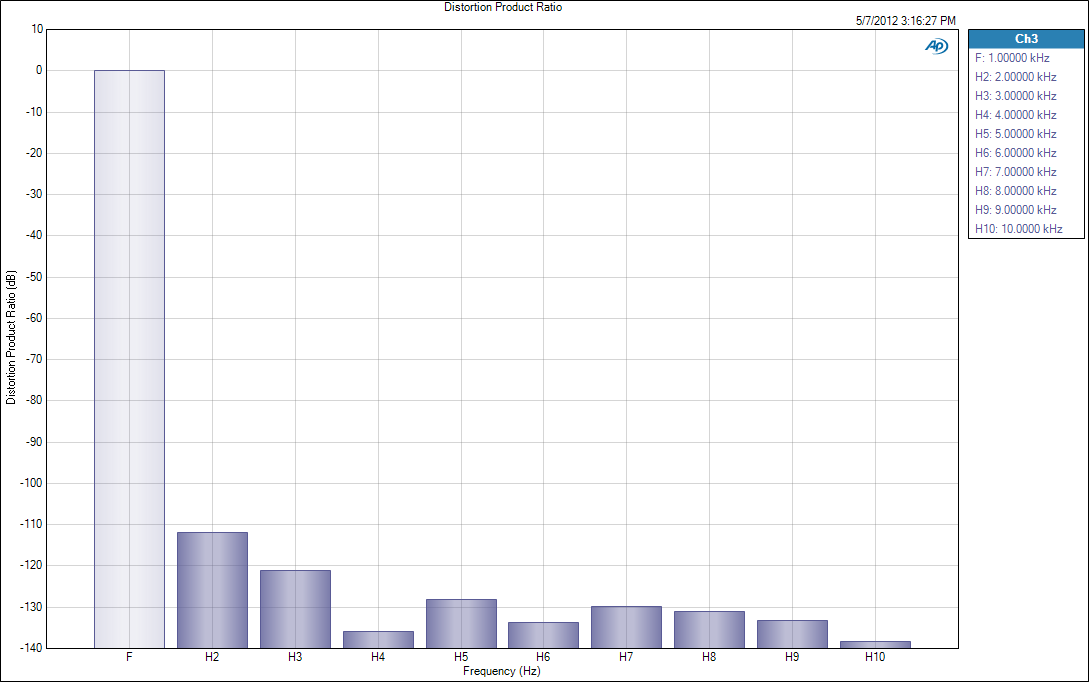

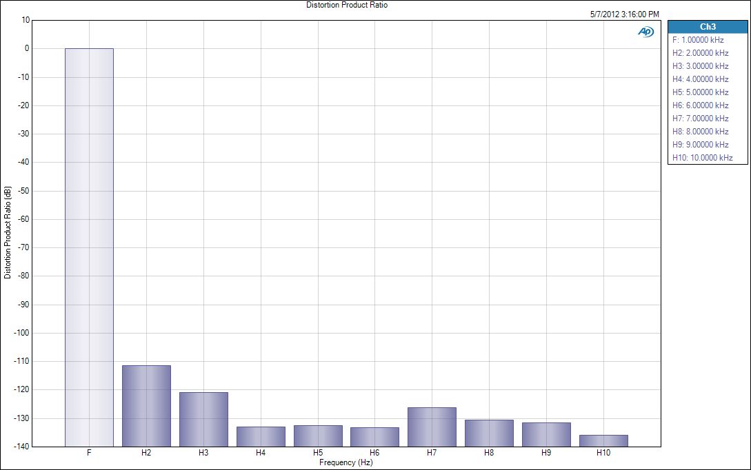

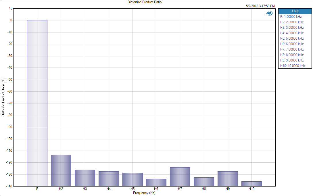

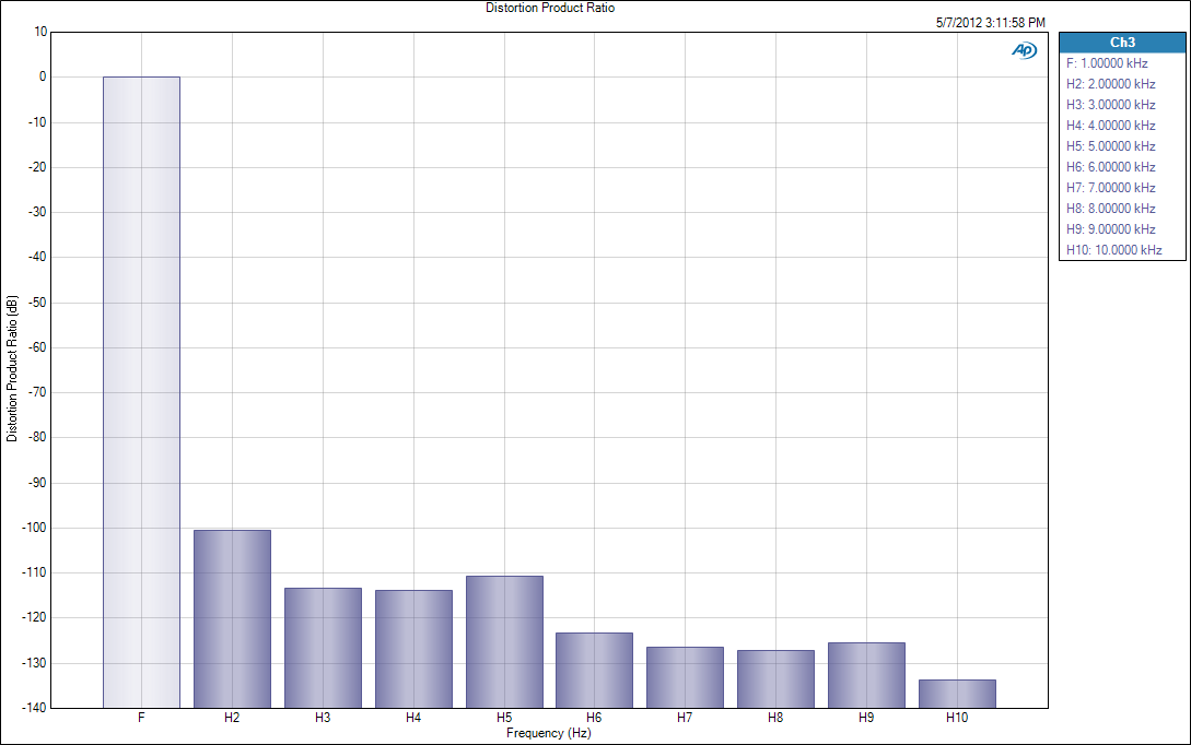

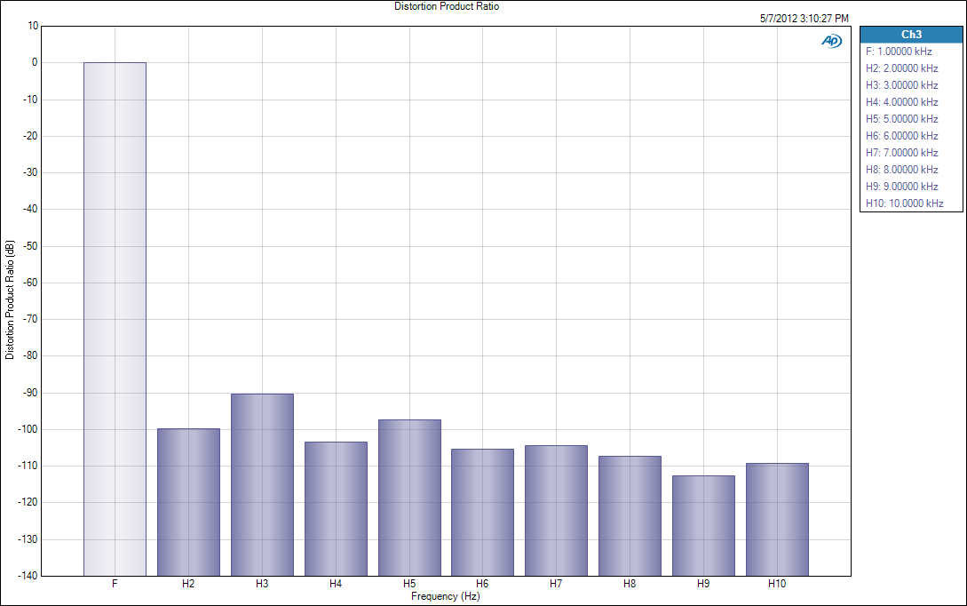

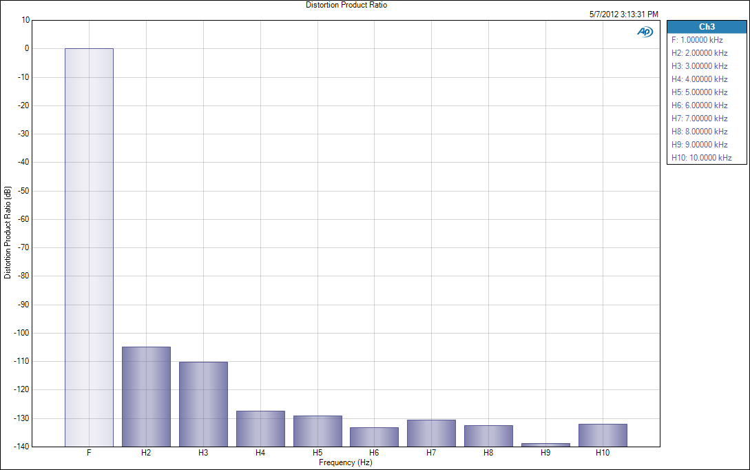

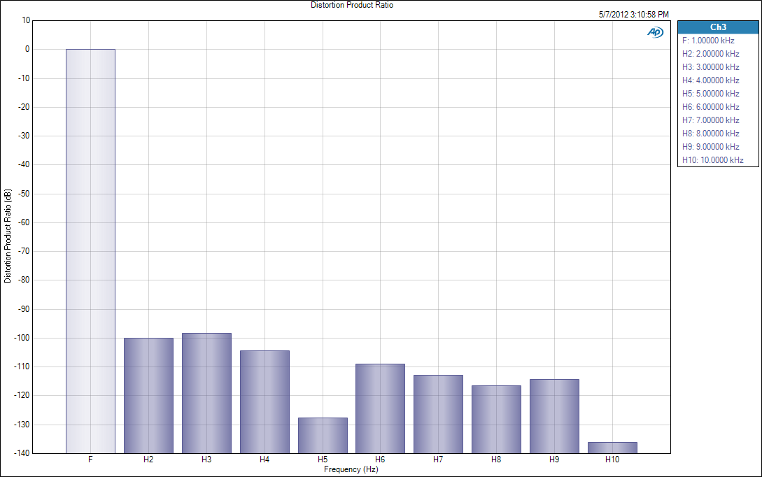

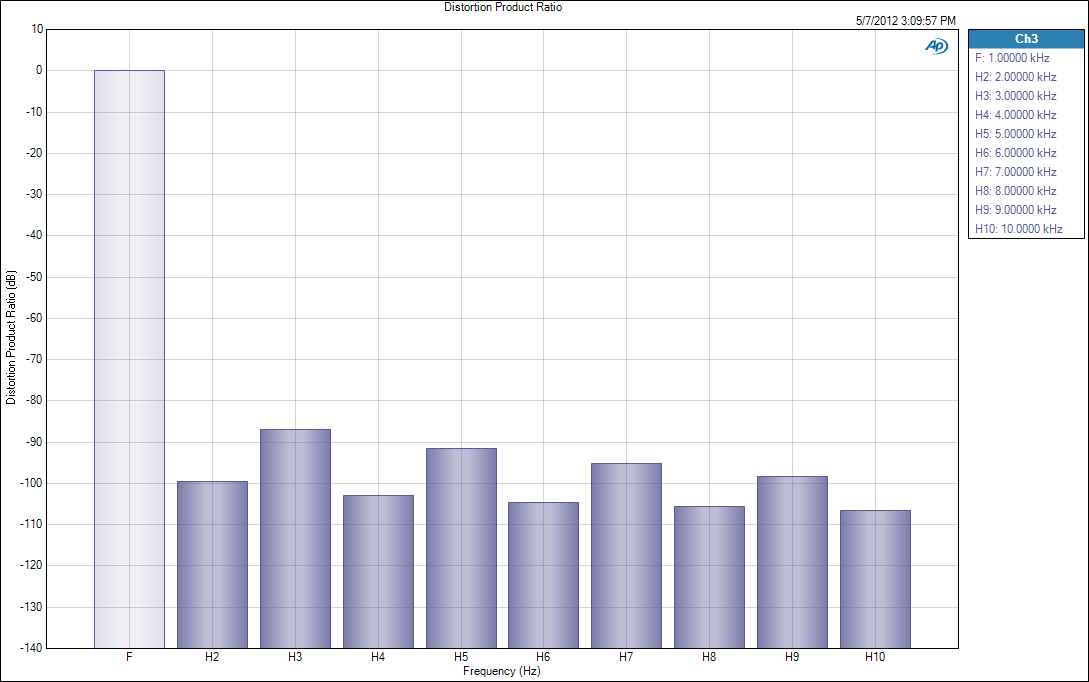

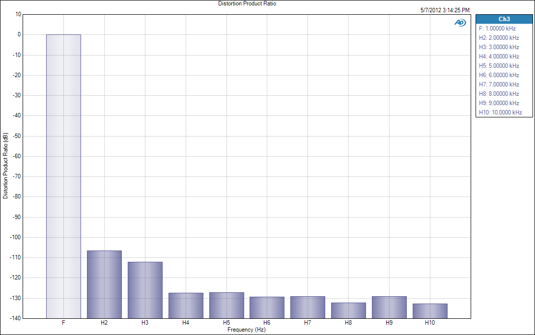

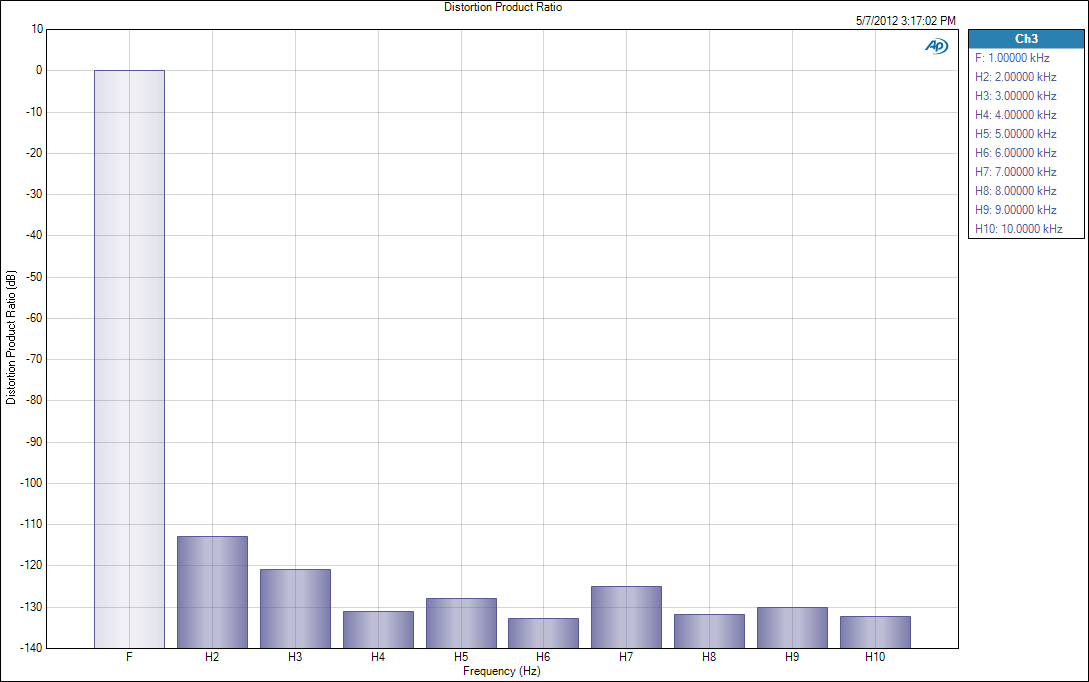

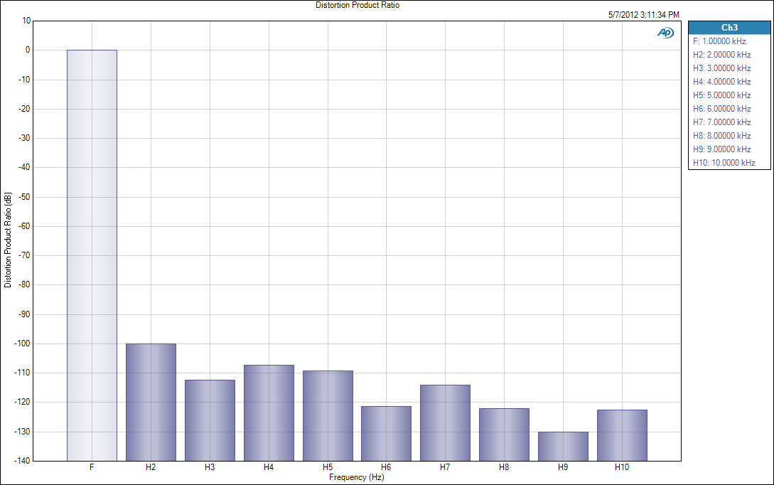

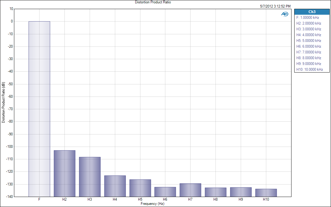

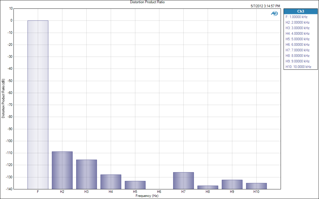

Now that people have everything they need to start building, I have a few goodies to post up regarding bias settings and the SMPS I've measured.

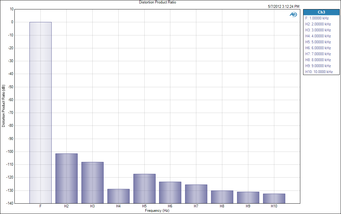

I'll start with bias. I took a whole pile of distortion and distortion product ratio (DPR) measurements at various different bias levels. This way, each individual user can make their own decisions about what levels to bias at.
Here's the test setup:
Amp setup = SE
PSU = DPS400 with PBTU
+/- 52VDC on Mosfets
+/- 64V on LME
Bias levels from 25mA to 1A.
Gain = 28dB
Input = 225mV RMS
Output = 3.9W
Load = 8 ohms
The first set of attached images show the distortion product ratio at different bias currents.
Overall bias levels are (in order):
25mA
50mA
100mA
150mA
200mA
250mA
300mA
350mA
400mA
500mA
600mA
700mA
800mA
900mA
1000mA
And here are the rest:

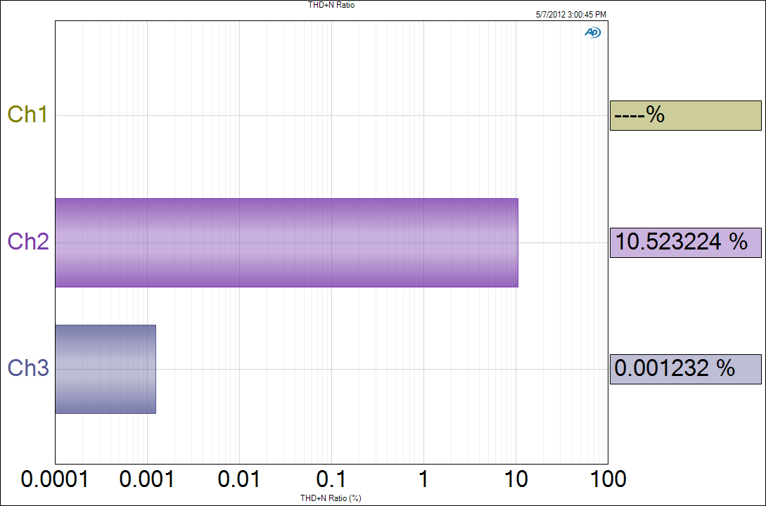

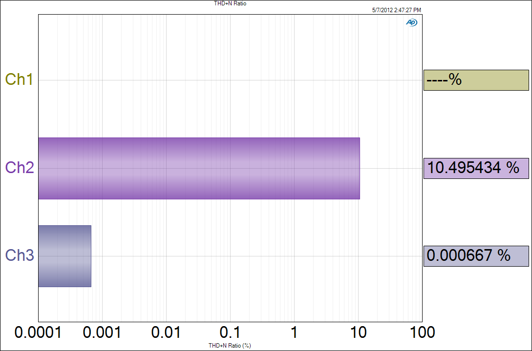

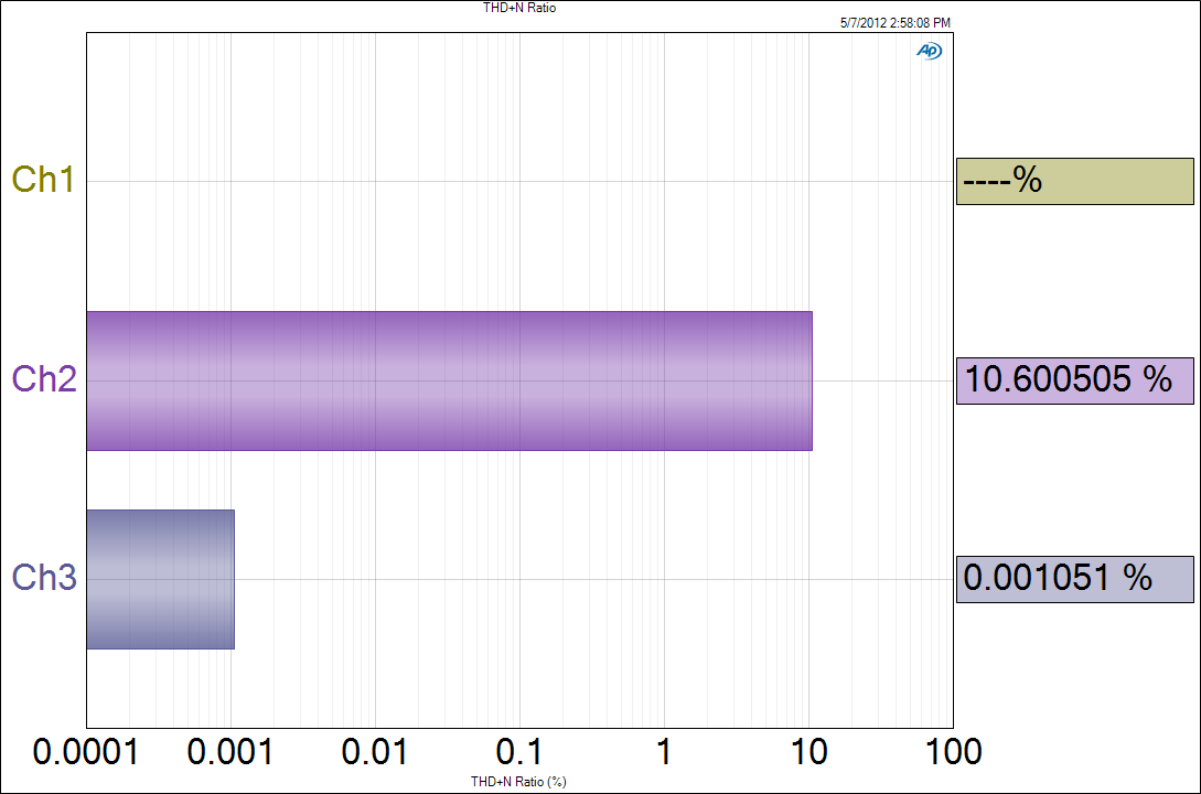

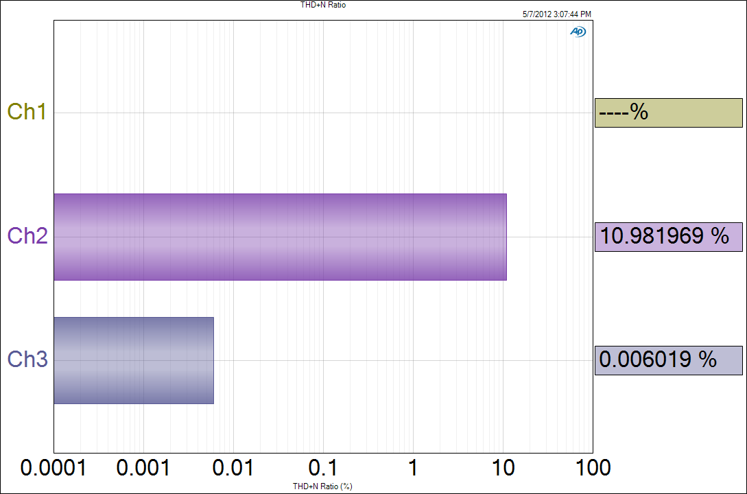

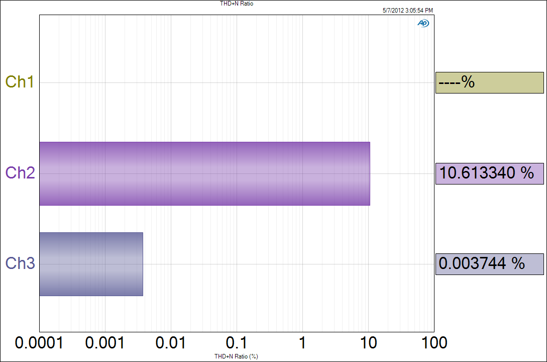

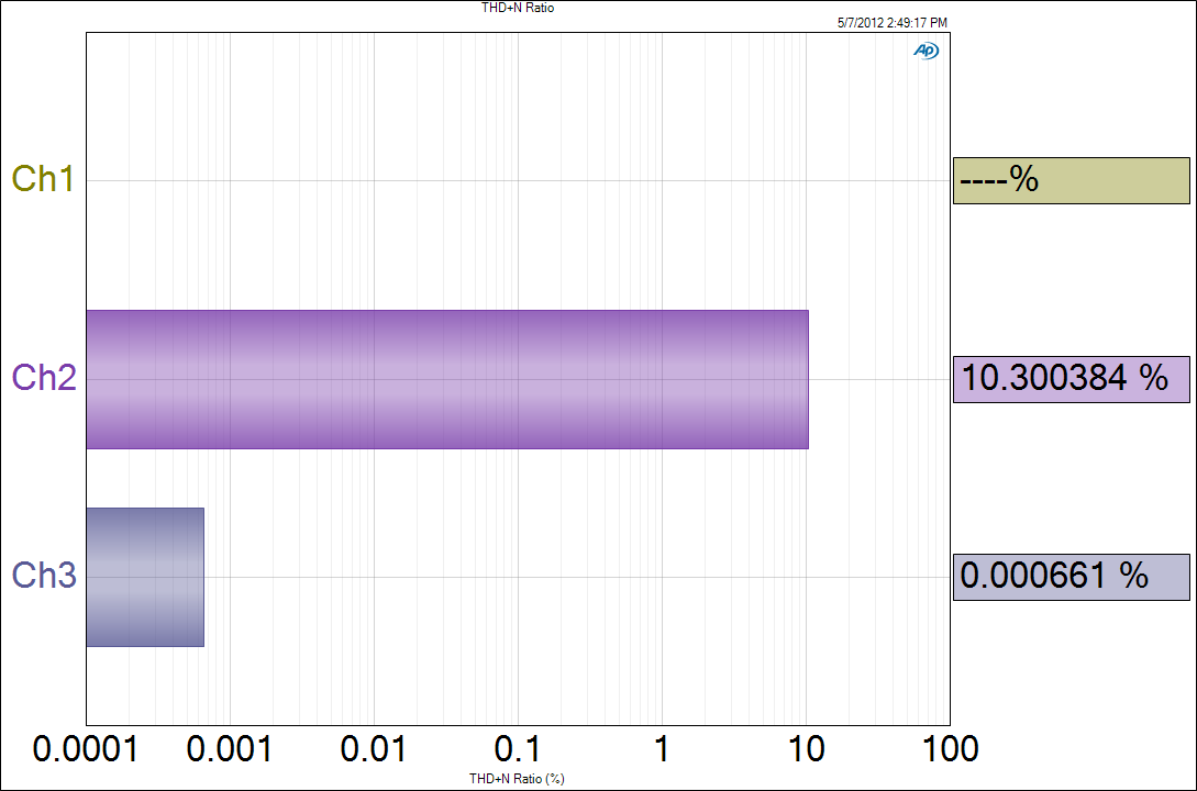

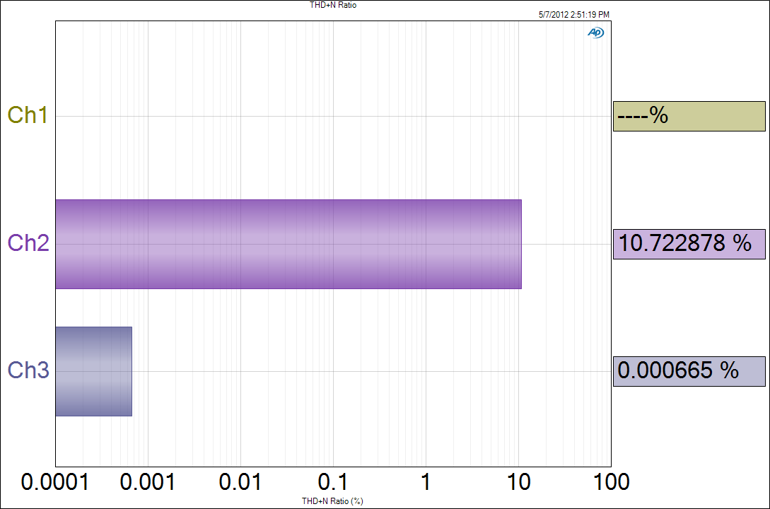

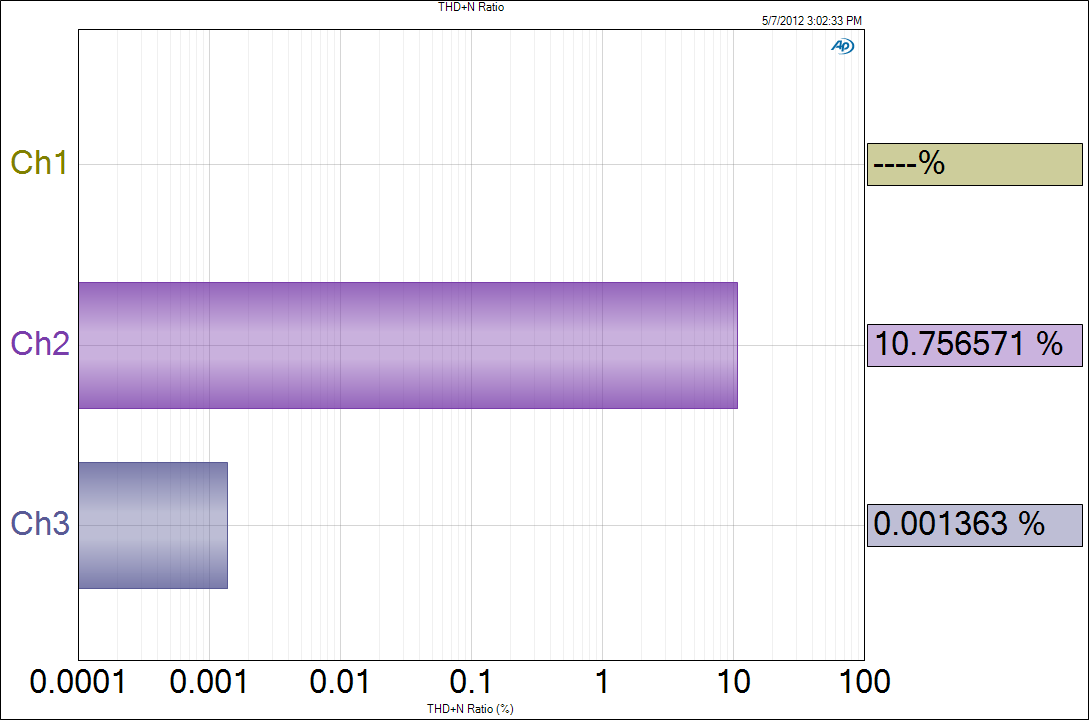

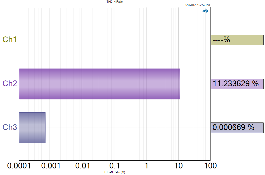

Next up I've got the actual THD+N expressed as a percentage for each bias level.
Same order as last time, but the 900mA measurement is omitted. The only relevant channel is CH3. The other two are disconnected.
Keep in mind that these are THD+N measurements, and as a result they stay about the same at higher bias levels even though the distortion continues to drop if you look at the DPR graphs. This is a sign that the noise levels are becoming dominant at higher bias levels as the distortion starts to drop below the noise floor of the amp with this supply.

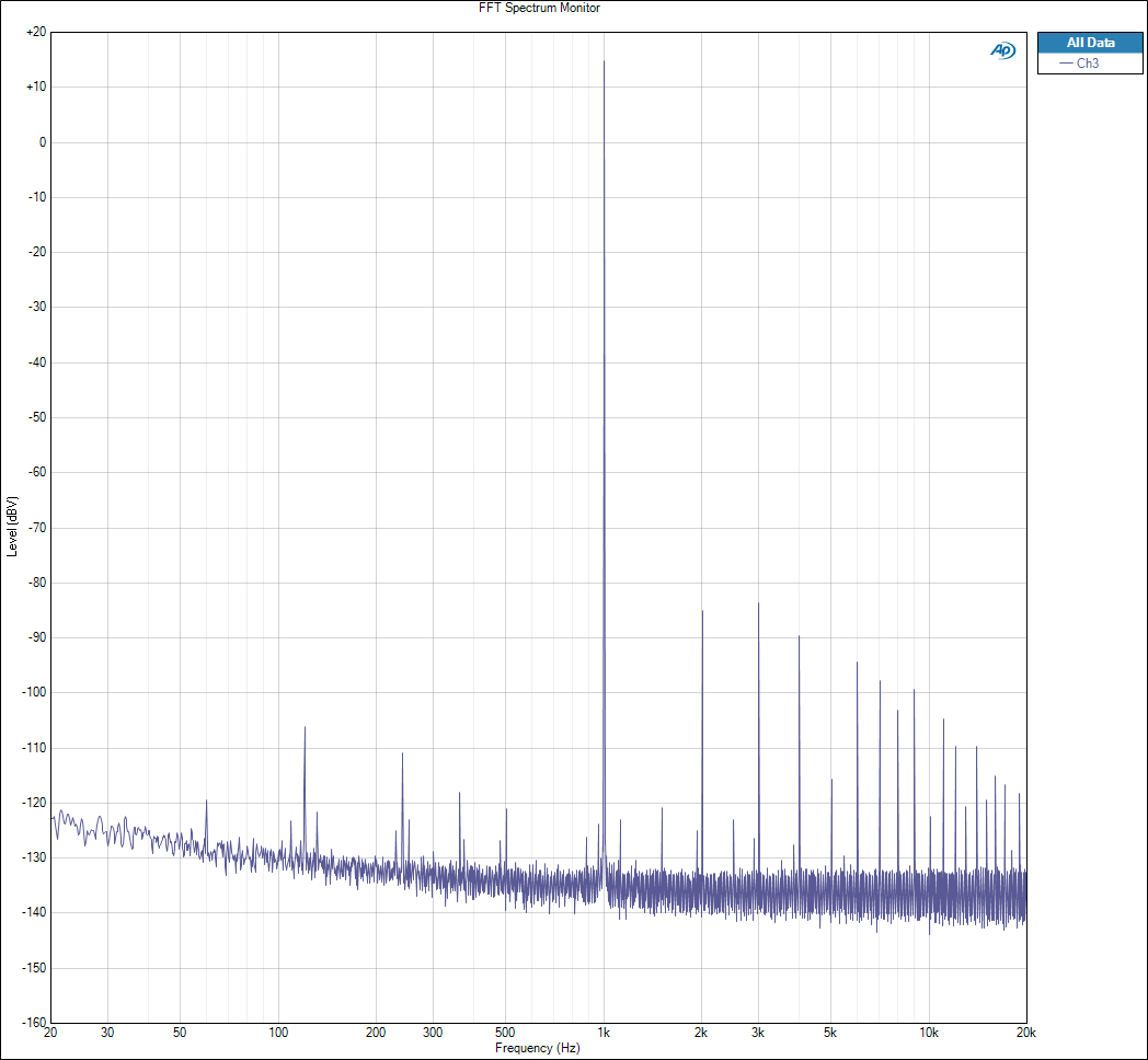

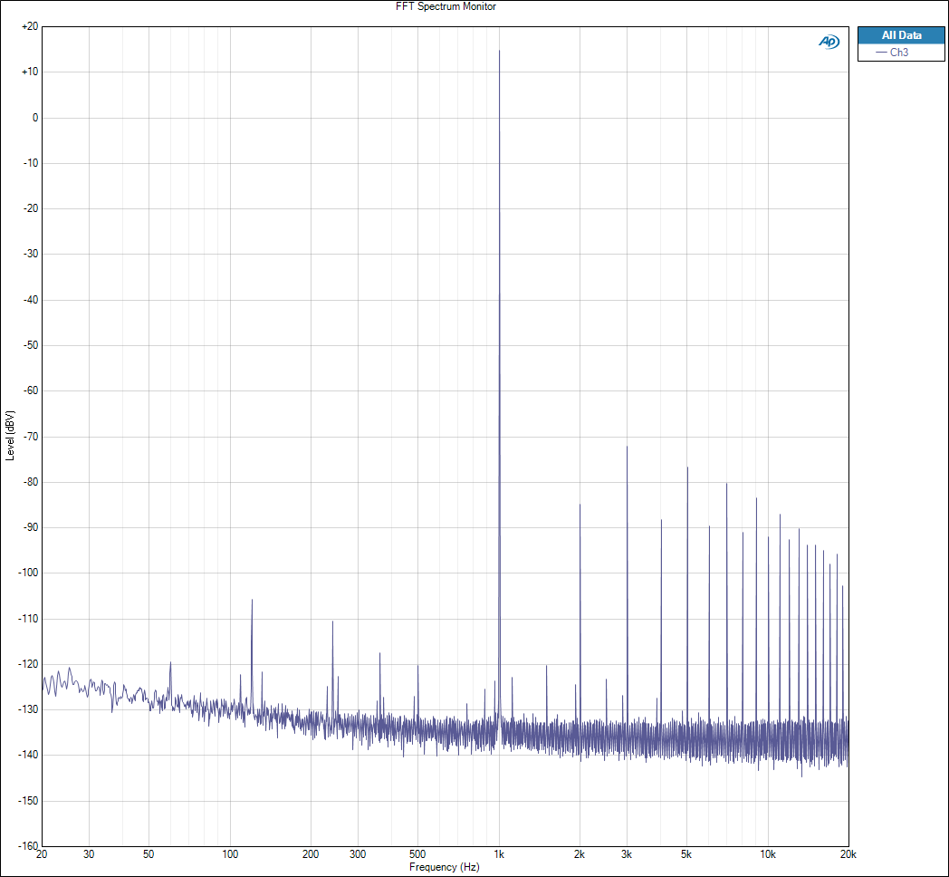

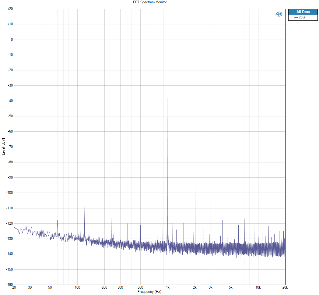

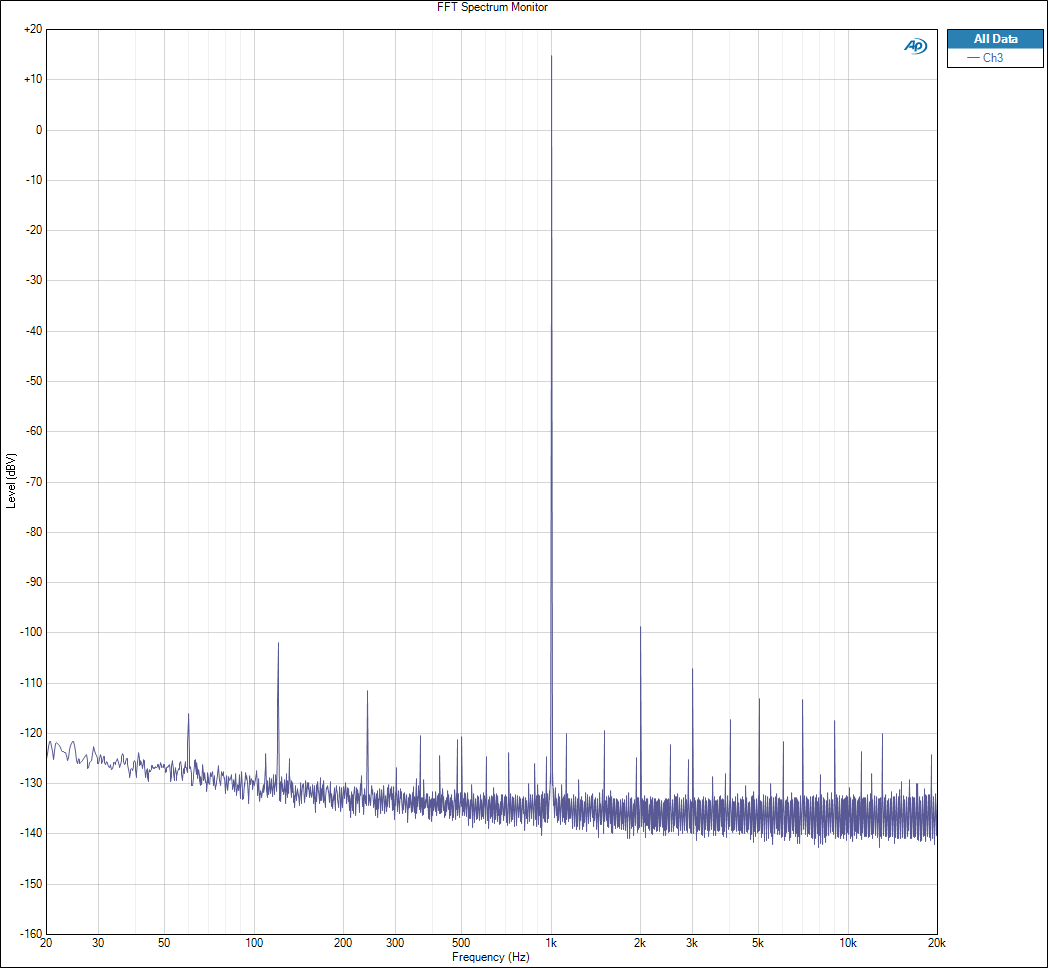

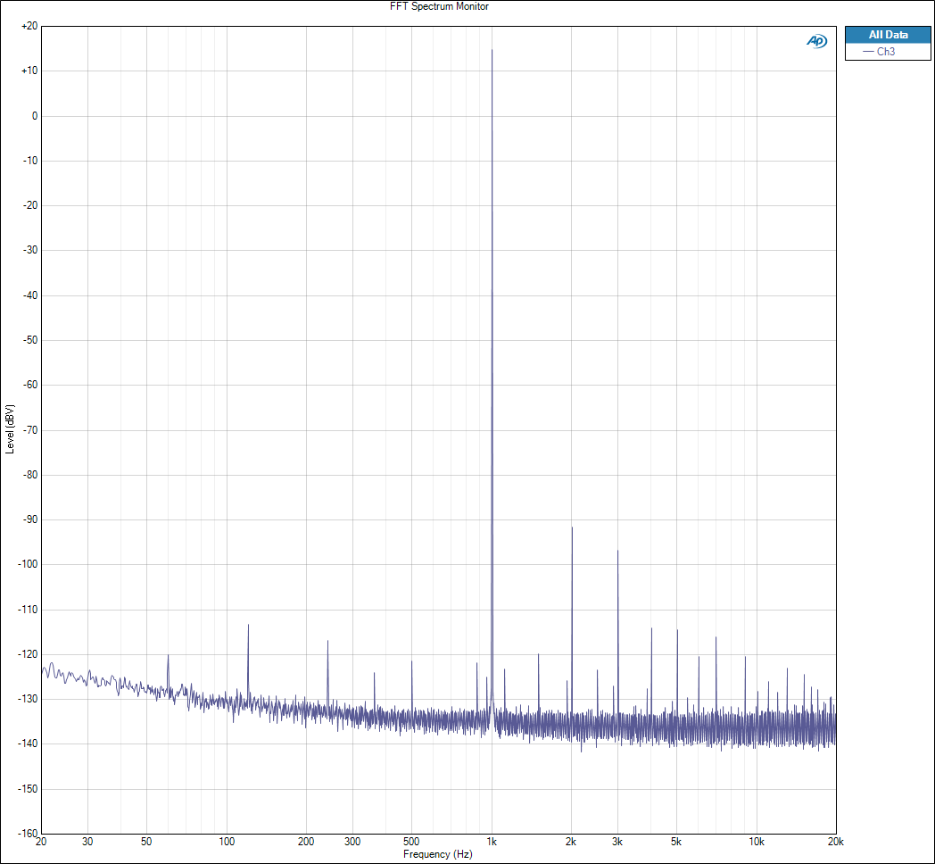

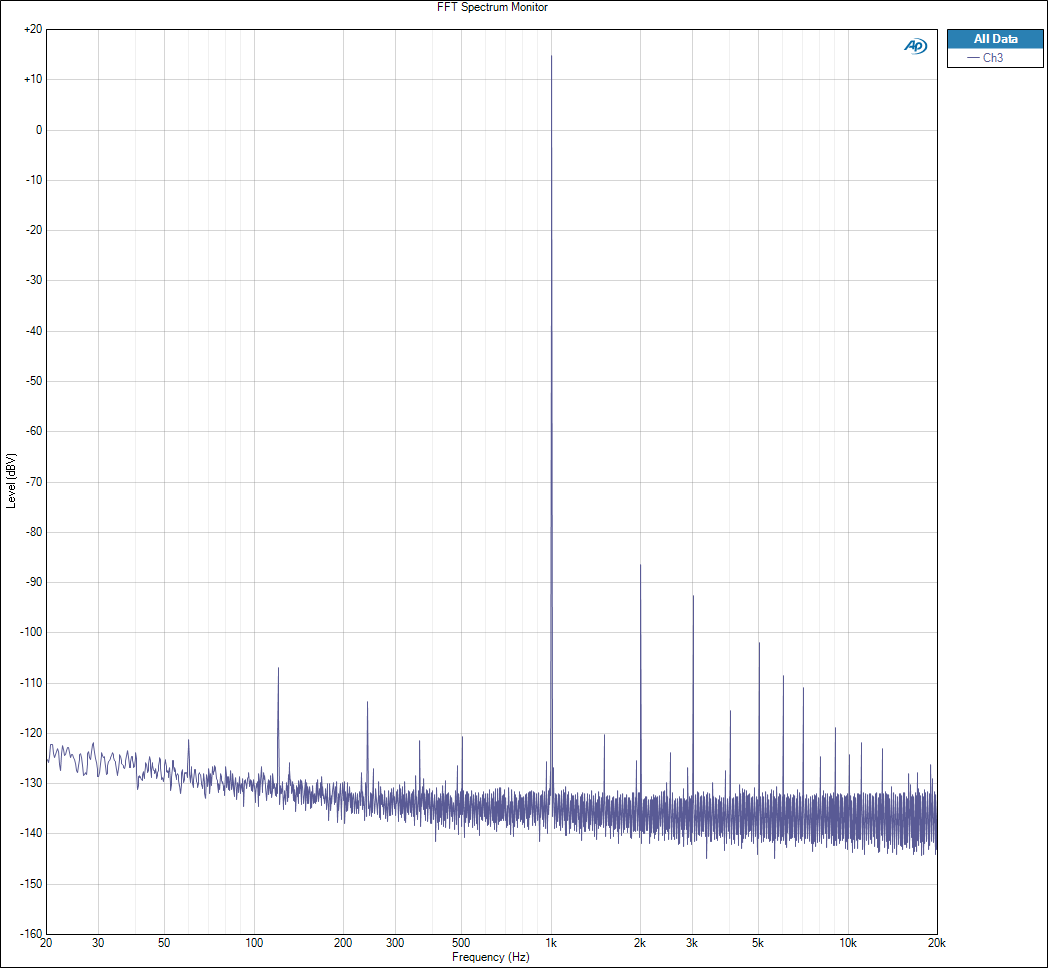

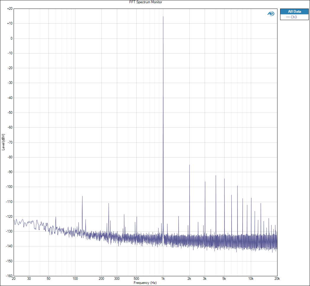

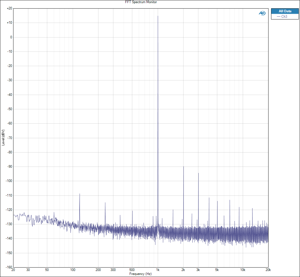

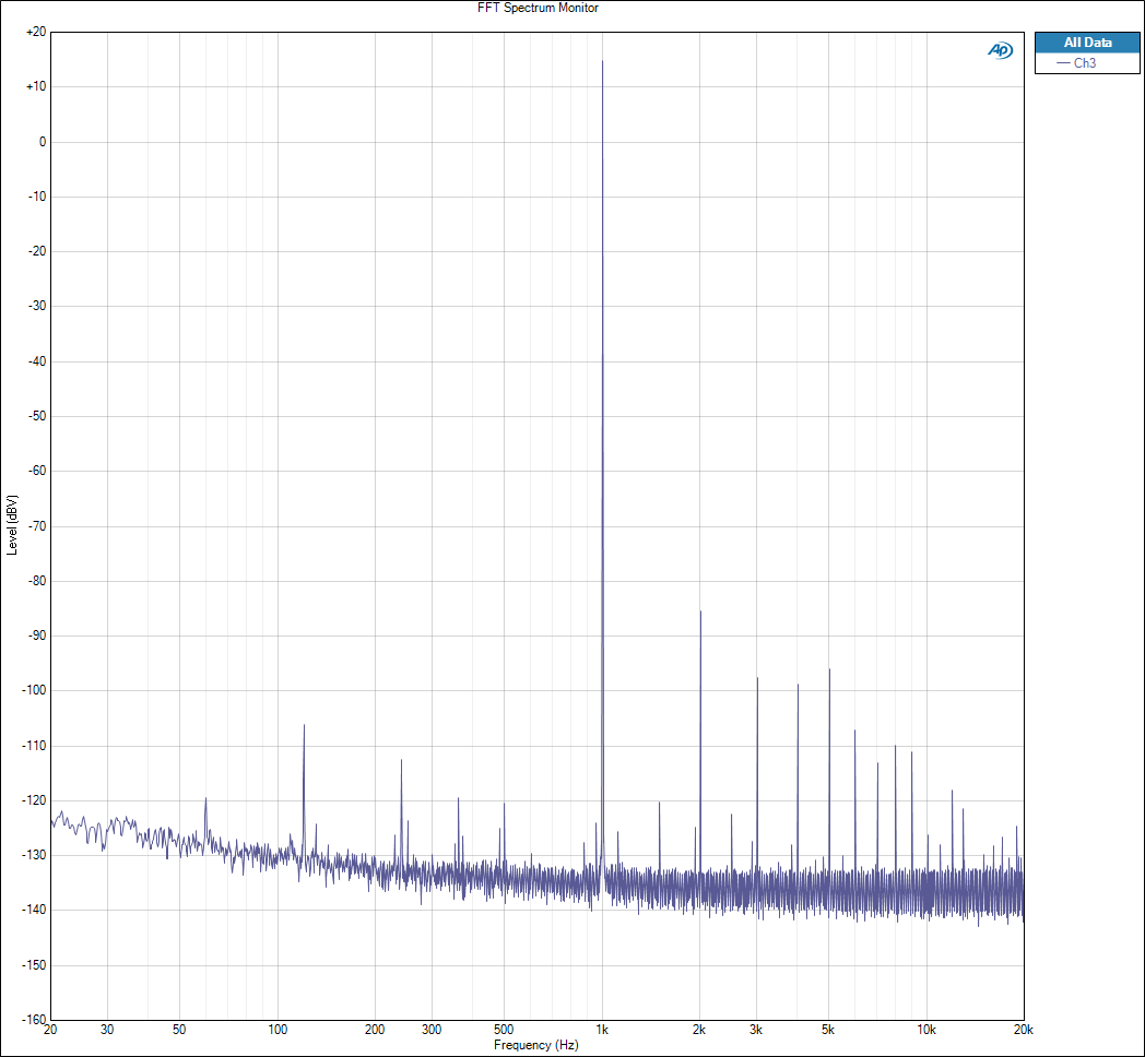

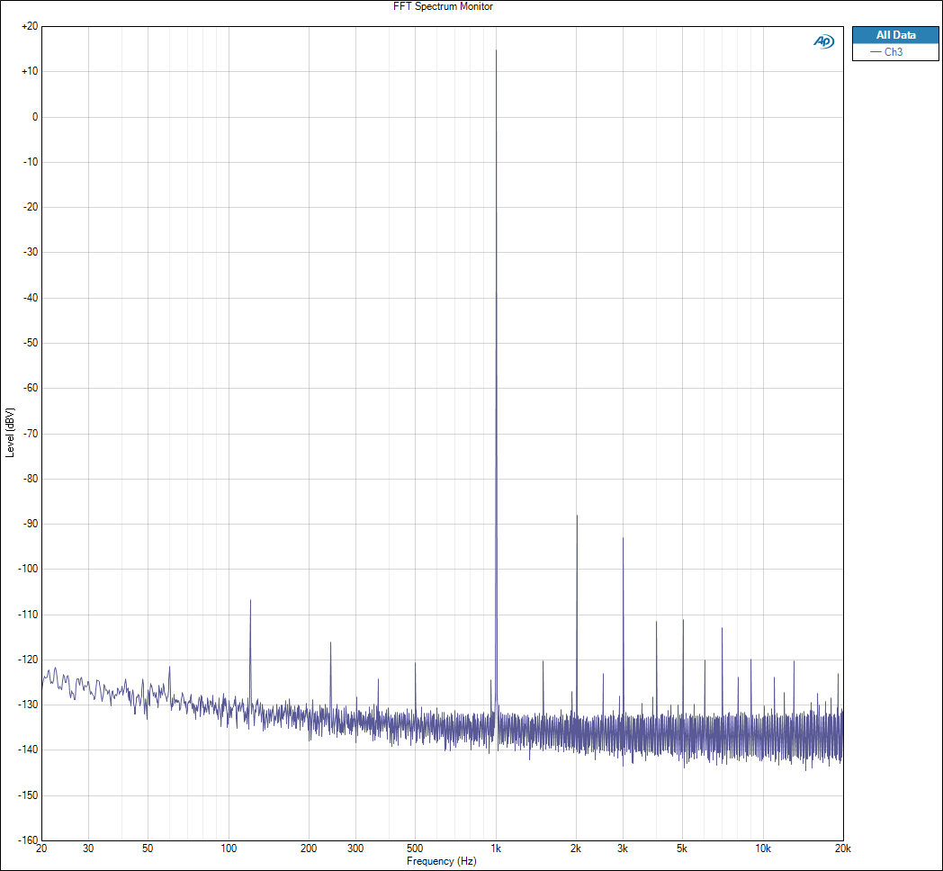

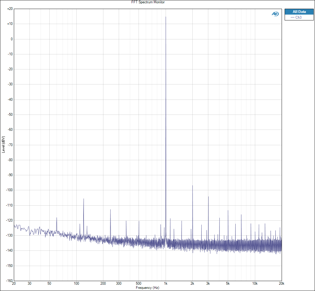

Lastly I've got the FFT's for each bias level. These essentially show what the DPR graphs are showing, except you also get to see the effect of the 120Hz noise from the PSU and the noise floor itself.
Notice how the 120Hz noise is lowest at midrange bias levels, and climbs at both low and high bias levels.
It's also worth noting that the supply will not start at higher bias levels, but seems to be okay with them when it's adjusted after startup. higher bias levels might require active cooling.
Overall, pretty much all bias levels above 25mA provide respectable performance, but in the name of balancing the harmonic distortion character of the amp, I'd suggest sticking to levels of 300mA or more.
At 300mA, everything above the third harmonic disappears below the -120dB line, which means all you're going to hear (if anything at all) will be the second and third harmonic.
Additional bias past 300mA basically provides additional gains in distortion reduction, and has a pretty significant effect on the 2nd and 3rd harmonic while pushing the higher harmonics below the -130 dB mark, essentially burying them in the noise floor of the amp. The 600mA bias point seems to be the "point of diminishing returns" where only the second and third harmonic are driven slightly lower at the cost of much more idle dissipation.
If you have a supply that is fully regulated and very quiet, then I would expect a measurable improvement up to and beyond 1A of bias, but make sure you tread into that territory carefully as you might not get any real advantage while suffering the very real disadvantage of much higher utility bills. Everything has its price.
If you're using this as a subwoofer amplifier, I would seriously consider a lighter bias level in the name of efficiency. Dropping down to 100mA would be unlikely to have any effect given the higher distortion of most subwoofer transducers. In the midrange and higher frequencies I would suggest sticking to 300mA or 400mA for a good balance between idle power consumption and performance, while really critical applications could push for 600mA to obtain the highest level of performance. This might make perfect sense in a lower power amplifier with lower voltage rails. If you like class A, then go right ahead and push up to or beyond the 1A mark. Just please make sure you have a very good power supply and sufficient heatsinking as things will get very hot very quickly, and only the best of sources and loads will be able to make use of the minute performance gains these bias levels provide.
Enjoy!
Owen

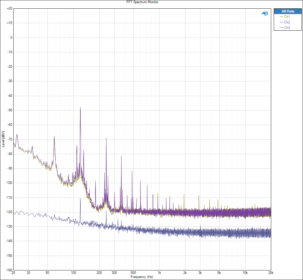

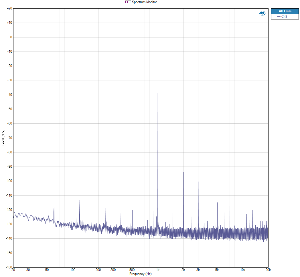

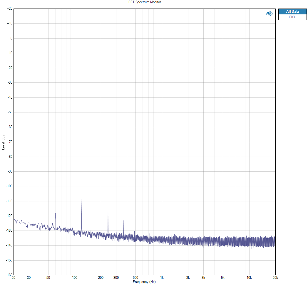

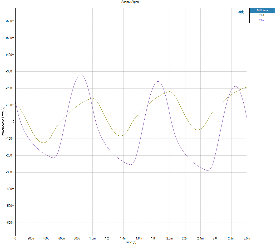

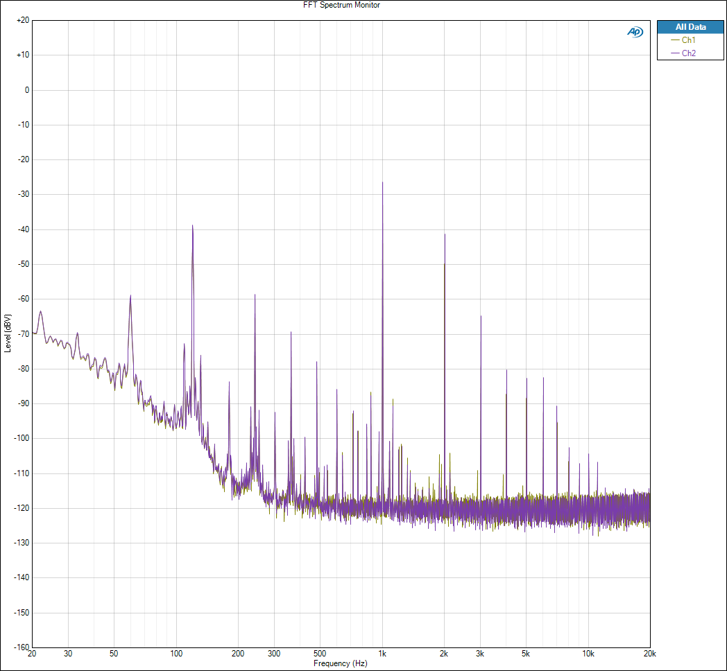

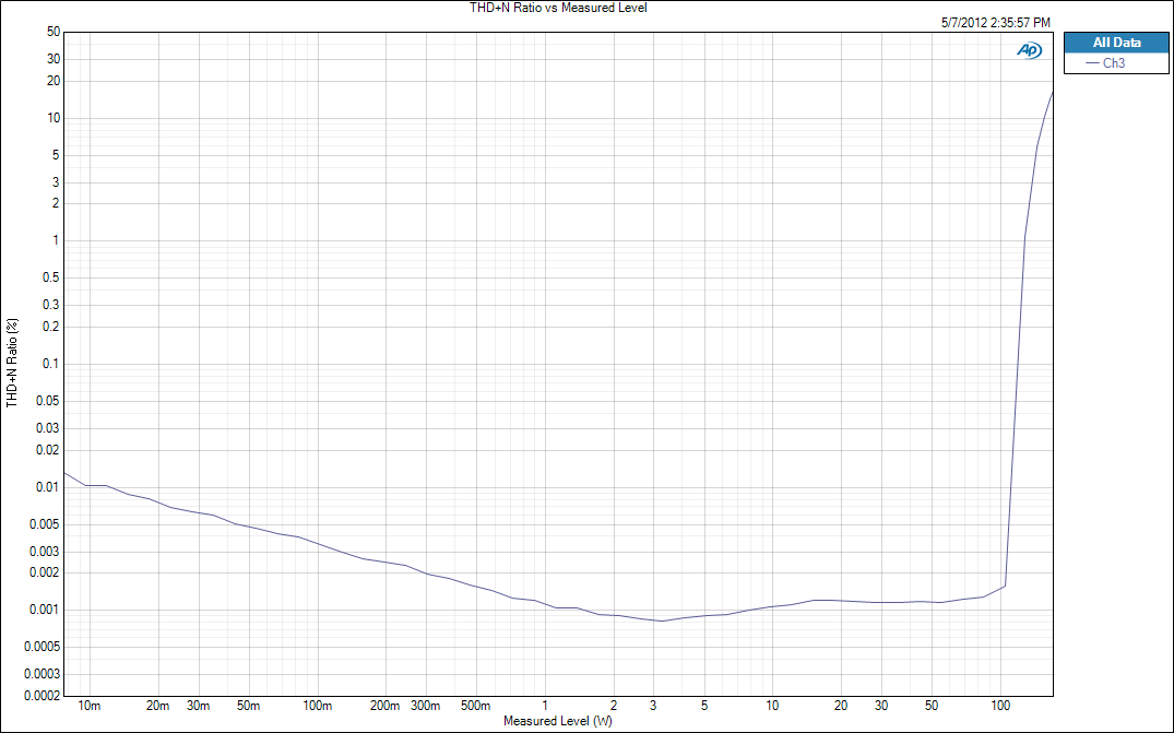

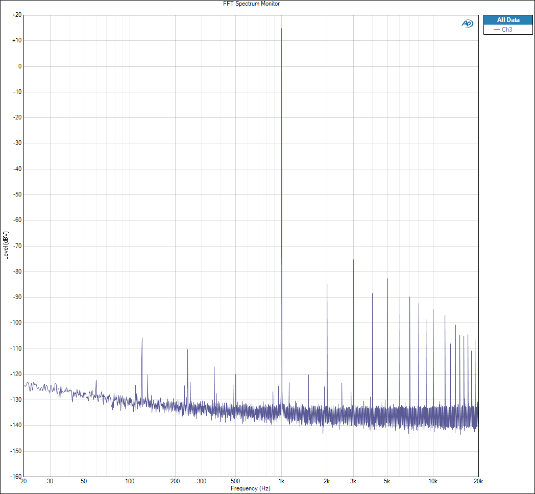

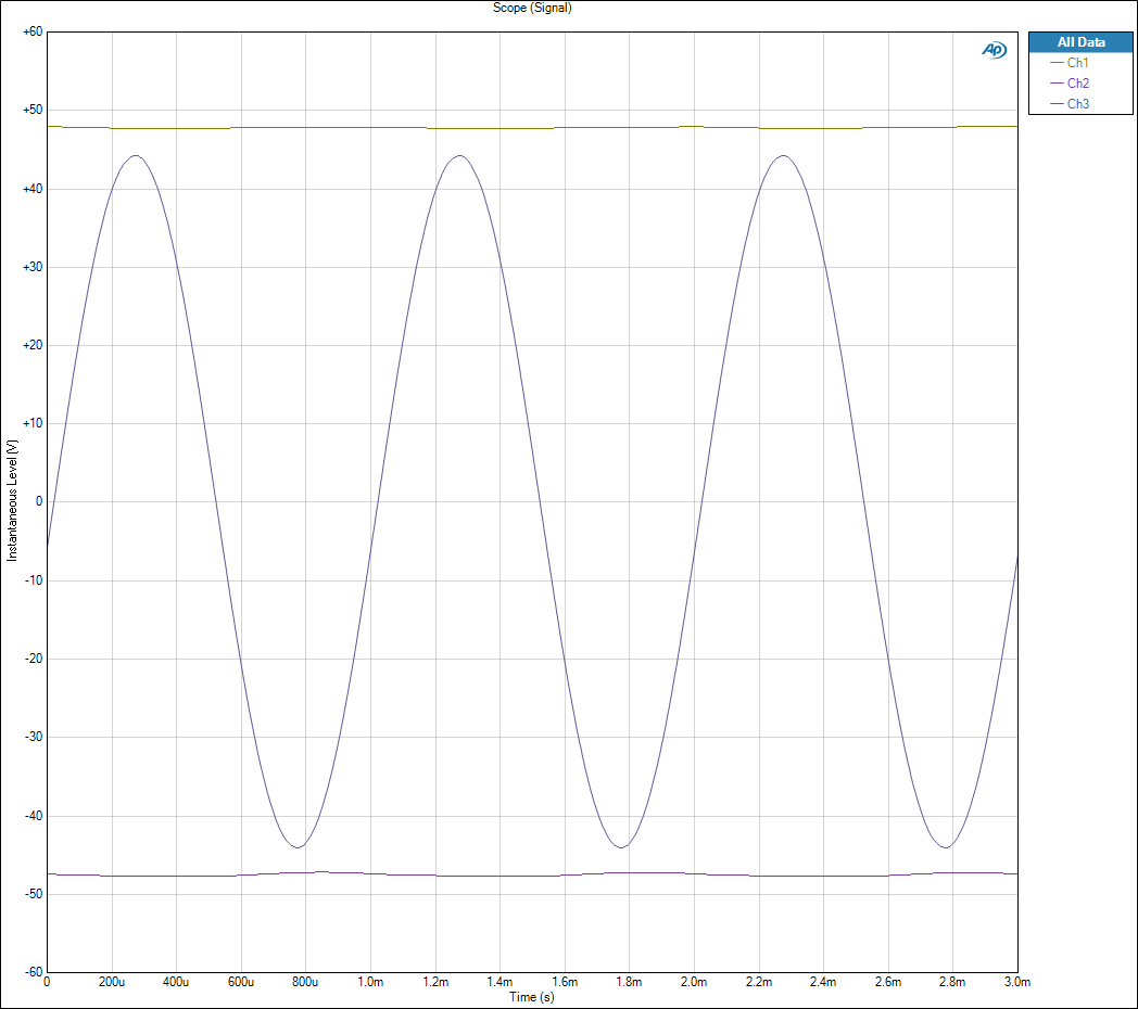

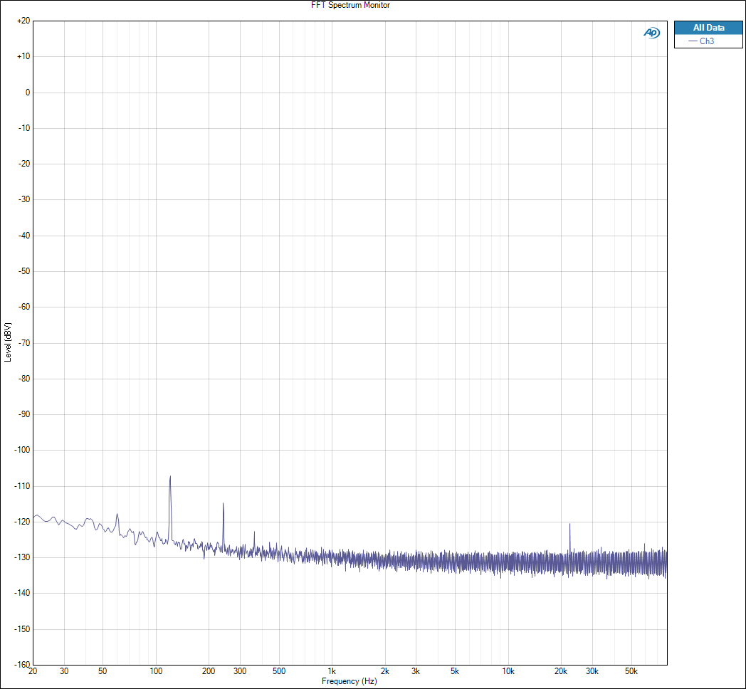

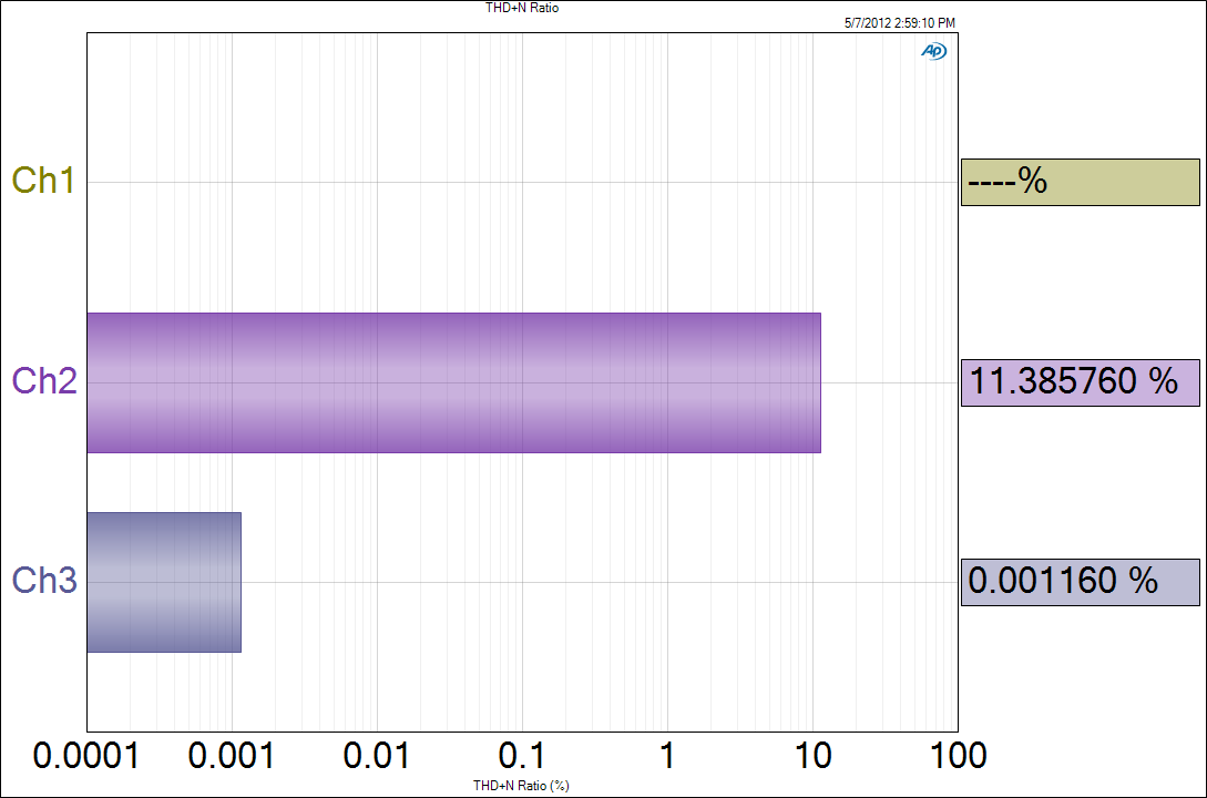

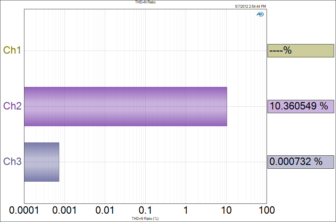

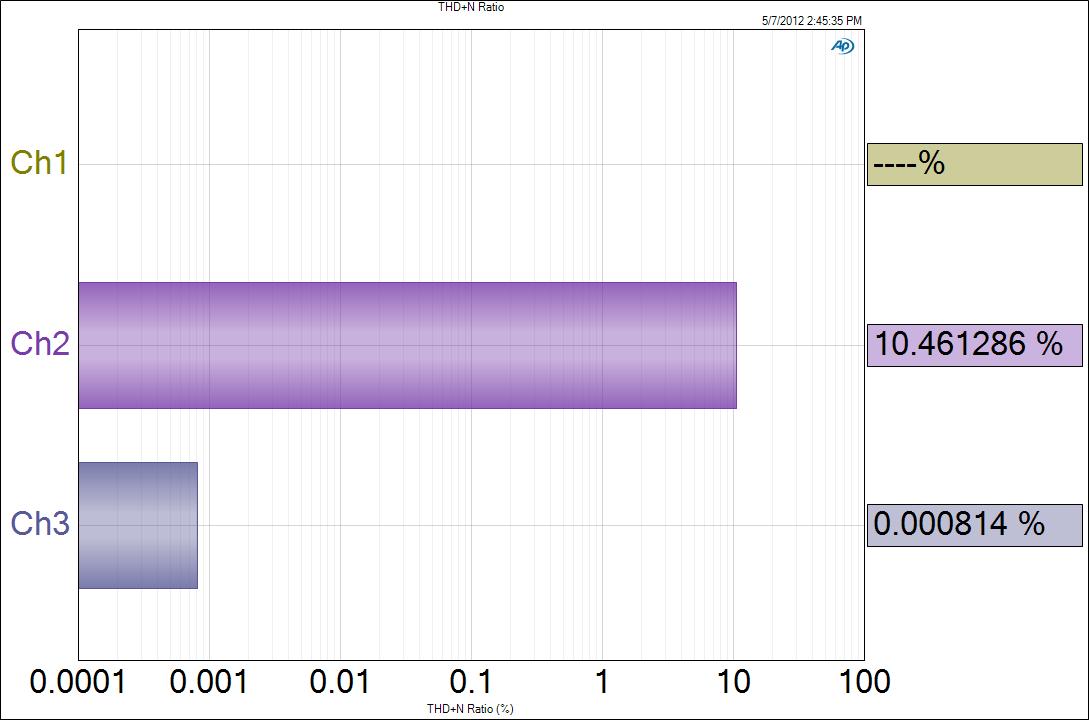

Now for the supply specific measurements. I measured the amp output noise floor, the output of the supply itself, the output ripple and all the operating conditions. Here are the test conditions for the DPS-400 and PBTU:
Mains AC voltage 233VAC
Primary Output Voltage @ 400mA: +/- 51.6VDC
Low Current Output Voltage: +/-62.5VDC (should be adjustable)
Maximum unclipped power @ 8 ohms: 122W 0.001% THD+N
Maximum output power @ 8 ohms and 1% THD+N = 128W
Maximum output power @ 8 ohms and 10% = 155W
Issues with the setup:
1. Both DPS-400 supplies that I have received will not start up with the amp set to anything over 250mA bias. I believe AP2 can resolve this, but I cannot provide more testing on this front.
2. If the power switch is used to bring the supply up and down, the behaviour is very good. There are no audible clicks and pops on the output, and voltage ramps up and down predictably and smoothly. If the plug is pulled, however, there are large transients caused by the supply dipping below its under voltage limit and shutting down, then immediately starting back up again. This happens as many as 10 times before the supply fully turns off, and the transients on the output are large. I would say that this behaviour is unacceptable unless a relay is used. AP2 will need to verify if this can be fixed. Overall, it means that you won't have a problem if you connect the supply and use the intended power switch on the supply, but if your power even goes out while the amp is on, you will get some mean transients on the output. Probably fine for a subwoofer, but certainly not for a fragile midrange or fullrange and absolutely not for a tweeter.
3. The PBTU is a very slick capacitor board with a full set of regulators for the HV output, but the adjustment pots for the regulators do nothing at all. It might just be the target level that needs to be adjusted, but this needs to be fixed so that the regulators are actually regulating.
4. The 120Hz noise (and subsequent harmonics) are a little higher than I would have liked
5. I cannot speak to the long term reliability or safety of the supplies. I had no issues throughout my testing, but I have done absolutely no work in terms of testing the safety features or suitability of these supplies. This is a serious liability area, and I just can't go there. Each user needs to make these decisions for themselves.
Things that were good about the setup:
1. It's very small
2. It's very light
3. It's pretty low cost, especially if you want monoblocks.
4. Output noise performance is very good for an SMPS. It nearly rivals a regulated supply.
5. Rail stability under load is quite good.
6. The power on/off and indicator LED work like a treat.
7. It's ready made, and other than cables, it's plug'n'play.
8. It sounds good.
Owen
