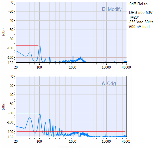

Hi Guys,
We're almost there with the supplies, but I have been holding back on posting anything until we have it just right. It has been a lot of work dialing in these supplies to work perfectly with The Wire amps as we have higher than usual bias current and I'm looking for a very low noise floor.
As a quick update, I can confirm the following:
1. The new modified supplies are extremely quiet, and easily outperform even my best attempts with linear supplies (even with regulated HV)
2. The pricing AP2 is willing to offer our group makes these price competitive (if not lower cost) than a linear supply.
3. The dynamic performance of the supplies far exceeds what a linear supply is capable of.
4. They are a complete solution that offer a plug-n-play option where you know exactly what performance to expect.
5. I did a full set of listening tests last weekend, and I distinctly prefer both the DPS-400 and DPS-600 to the linear supply. My line arrays require huge amounts of power in the bottom end, and this really stresses the amplifiers. Both the DPS-400 and DPS-600 had significantly better bass definition than the linear supply, both in the attack and the decay of bass notes.
There are still a few things for us to iron out overall, and I have one final set of tests to run before I post measurements (awaiting modified supply from AP2). I'm also waiting on a few confirmations about 120V compatible supplies.
These supplies will likely be custom (with the aforementioned modifications), and I'll basically be buying the lot from AP2 and distributing them with the kits when they ship out later this month.
I'll post up pricing once it's final, and I'll start taking orders in the next little bit so everything is in place by the time the mosfets get here!

Hi all,
thanks for some appreciation.
yes, DPS-400 have remote control. is better than at this point, I put a small list of certain changes, for this model dedicated to the wire Amp
just the remote control has been modified to simplify the wiring. and support led directly as pic.
For voltage option, first version have +/-58V @230Vac as agreemnt with Opc .
But, if there are requests, a version with lower voltage eg. 36V may be available
Regards
Roberto

Objection!
As long as your linear supplies don't have the "dynamic" performance of the SMPS's, they are sub optimal.
I'd like to see your statement backed up by some measurements, because IMO dynamic behaviour of power supplies has everything to do with inner resistance, and creating a linear supply with at least the same low inner resistance of the SMPS is just a matter of design.
The main difference is that we deal with multiple tens of kHz with SMPS's, and 50 / 60 Hz for the linear supplies.
Designing a low inner resistance linear supply requires a high power transformer; a 500VA toroid for a 300 watt class B amplifier will not get you there.
I roughly calculated a 230 / 50 + 50 power supply transformer for the Wire amp to have some 0.8 ohms of primary DCR, and under 0.1 ohms for each secondary; the transformer core is a 1200VA c-core!
Comparing this linear supply (with no more than some 2 x 10.000 uF of capacitance) with a high quality SMPS might be surprising. By the way: tons of capacitance in supplies driving a class B amp together with an underrated transformer is IMO one of the most common made mistakes.
It is clear that SMPS's are more efficient, just like class D amplifiers are more efficient than their class A/B brothers, but at least until now I have not heard either topology to "sound" better than their linear counterparts.
Nevertheless my compliments to this thread, which is all what DIY is about.

Hi Pieter, your topic can help me in this "odyssey" of linear transformer and SMPS. This is a topic that I have tried several times to explain but ... the rest you know him.
I omit the numerous interventions in the research, just to get a clean output, now then, compare with the linear transformer seriously. we speak of the dynamics. when referring the output impedance of the transformer, must be calculated that because of the ripple, the output voltage is already dropped. This is sufficient to change the geometry of the burst (audio transients). This is the reason for which you place huge capacity (in serious big amp).
well, now we make a comparison with regulated SMPS .... But, what kind of regulated SMPS? regulated all that exists, down from 10 to 14 volts under burst. primary reason is because of the slow response. for this reason it was created the DPS-600, in fact, to get this special performances (only 2.7 V drop under burst, repetitive 450w), offers a realism that we are not accustomed to hearing. Therefore, if the performance of this special smps are real, you can not compare it as a conventional SMPS. apart, from the total absence of harmonics in the output, only this change performances in a D class amp.
at end.. some simple measure show all.
I do not believe in mysteries, but what can be explained scientifically.
Regards
