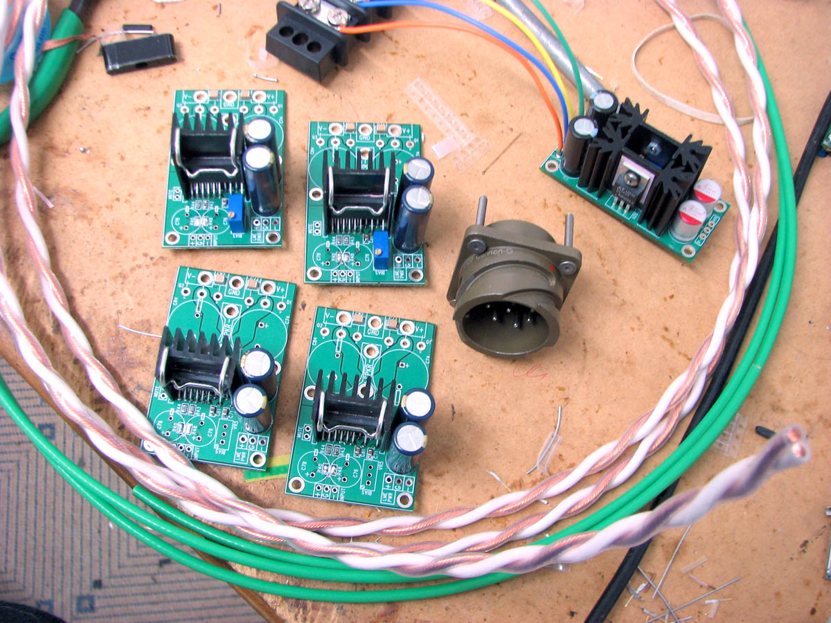

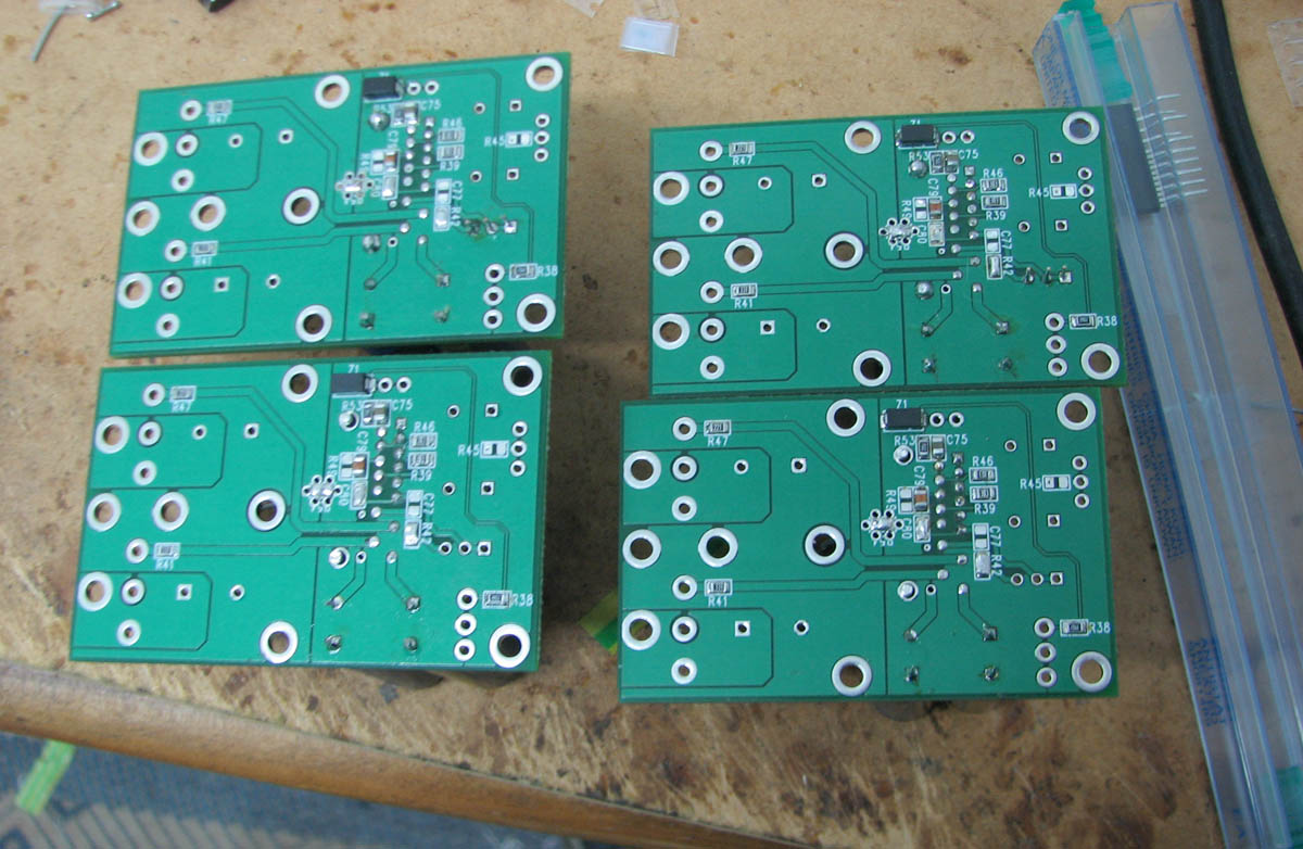

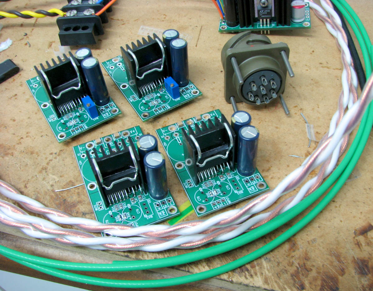

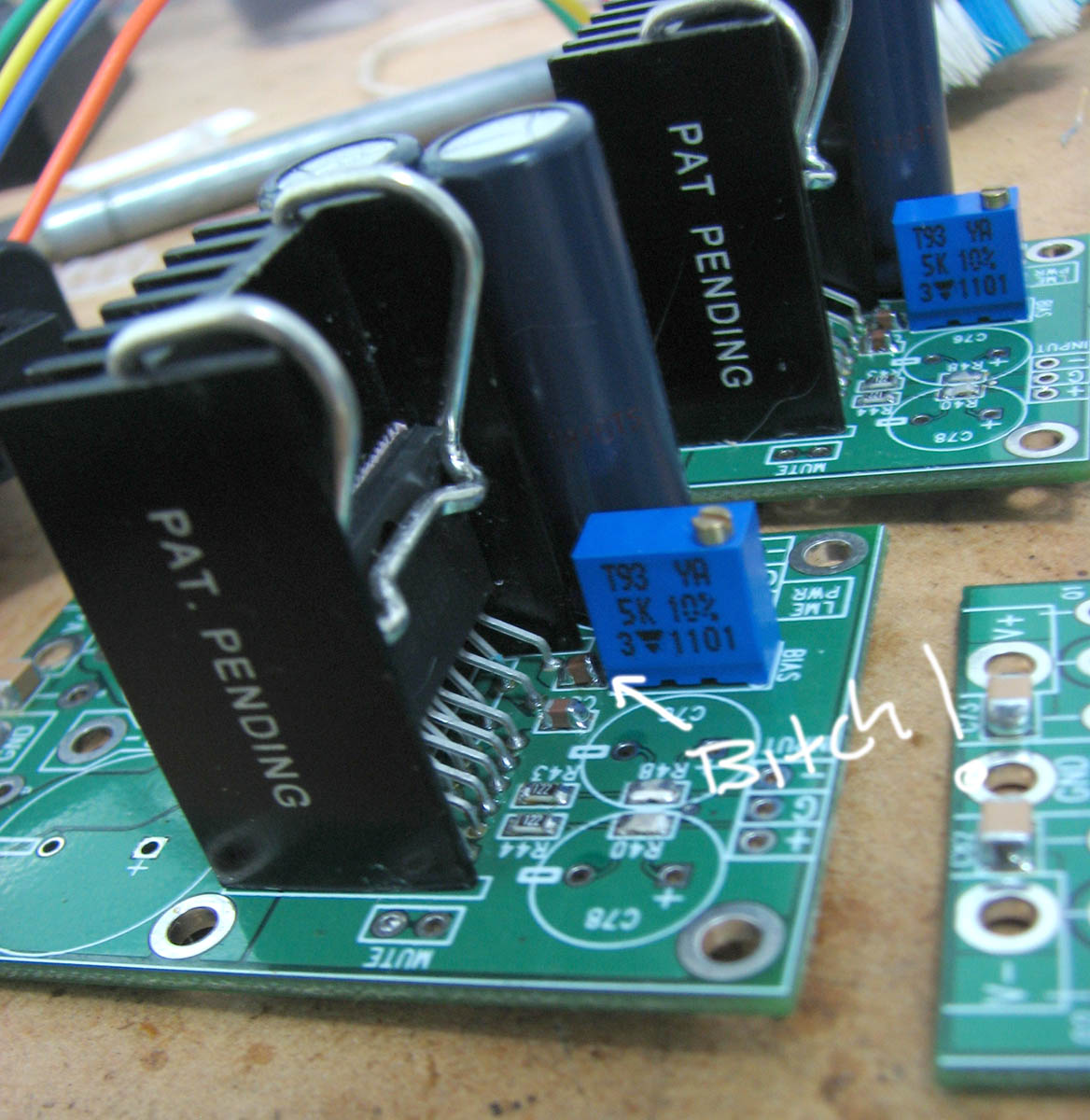

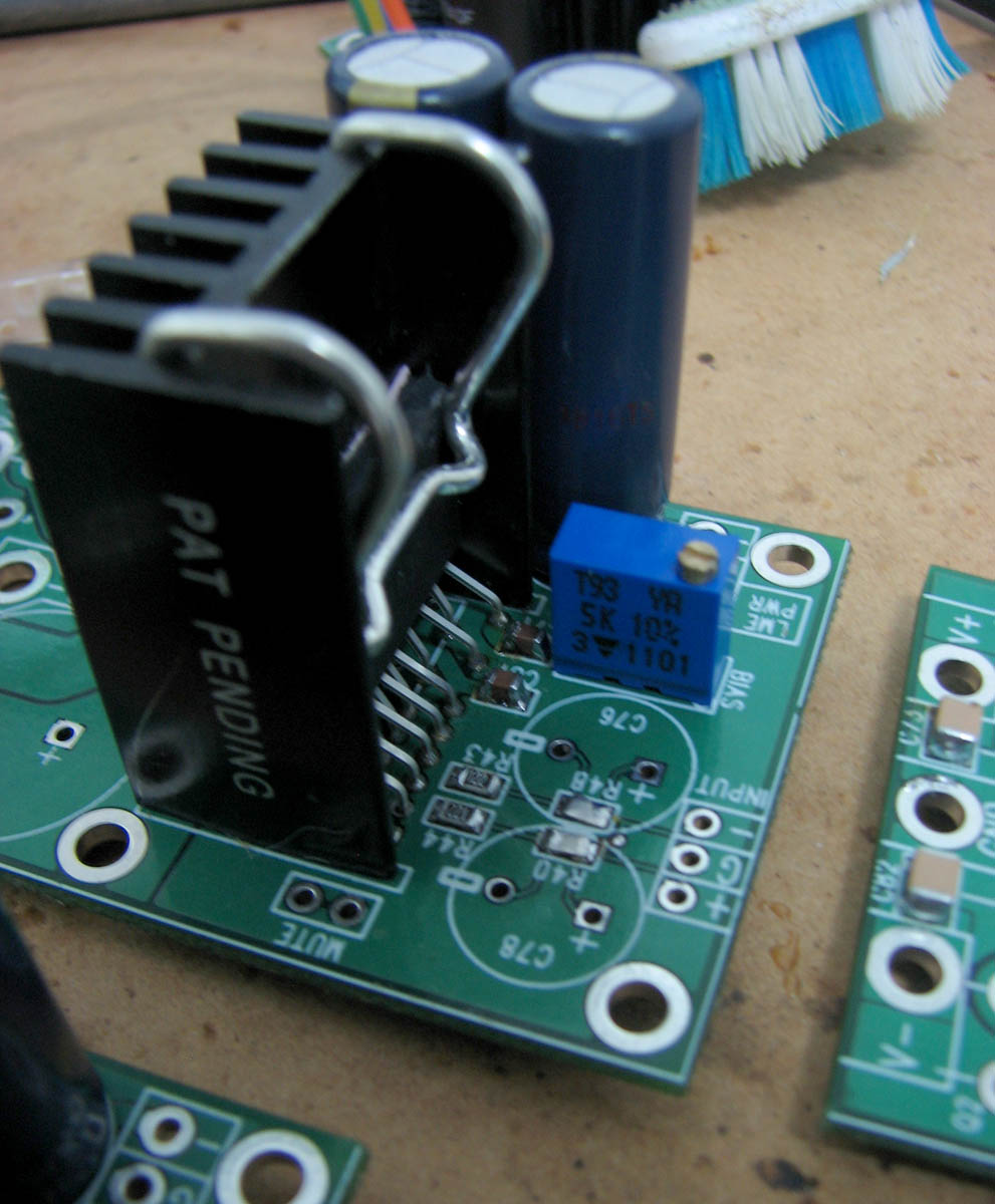

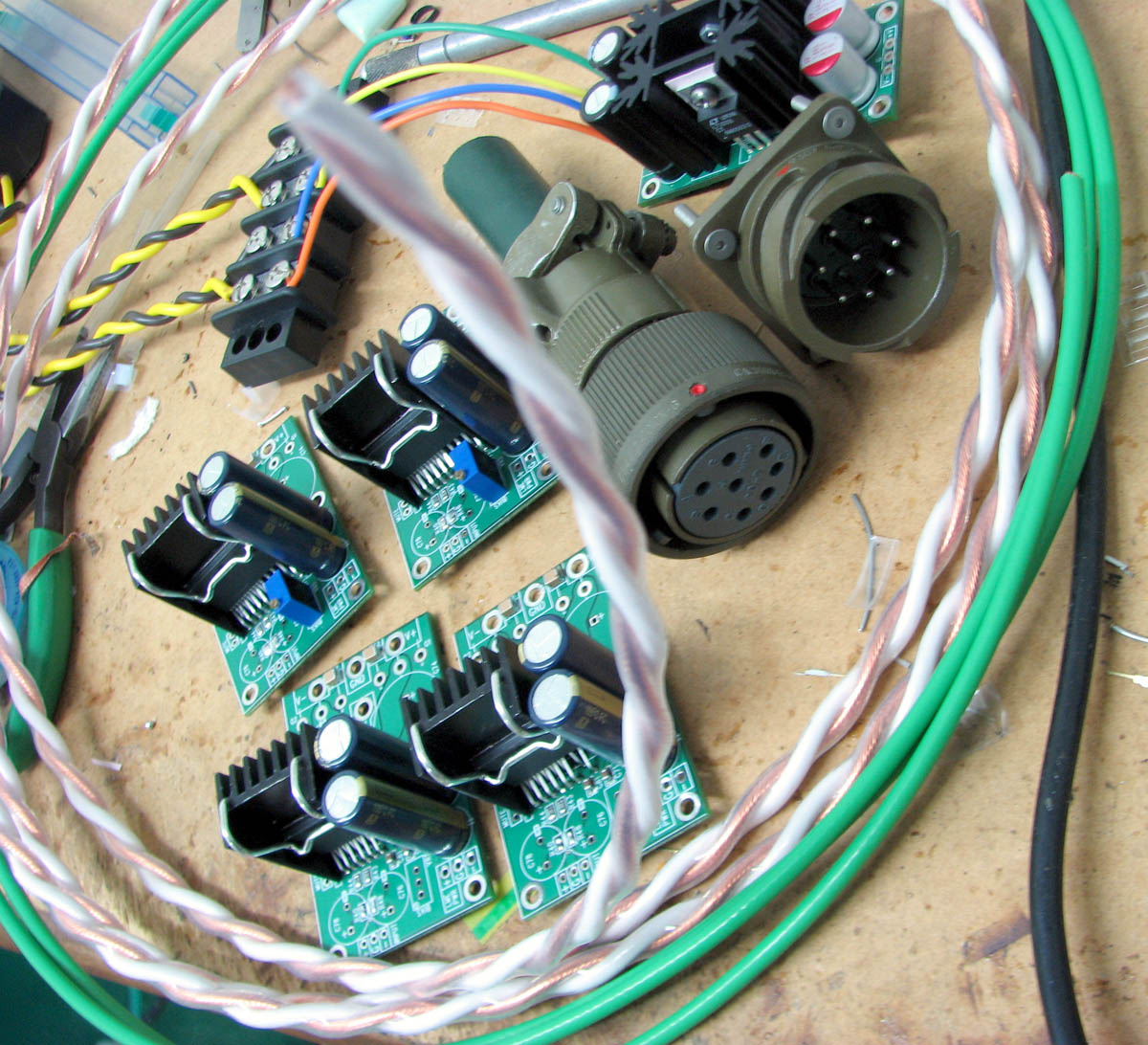

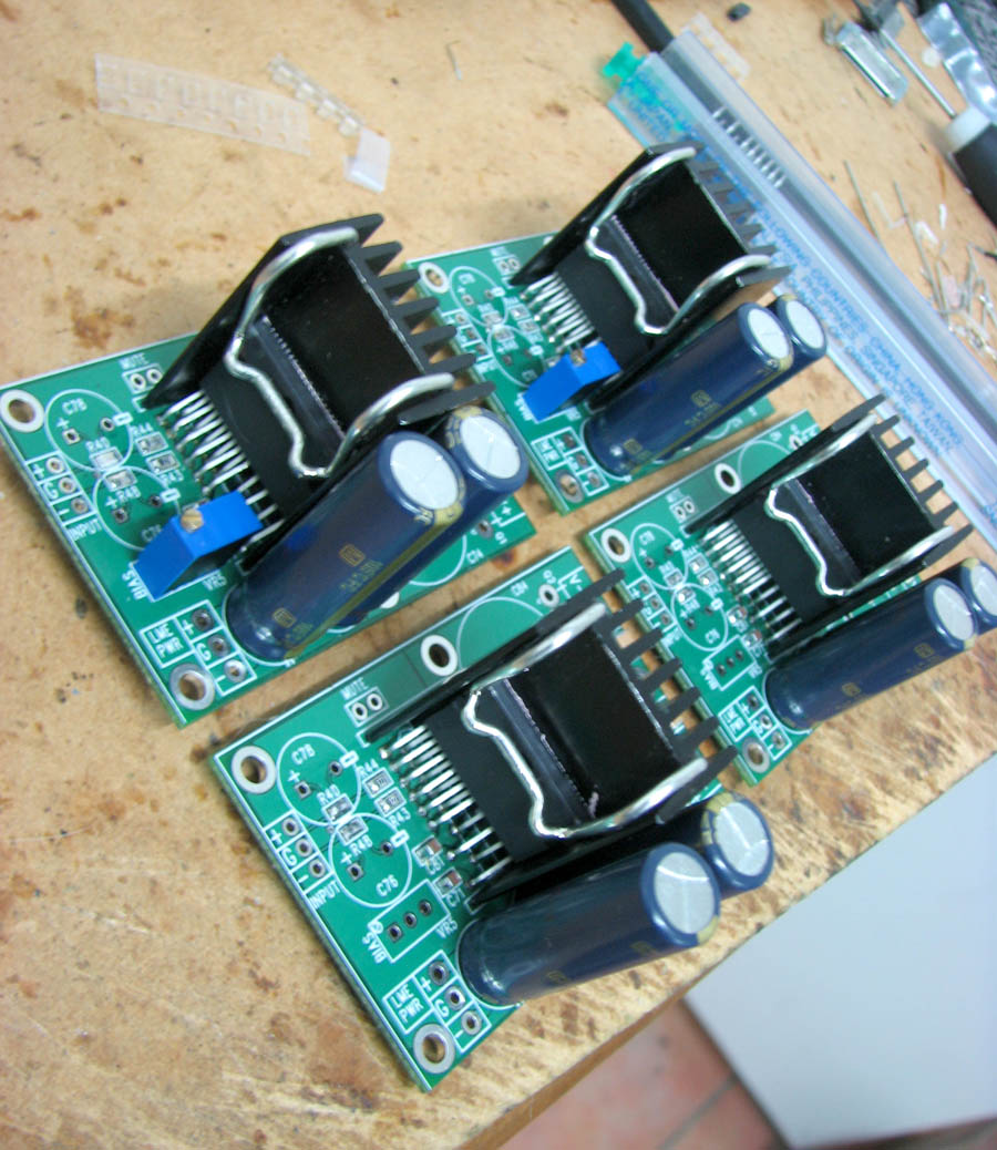

by popular demand (ok hochopeper)
so the first pic was the one i struggled with and ended up with that wonky cap, second one i managed ok after some more swearing and the others without the pots (which i wasnt silly enough to install as well before the caps) are the 2 i did correctly and are thus neater.
so all are setup for balanced DC coupled input and standard gain; i'm paused till i install in the chassis as i dont want to waste any of the rather chunky and excellent VHAUDIO copper in PTFE output wiring

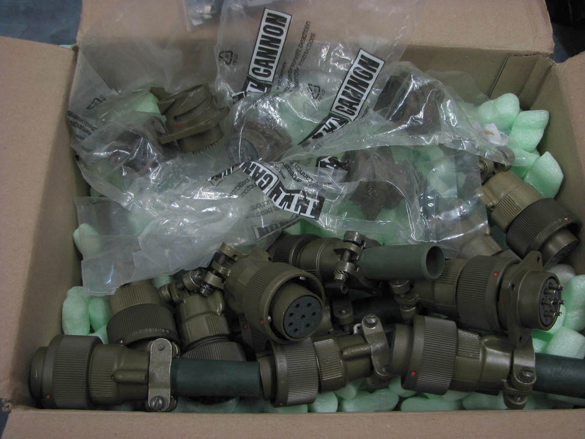

also in the pic the awesome OTT ITT Cannon Milspec connectors i'm using for the multicore speaker cables.

I'm sure that cap will add a corresponding curve to the frequency response. You are the only one to blame. Owen likes things nice a straight. You should really follow the guide lines and you will have a flat frequency response!
Hey I missed seeing this post qusp ... nice work!
Hopefully the mosfets start rolling out of the factory and this thread is flooded with pics soon! 😀
I know 😱 and surely the extra tin/copper/lead/silver in the signal path will produce such a vile colour to the sound to that i will want to blow my brains out!!
i shall turn this emoticon in on myself
it wasnt so much the result, as you can see i actually managed ok with that (although it does bug me a bit that its there), but the journey (my own doing) was infuriating
thanks AP2, i'm sure it'll fit nicely with your PSUs, which i'm almost certainly going to get, i talk myself into it more and more each day i just need to put the coin aside.
the cannons are indeed awesome connectors, i scored them here on the forum for a song; at farnell/element14 that single connector and panel mount pair would be almost 200 dollars and this box full of them..... nobody else seemed interested in them, or perhaps didnt know what they were, so lets say i did better than OK on the deal; I love this forum sometimes. they will be used for power umbilicals, speaker cables and even a joke balanced IEM/headphone cable 😀
the contacts are rated for 22A each at 2kV+

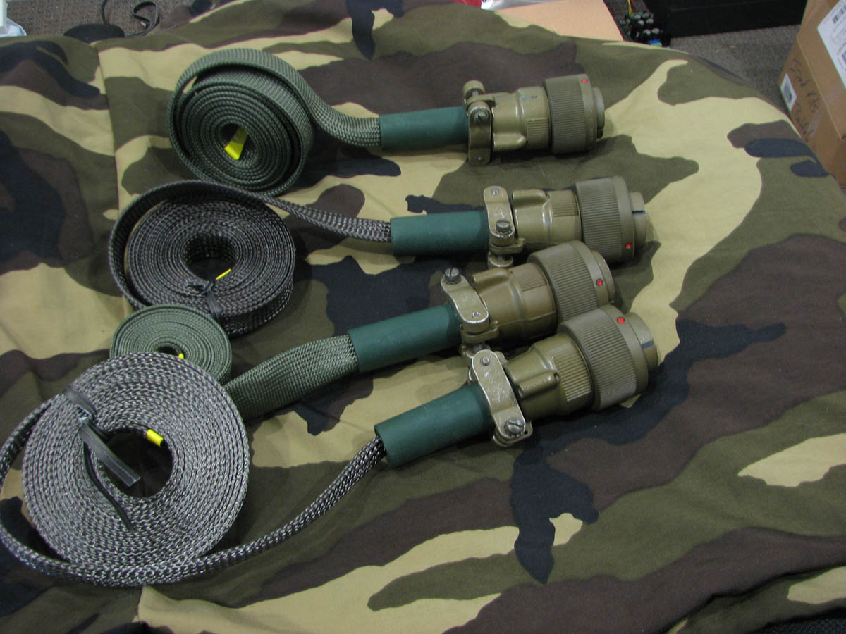

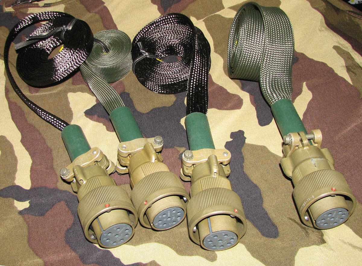

a little bit phallic =) but hey. shown below with matching carbon fibre or even their traditional milspec nomex sleeving.

woW! I have a passion for military equipment...i know well, I worked in the laboratories of Aeronautics and later I also designed some circuits. was a strong and beautiful experience working with brands really special. really very beautiful.🙂
Perhaps you also have military experience? hehe! .. what is.. the camouflage tissue under connectors? 😀
