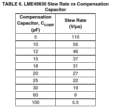

  1. Without a zobel filter from speaker output to speaker ground this amp isn't stable! (100nF in series with 10R)
  2. Try to add a simple and cheap 10pF or 15pF parallel to the current 20pF to check if oscillation stops till full bias range! Affects the slew rate too - but to find the error it is ok to try this. (attached picture from LME49830-AN1850 "snaa058a.pdf")
  3. If this doesn't help try to add C80 e.g. 100nF.
BR, Toni

setting the Cdom (Miller compensation cap) too high increases the feedback around the VAS/TIS stage. This reduces the OLG over a wider frequency range. It slows down the amplifier (lower slew rate) and carried to extremes can attenuate the high audio frequencies.
