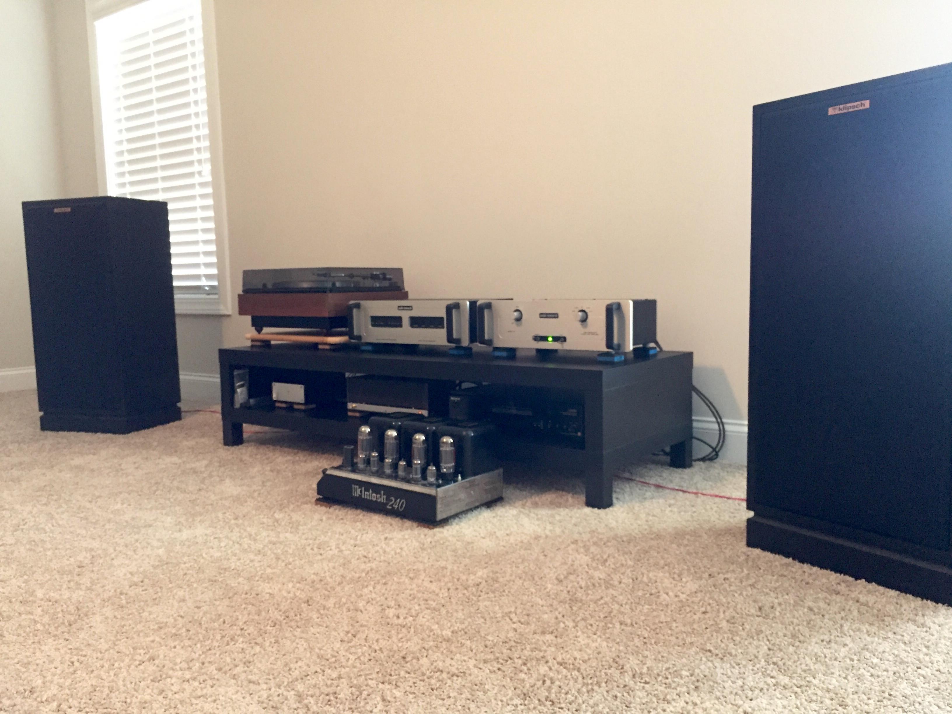

I haven't had a chance to try out my Weiner 2 PBTL amps yet. I moved across the country from the San Francisco Bay Area to the South Carolina at the beginning of the year, and we finally moved into our new home. I just hooked up my Weiner stereo amp, and it sounds fantastic. Surprisingly, it holds up well to my latest toy, a near-mint condition McIntosh MC240 6L6 push-pull amplifier that is in original stock form. The Weiner amp can produce a large and deep, room-filling soundstage just like the Mac and trumps it in terms of bass response. Where the Mac amp surpasses it is in the mids and highs. Once I get my garage lab set up again, I'll be able to work on the Mac's power supply (my guess is that those 60 year old electrolytic can caps and Sprague Bumble Bees are like ticking time bombs waiting to fail). I suspect then that the Mac will rule.
Anyway, I plan to implement my Weiner 2 PBTL dual mono amp using Cinemag input transformers as I did with my Weiner stereo amp and replace the metallized film caps with some film and oil input caps. I think those Coilcraft inductors will also give the PBTL amps the edge in performance.
I LOVE that old McIntosh amp. That thing could be the worst sounding amp on the planet, but I think if I had one of them I'd still use it as my main amp regardless because... well, look at it! Dim the lights so you can see the heaters glow, put on the Pink Floyd Ummagumma Live album or something with a bit of ambience, lay back in a comfy chair...

Gmarsh, I can tell you that the MC240 sounds as great as it looks, and yes, Pink Floyd does sound great playing through it.
