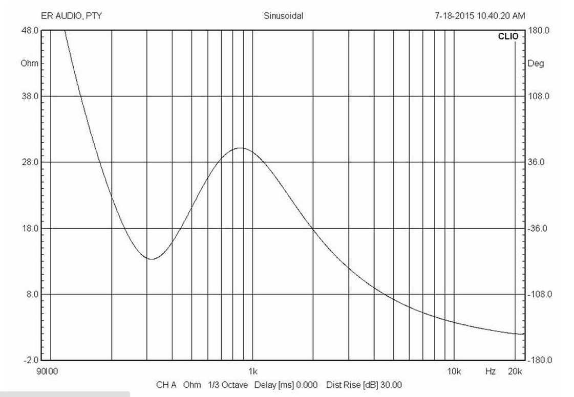

Hello Gmarsh,
I like very much my "The Wiener" and it sounds fantastic with my dinamic speakers, creating a wall of sound that I really like.
As wrote in other messages, I also use it with my electrostatic cells:
Mini Panels
that works from 200hz to the top end but there are a lot of problems of resonance and the sound have some distortion.
I've the 8 ohm version.
Now Rob Mackinlay from ERAudio have sent me the impedence reponse that I've attached.
Do you have any suggestion to solve my problem?
Thanks for your patience.

That's an ugly load for a class D amp without post filter feedback. Try putting around 2 ohms of series resistance between the amp and the speakers - this won't be a perfect fix, but if it gets rid of resonances then at least it's a clue.

That impedance looks ok, highpassfilter around 300 hz. Your panel has identical components for filter?
Hello,
my high pass filter was a bit differet, orginal was a 6 db/oct with a 10uf serie cap, impedence graph was with this configuration.
I use a 12db/oct with an LC filter using a 5,6mH inductor and a 33uf cap tuned at about 220Hz.

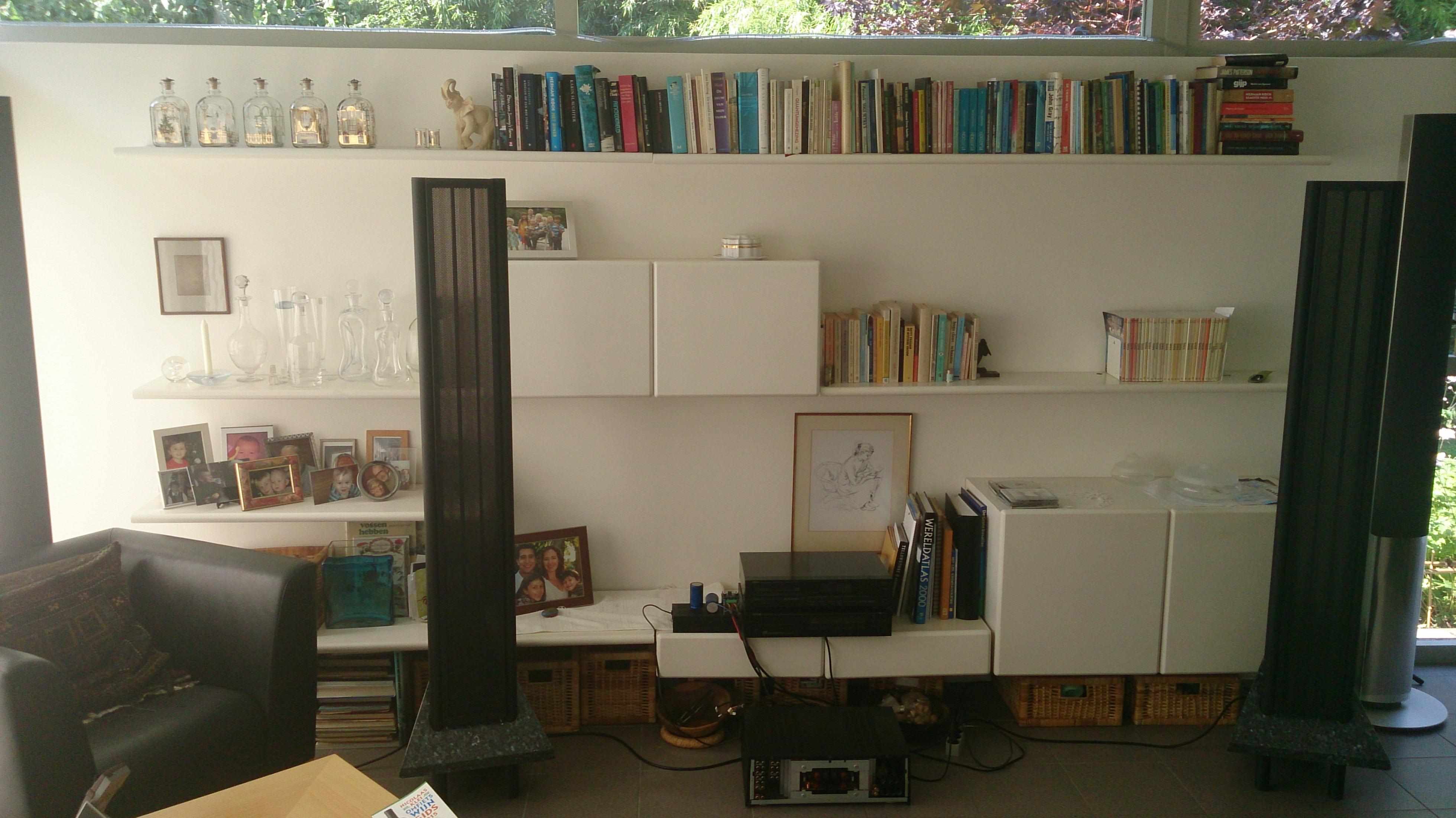

Hadn't tried this 3118 with electrostatic hybrids, but some failing blue Elna's gave the little Wiener a shot at fame. it is above the PSU next to the cdplayers, you see the green Phoenix terminal, probably. The blue Elna's for size next to little amp 🙂
No problem whatsoever, better bass than "failing" amp, better treble too, can reach serious level with the ~80dB speakers more easily than "failing" amp too, which is (was) specced at 2x340w @2 ohm.
So better try with removed coil/cap I would say, outputfilter 3118 here for 4 ohm btw.
