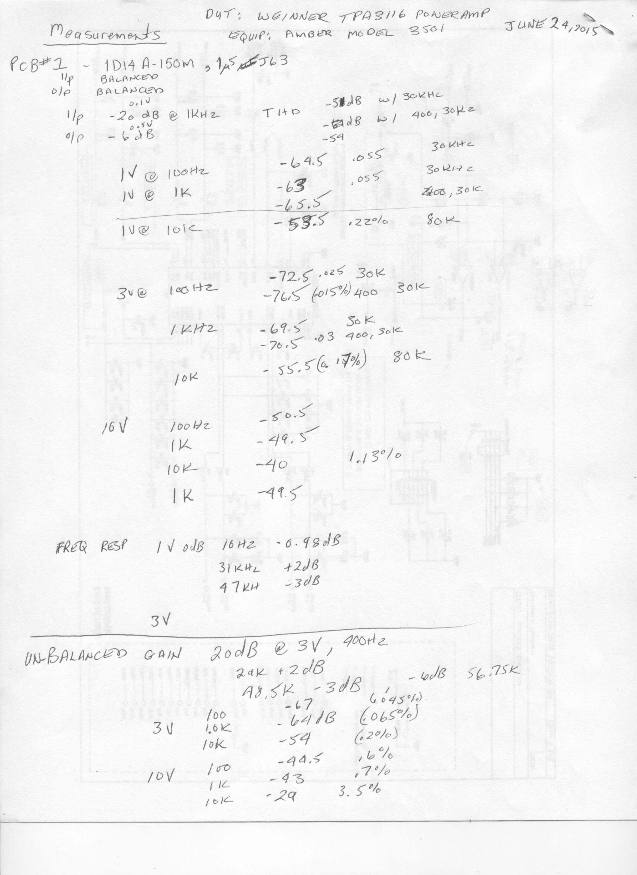

Okay, here are my measurements, I took on one setup (8ohm). I scanned in the test sheet, hope you are okay with that. Oops I wrote the pcb name wrong on my test sheet 🙂

Seems to be good data, nothing really stands out when compared to the device data sheet. Balanced i/p seems to do a bit better, not exactly sure why?
I did not do a noise test as I do not have a jig (LNA) for that. I guess I could try the HP 3478A, it is more sensitive but has no filtering.
The 3V spec looks really good, for a class "D", the 10V tests, well this is area where you really wonder about sound quality. But listening to the amp there seems to be little distortion until you crank it. For normal listening levels these are great little amps.
Sound wise the Weiner TPA3116 sounds about the same as my TPA3100 design. Maybe a little more low end punch, for obvious reasons. I have to do some more listening testing. Even on my FM radio(Si4735) it sounds really good.
Another oops, forgot to write down that I used a Micranta(24V/1A) linear bench supply running at 24VDC. Gain set for 20dB,AM0-Mode all off, Left channel tested with Dale RH-25 8ohm/25W load. Right inputs shorted with a 8 ohm load.
Gary, if you want anything else specifically tested just let me know before I tear apart the setup. Okay time for lunch 🙂
