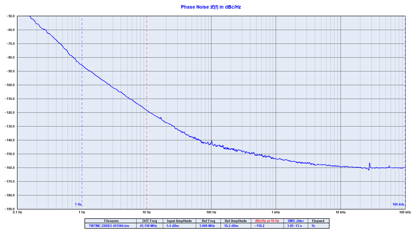

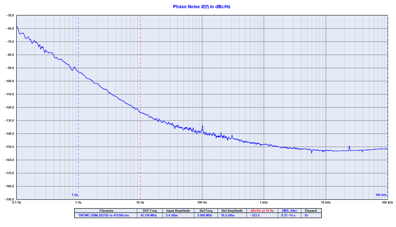

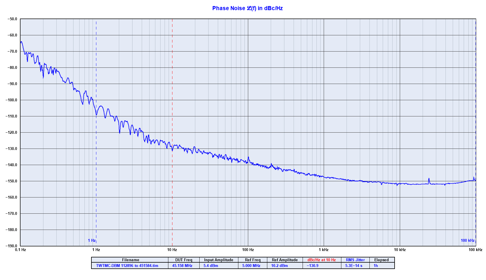

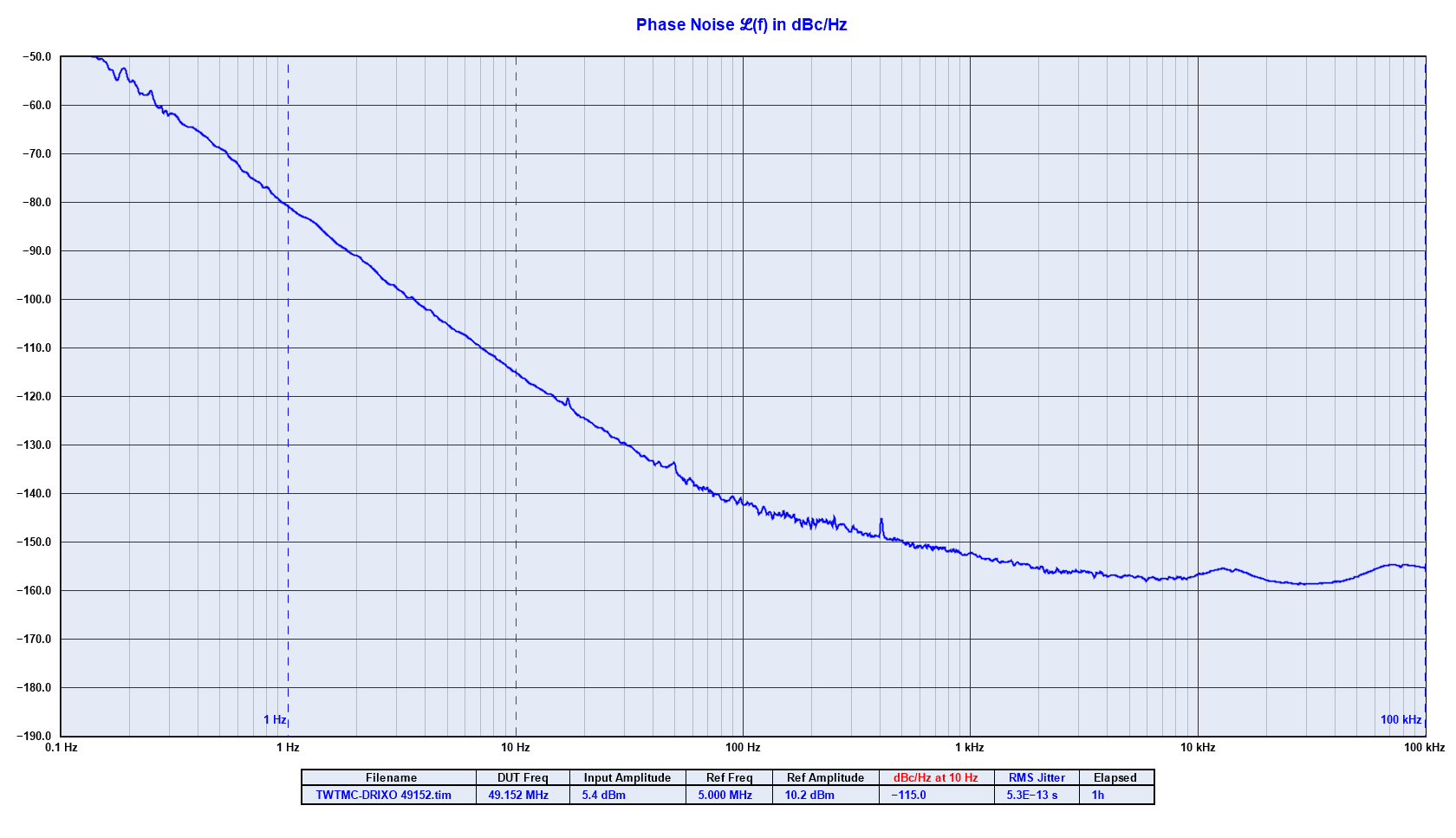

Quite a few phase noise measurements were published. Not sure about 45-49Mhz, but I think there was something. Pretty sure not for 90-98MHz. Best phase noise for 45-49Mhz is probably to start with 11-12MHz crystal oscillators then use two frequency doublers, followed by squaring to make digital clock pulses. The maximum number of doublers is two, so if wanting 90-98Mhz then you would have to start with 22-24MHz oscillators. By that point phase noise is starting to get significantly worse however. At 11-12MHz phase noise is still quite good.
@caad:
Some phase noise plots of 45/45MHz clocks have come into my possession. They are of the following:
  • DRIXO 11.2896 MHz to 45.1584 MHz (2 frequency doublers)
  • DRIXO 22.5792 MHz to 45.1584 MHz (one frequency doubler)
  • DRIXO 45.1584 MHz
  • DRIXO 49.152 MHz
Descriptions are in the notations at the bottom of each pic.
Please see attached...
