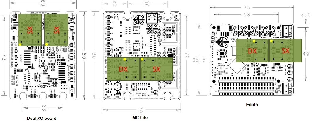

TWTMC-STS Sine to square converter and Ian's FIFO
I attach a picture that explains how to connect the squarer to Ian's FIFO stuff.
If you are planning to install both clocks then:
- Dual XO board needs 2 x TWTMC-STS-SX
- MC FIFO board needs 1 x TWTMC-STS-SX + 1 x TWTMC-STS-DX
- FifoPi board needs 1 x TWTMC-STS-SX + 1 x TWTMC-STS-DX
If you are planning to install a single clock I believe you can use one or the other indifferently, but please ask Ian to confirm.
