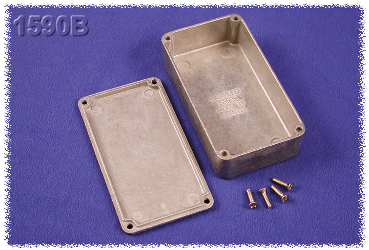

For DRIXO board connectors J1 (oscilator), J2 (power) must not have common ground? And which of them must be connected to aluminium case? Or they both must be isolated from case?
The Hammond box is anodized so the connectors are virtually isolated.
The ground of J1, the oscillator output, should be connected to the aluminum case so you should scratch the front panel around J1 to get electrical contact.

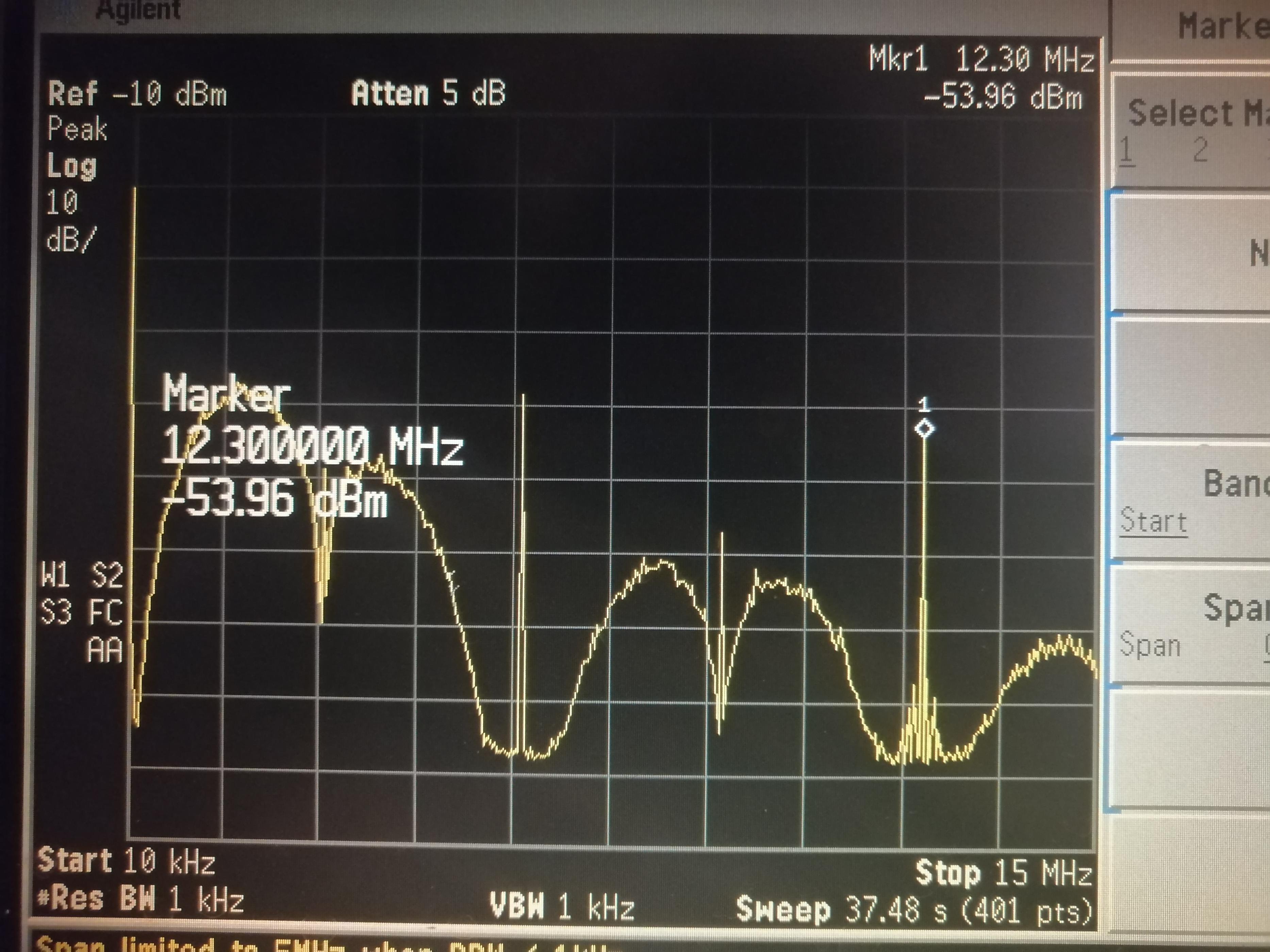

What is the actual output frequency in a DS dac?
Audio signal is definitely not, it's just another modulation.
Last year, after I had repaired our E4407B, I had it home a while. Had done a series of screenshots of the 4499 output, just after I/V, so only a first order bland filter.
In this shot it's in PCM mode, probably (bad documentation) just 44,1k or 48k native.
The center frequency component is 6,15MHz, the marker is on the 12,30MHz harmonic

This one produces a rather irregular pattern of bits or short words at a rate of 6.144 million per second. If it were a regular pattern switching back and forth between two numbers, the frequency would be 3.072 MHz.
This is why I'm asking. in this DS dac this ratio is fixed for all audio signal frequencies..?Up, I think, as the ratio from the clock to the output frequency gets smaller.
Also, it is much smaller than if it were the actual audio freq. So higher modulation factor from the clock phase noise? And constant..
This is why John talked about basically no attenuation for the DS clock phase noise?
Thank you Andrea for answer! So J1 (oscillator ) must be grounded to case and J2 (power) no.

I'd say you can still see the rather irregular waveform coming out of the sigma-delta modulator as a superposition of many frequency components that all get phase modulated, the higher frequency components more than the lower frequency ones as the shift in seconds is the same for all. With close-in noise, the desired audio frequency component is then the only part that gets sidebands in the audio frequency range. Maybe I'm wrong, but I don't see how.

Hello,
I am happy i got a so called stomp box from Hammond or one of its almost one one copies on the internet.
There is no anodizing and no need to scrape of that surface which is rather '' difficult '' to do it right. I mean if you want the best contact possible.
As you can see there are two parts and the way they are connected will make it function much more like a '' perfect screen ''
The material is a big thicker so you can even add some threaded holes ( M3 or M4 is very well possible with this thickness)
You can go over the top with screening these circuit it seems as i read how critical everything is.
On top of you can create an almost airtight box ( if you add a rubber grommet around the power input connector)which is good for airborn vibrations.

There are no issues with the Hammond box Andrea recommended that I have seen. Once you tighten the SMA nut where there is a start washer between that and the box, the electrical contact is made.
The star washer digs into the metal and all is good no need to scrape I found.
Yes, you are right, I forgot the SMA connector washer.
Hello Simon,
Depends upon the quality of the anodization.
There are many '' types'' I have made objects for the military that would need more than the washer to be removed.
AND usually these small connectors cannot stand the torque necessary to grind to the surface. SO better use a tool to do it.
