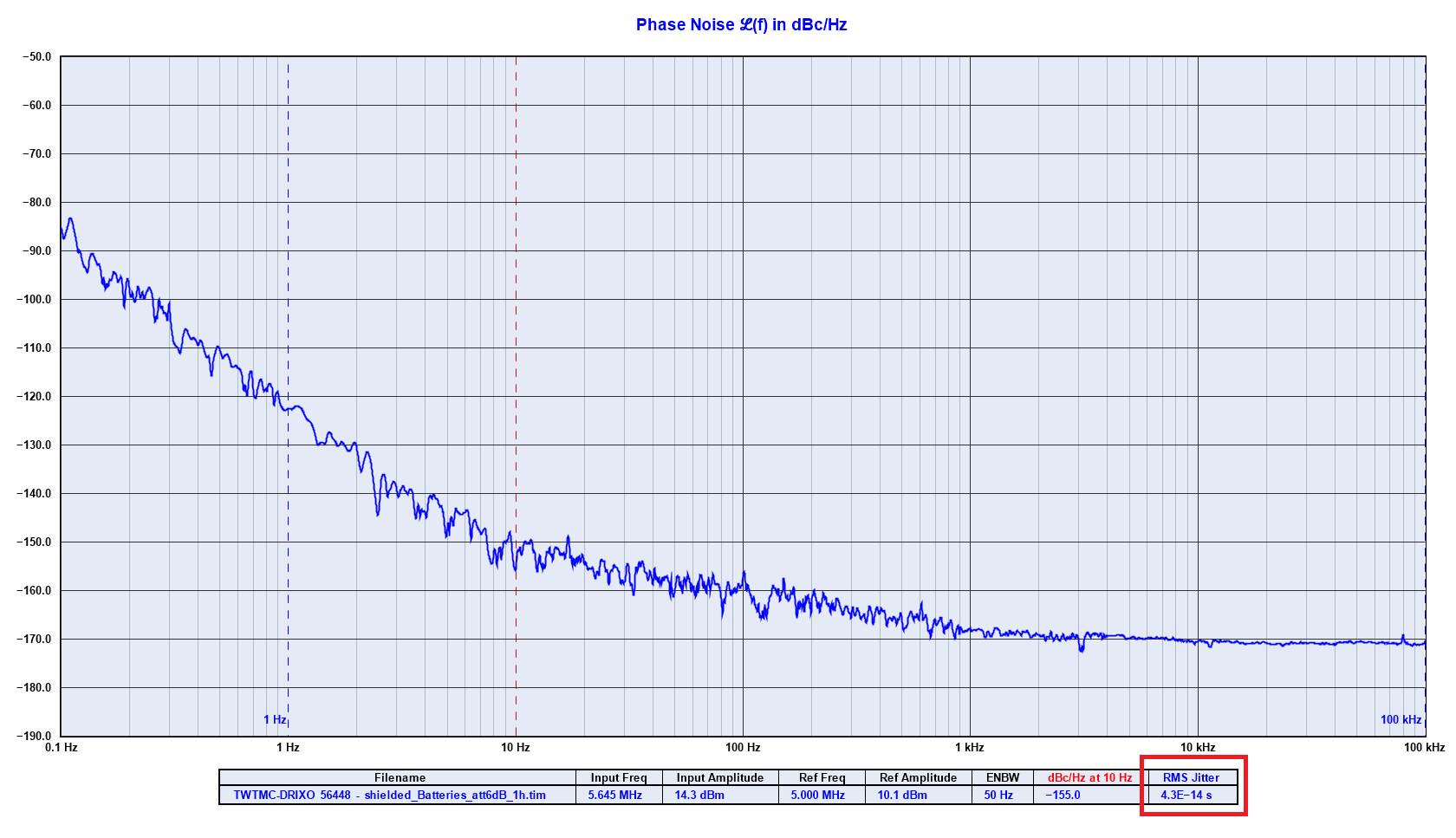

Ovidiu (syn08) still keeps confused, now about clock transmission.
1 meter coaxial cable with SMA connectors from the oscillator to the measurement gear creates a lot of jitter, even 43 femto seconds!
What a bad jitter performance!
A good 50ohm cable with RF connectors, matched properly, would not be a problem. After all, such cables are used at GHz frequencies, even at 100GHz with 1mm specialized connectors (you don't want to know how much they cost).

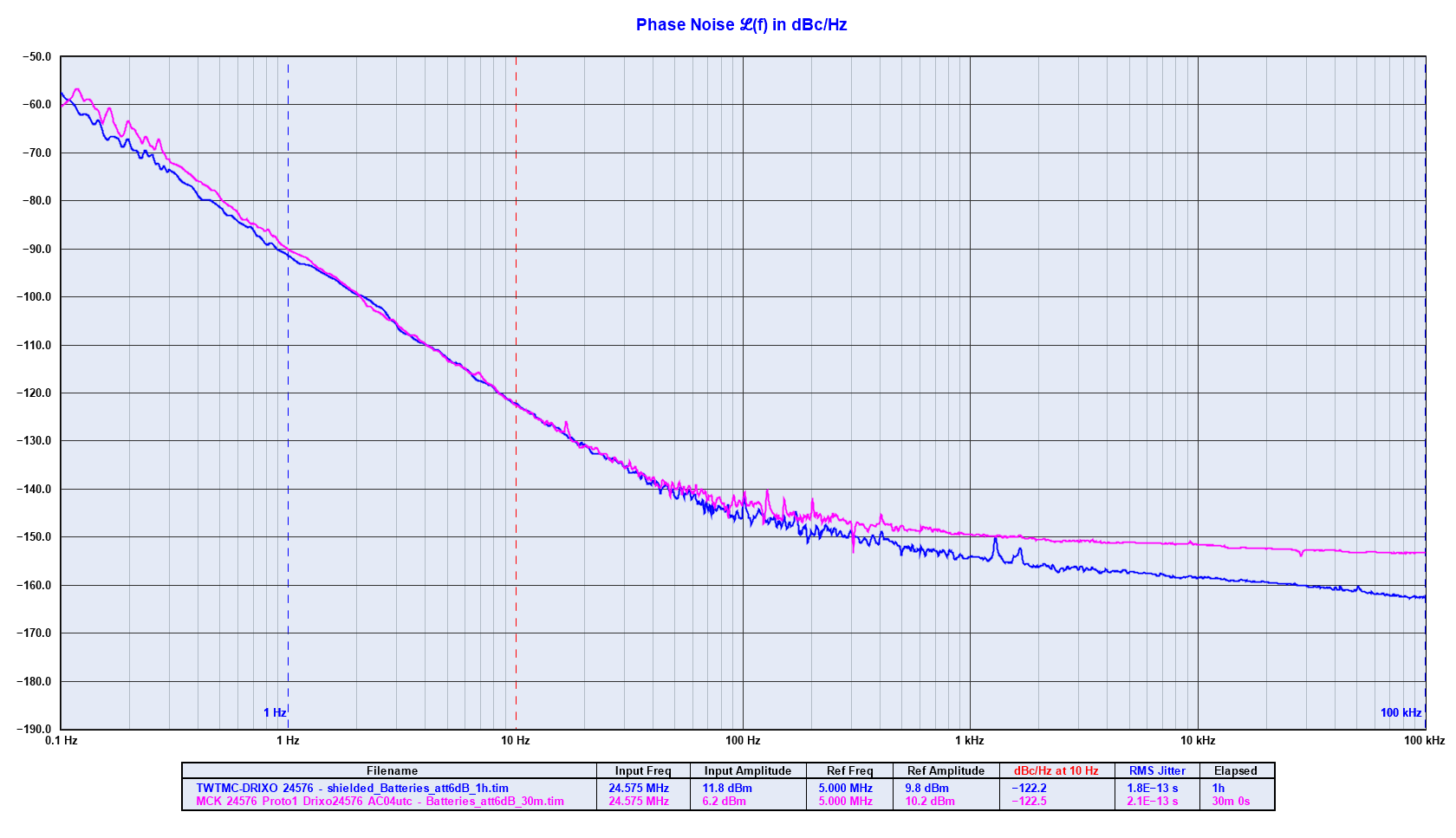

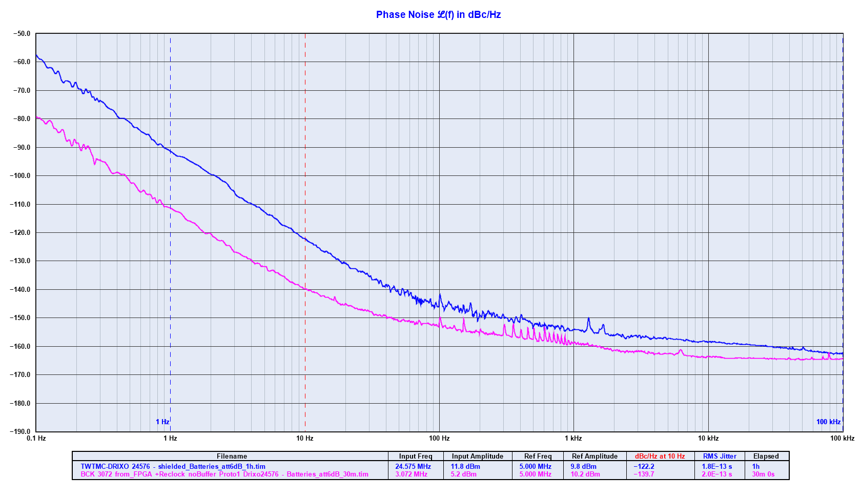

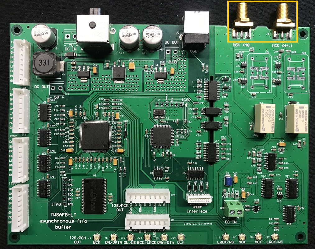

Hi Ovidiu,
just like in the first picture.
Then the second picture is a reclocker board connected to the FIFO board with u.fl cable, while the oscillators are connected with SMA cable to the FIFO.
Third picture is the phase noise comparison between the external oscillator and the MCK output of the FIFO board (after sine to square conversion).
Finally the last picture is the phase noise comparison between the external oscillator and the BCK coming from the reclocker board (after sine to square converter and u.fl cable).
Practically there is no added jitter, only a little noise floor, still below -150dB.
I hope this helps to understand.

Not asking about yourself, although I see you are using series resistors to (as much as possible) avoid reflections, that's far from "matching". Asking about your average customer who purchased your supa-dupa clock boards. They have a DAC board of unknown source, they are routing your clock into, replacing the on board oscillator/clock. Assuming a decent (say) Crystek on board clock, this surgery can only worsen the outcome, this is what the article describes.
Which is precisely the article point (noise floor is the direct result of additive jitter). It may be low enough, the point is, have you compared the noise floor of a decent (again, say Crystek) DAC on board clock noise floor with the resulting noise floor of your supa-dupa clock routed to the same DAC board? Can you guarantee that by using your clock boards, any DAC it is feeding won't have a post surgery worse noise floor?
Now, please, don't tell me the noise floor doesn't matter for audio...

Within the limits of our DIY hobby skills, we do actually give some thought to these things. The Iancanada FIFO design provides impedance matching to 50ohm cables. I use Ryanj's GB PCB for a TDA1541a DAC where he went to considerable lengths to design a 4 PCB that also provides the required match. Yes, we end users of these subcomponents are merely assembling a digital LEGO set, but the choices on subcompnents, PS(s), I/V, buffer, layout, chassis build are also all part of the hobby. Pretty rewarding actually.Even so, those boards (FIFO and others) do have to be somehow integrated with the customer equipment (say, a DAC board). You are selling a product, you may want to guarantee to your customers some end-to-end performance metric.
Andrea did in fact provide a performance claim. He showed extensive measurement of phase noise as he developed each of his PCBs and even offers to run a test of the individual board/crystal for a nominal fee. Not much different from ordering any component or subassembly. At some point it is Caveat emptor. This is DIY and not every bit will be a winner. This one is.
