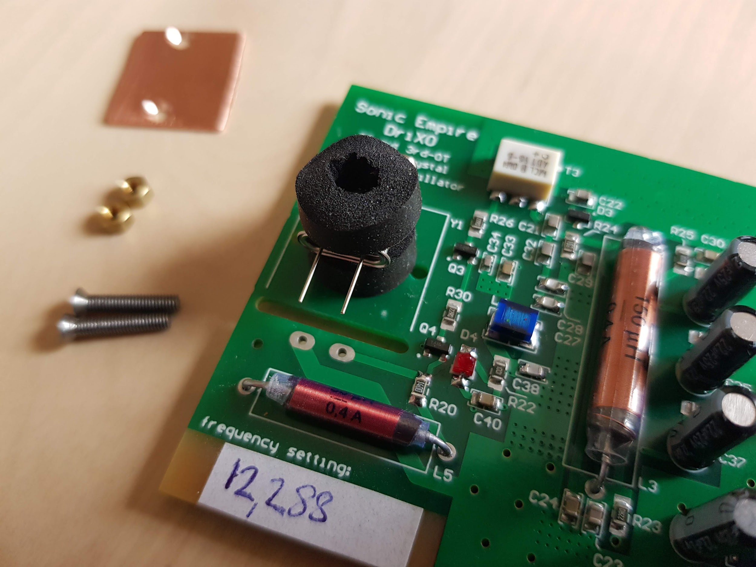

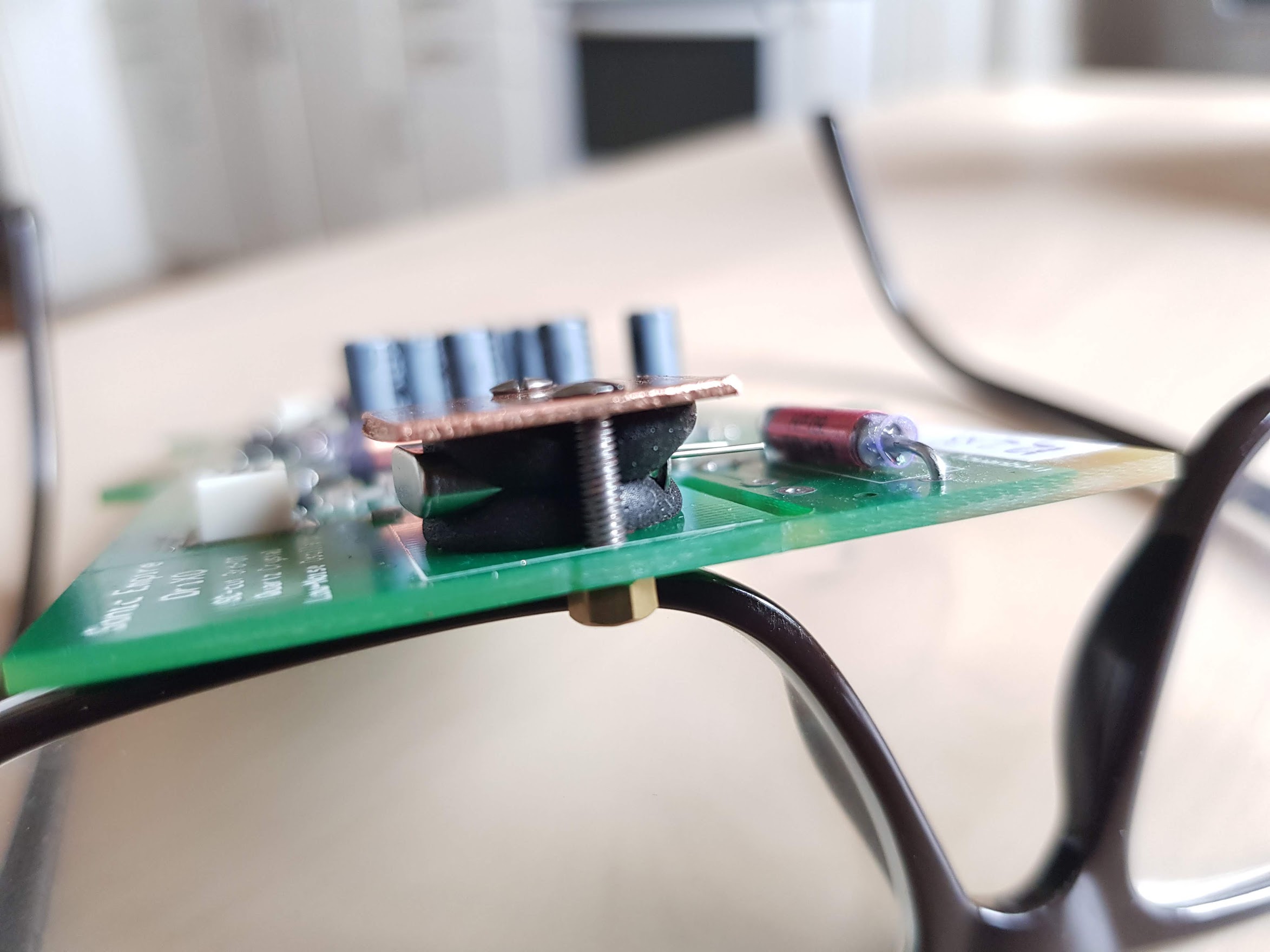

@ all : plus the Hammond box and the "wool" wrapped around the pcb in it, how you guys take care of the close surounding of the crystals, please ? I mean what is the simpliest casual but good enough no placebo to proceed?
Acrylic gel is not for everyone, while it seems sota. I like the earbuds foam way too. How about rubber bands on the crystal can and cotton caps tube for the leads ? Finally how to putt the Hamond box in the cabinet for people not having measurement tools to benchmark the accurate layout strategy ? On foan, on rubber band ? surrounded by corck layer or ... ?

I attach the images of my take on crystal vibration damping here:

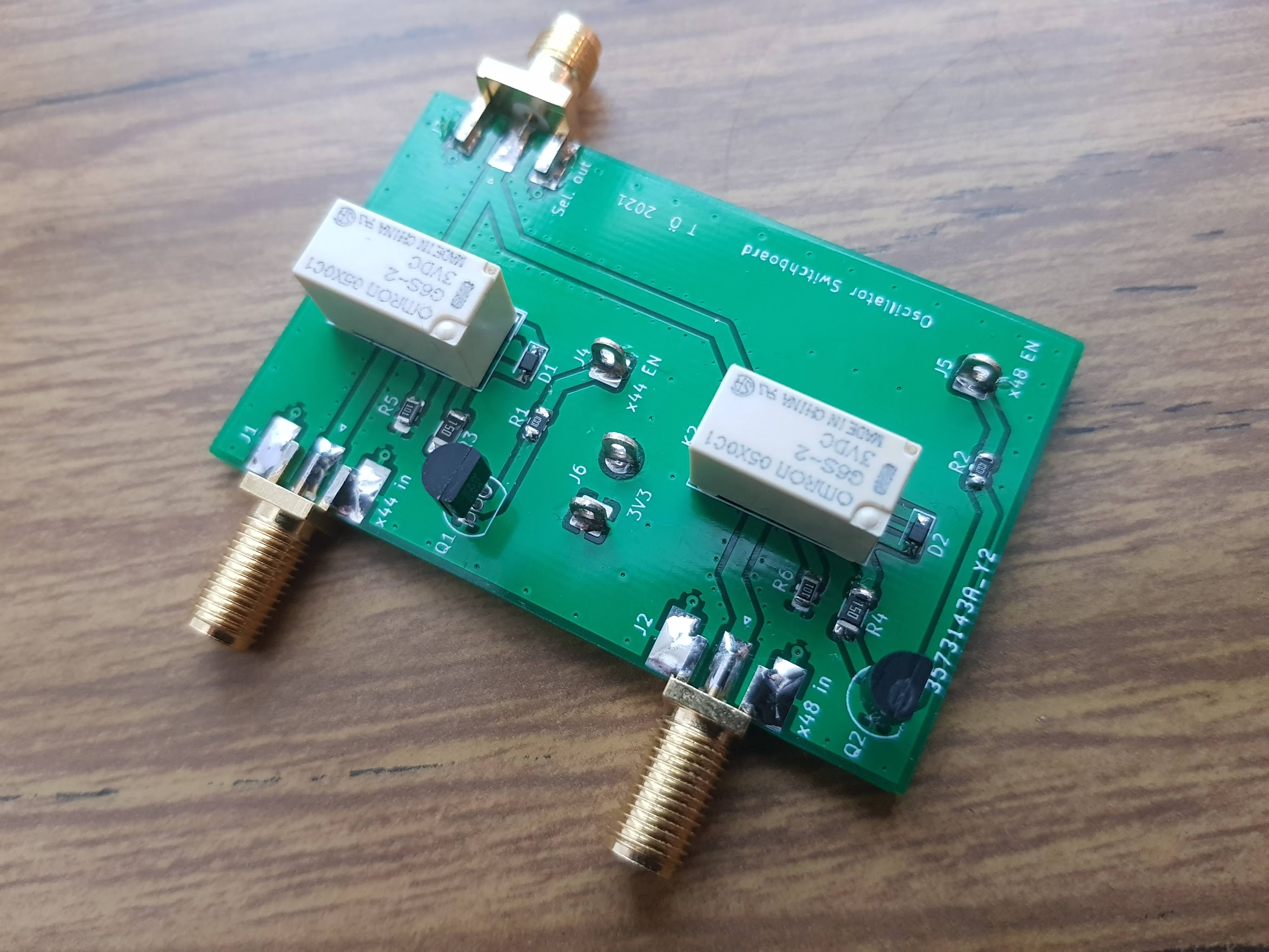

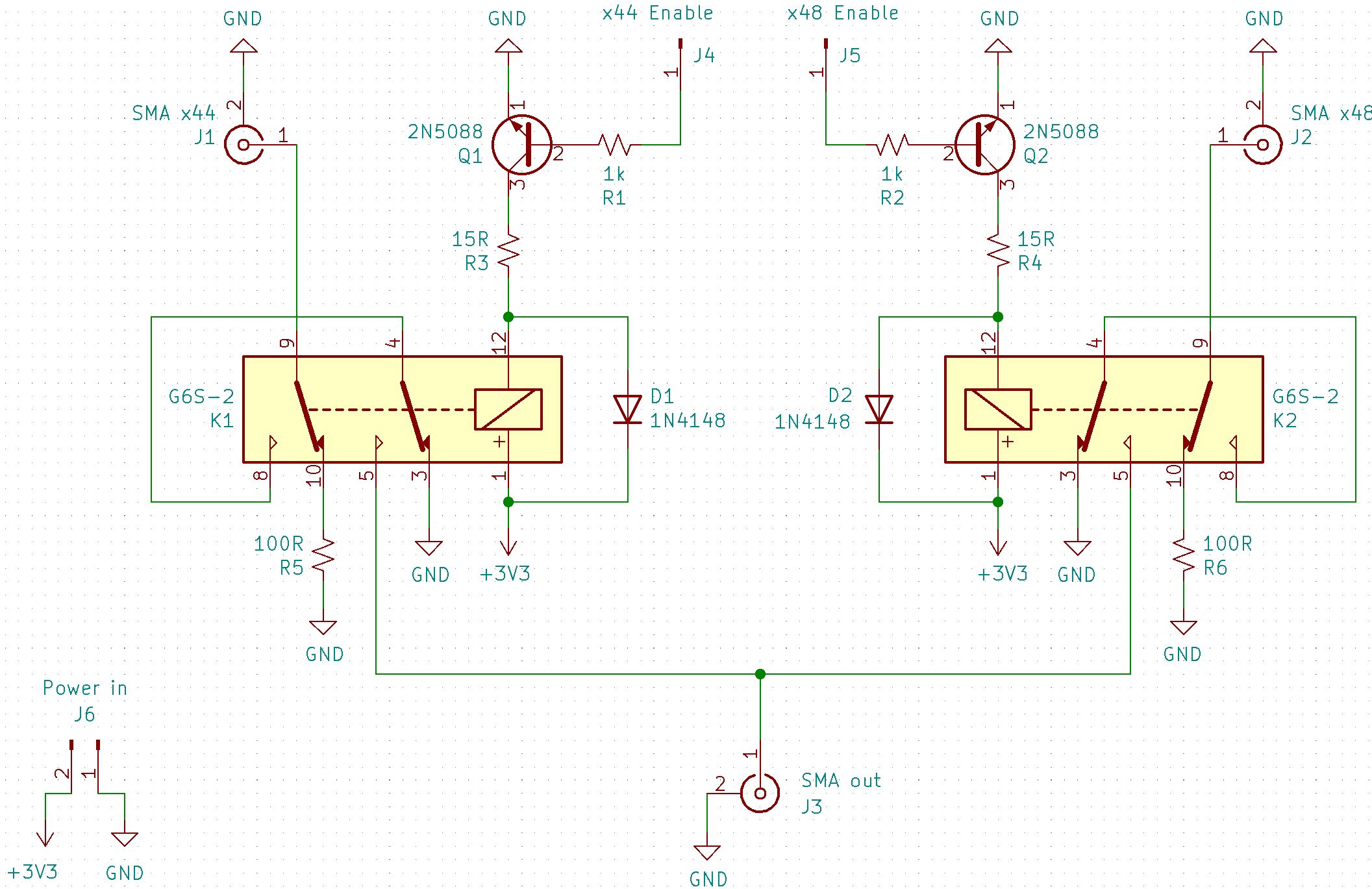

I did pretty much the simplest possible circuit, just a nonlatching signal relay for each clock. The activated relay will need some 40 mA. Did not have the space for Andrea's switchboard within my DAC so I made this and will combine it with one of Andrea's squarer boards. If it fits in your application I have a small number of leftover boards, I could send you one if you want to try it out, just PM me.
dddac,
one or two things that may be worth checking.
better to switch the coil with positive voltage and keep one side grounded.
the positive side can be bypassed with a cap also to gnd.
that ensure a path towards ground and let the coil act as a shield.
an RF relay, while more expensive, can ensure proper impedance matching.
What is the startup time of these oscillators?
I mean, two oscillators with an ENABLE input each would remove the need for switching...
The 5/6 MHz oscillators need 5 to 10 seconds to start.
There is no way to put them in high impedance state so the only option is a relay.
The Enable pin could be implemented after the conversion into square wave using a LVC1G126 but it will add noise.
Oscillators need time for jitter/phase-noise to stabilize, which can at least be a few days. IIRC some measurements indicate it can take weeks. For some clocks at least, using the built-in enable/disable function is just as bad for jitter as powering the clock off. Gold contact signal relays don't seem to have that downside.
In addition, listening tests were done here to find out if clocks audibly interacted with each other if switched by signal relays. A disabled/powered-off clock and one live clock, was compared with having two live clocks switched by relays. No audible difference was detected, at least not with the present state of the dac.
