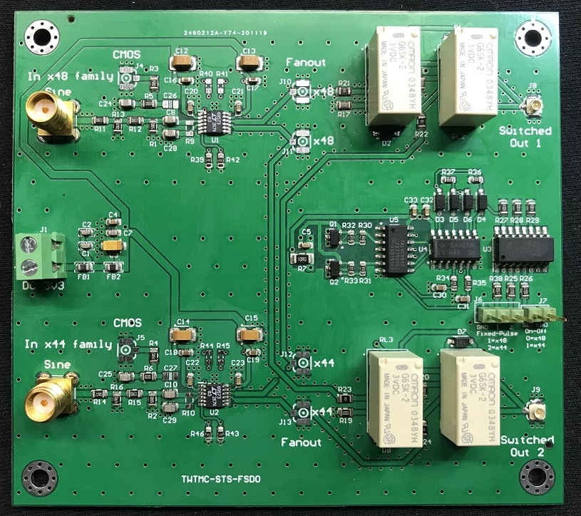

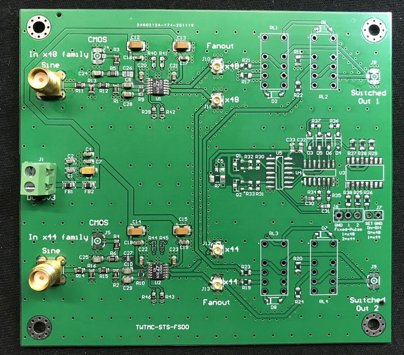

TWTMC-STS-FSDO
The new double sine to square converter with fanout and switched output is ready, pictures attached.
The first board is the TWTMC-STS-FSDO-F, it has 2 inputs, one for each sample rate family (sine wave or CMOS) and 4 outputs, 2 for each sample rate family.
The second board is the TWTMC-STS-FSDO-S, it has 2 inputs, one for each sample rate family (sine wave or CMOS) and 2 switched outputs between the two sample rate families.
Can the One TWTMC-STS-FSDO-F 2 inputs be connected to 2 TWTMC-PXO-AIO with the AT 6.25MHz, so each output 2x 25MHz, totally 2x2=4 25MHz outputs?
Is a TWTMC-STS-FSDO-F much better than a TWTMC-STS-SX?

Yes, you can connect 2 x TWTMC-PXO-AIO with the AT 6.25MHz to one TWTMC-STS-FSDO-F so the output is 25MHz x 4.

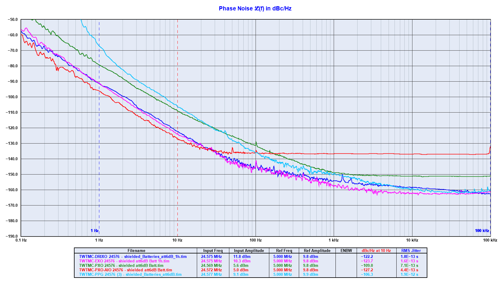

The TWTMC-STS-FSDO theoretically has better phase noise than the TWTMC-STS, at least from the plots in the datasheet of the LTC6957. We will measure it soon.
The comparison plots I have published seem to confirm that the TWTMC-PXO-AIO is around 5 dBc better than the Driscoll at the same output frequency (see the attached plot at 24.576 MHz, very close to 24 and 25 MHz).
