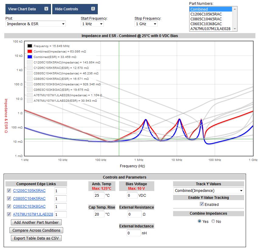

This is my bypassing simulation w/o and with the output caps of the voltage regulator. Hm.... not so good, with some antiresonances. Unfortunatelly I can't simulate a ferrite bead or lead inductance there...
This may help your understanding: https://www.edn.com/bypass-capacitor-resonances/

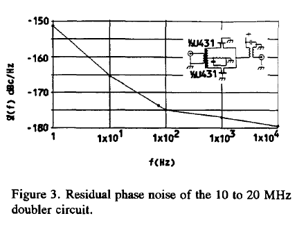

I found this picture from a NIST publication in a quiet corner of
my hard disk, I can't tell exactly where I got this. It was not an
article on doublers, it was an add-on in the context of something else.
It was said it would perform even better than Wenzels doubler and
one degeneration resistor per transistor might be slightly better IMHO.
I have used it with BF862 in my Lucent 5-> 10 MHz doubler
but never really measured it. Same for my oven support board,
with BJTs.
U431 was(?) made by Siliconix.

Other sites have reference to these dual Jfet Freq doublers. However I didn't
realise the phase noise was so low. Thanks for that.
There are a few jfets that would most likely work, the U431 is still available
but it is expensive.

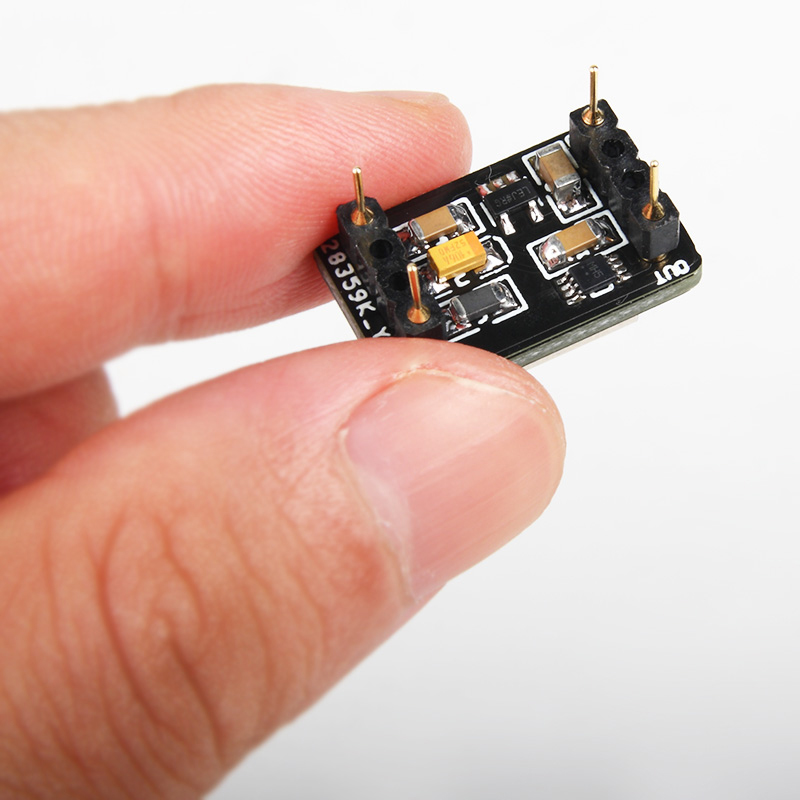

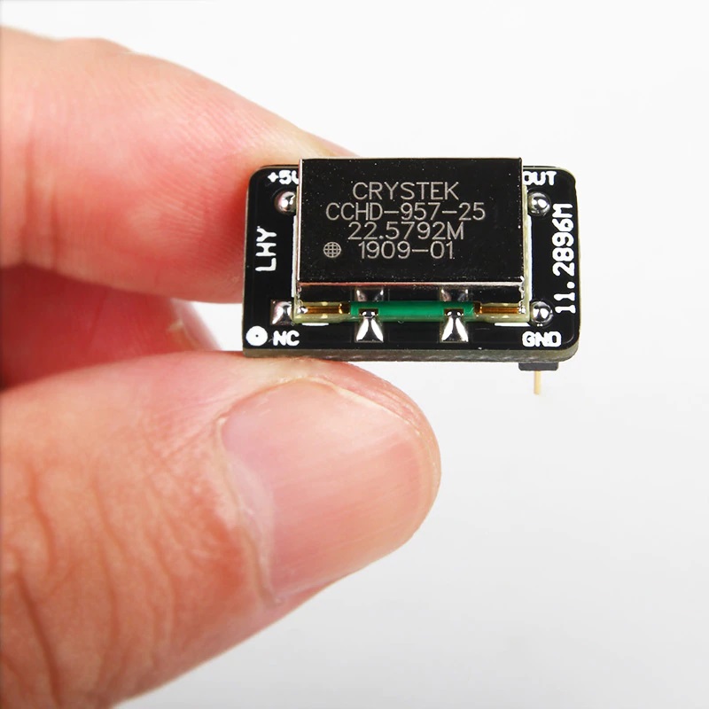

get 11.2896 from 22.5792Mhz clock
I saw this application, the 11.2896Mhz output is still low noise and low jitter?
If so anybody know the smillar or better circuit sample?
