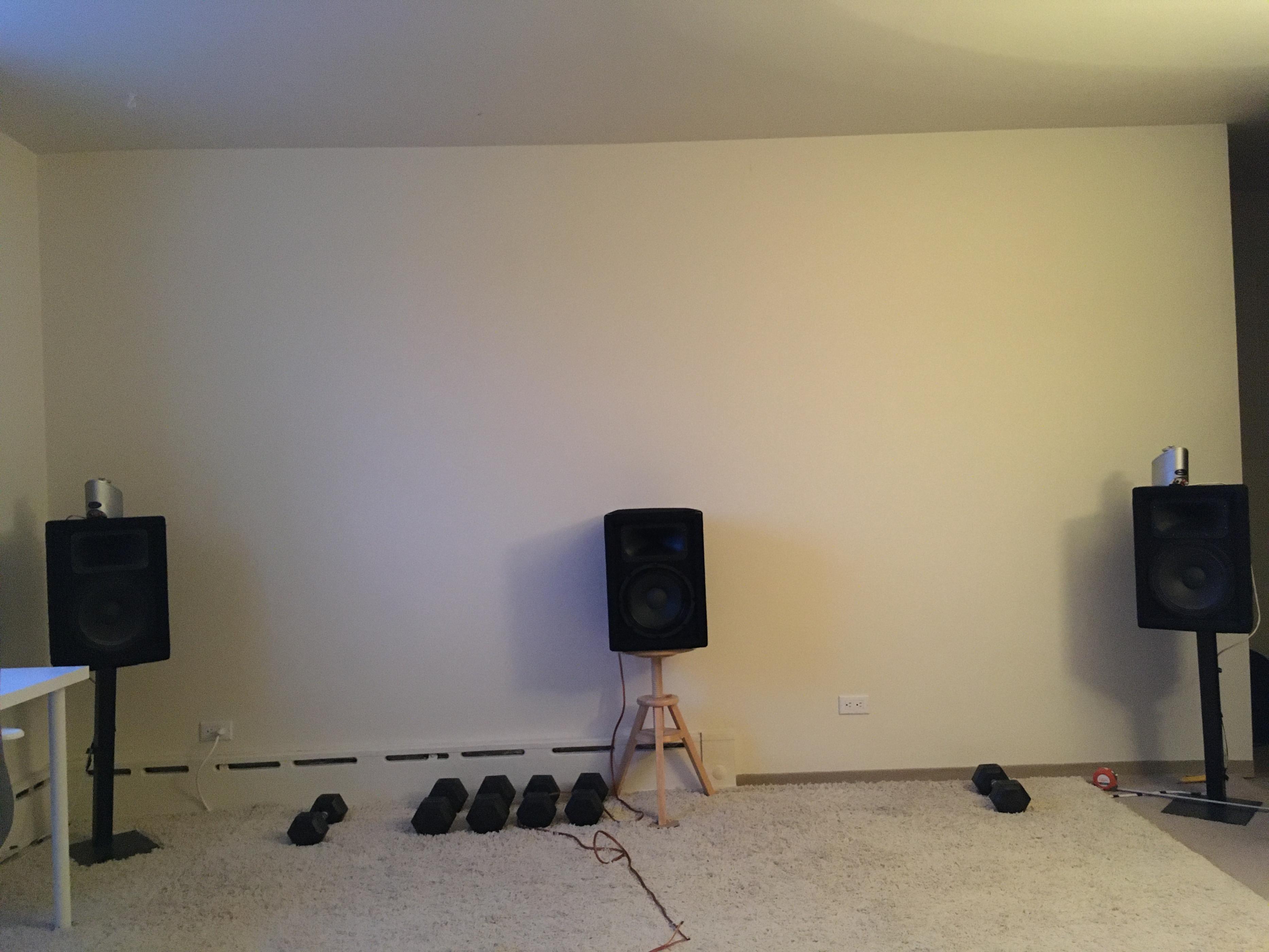

Two days ago I picked up a matching center channel to my main speakers, which use Celestion 1425 with 10” WG and 10” woofer. I have been using Dolby surround for music listening with stereo LR and surrounds, it’s fantastic. If you haven’t tried Dolby surround I highly recommend it. It’s a completely different ballpark from older up-mixing formats.
I was stunned to realize that the center image was smaller with LCR than just LR. The overall soundstage was smaller and less 3D. The center image was just as strong with LR. I had to go up a couple times and make sure the center wasn't on. This was with full Audyssey XT32 in a room that has nothing in terms of diffraction between the speakers and listener.
Needless to say, the center channel is going back and I’ll be sticking to LR + surround.

Interesting. When I've used a center for music I had to turn it down 4-6dB below where it "should" be. That might work for you. Basically I'd start it very low and turn it up slowly until it just had an audible effect. That's what I liked.

In terms of gradually turning it up from zero, while the Audyssey app is generally fantastic, it makes adjustments like that quite time consuming, as you have to upload the settings to the receiver each time.
I did try tinkering with the db of the center a bit though, little over, little under. But no matter what I did, it was a clear detraction from stereo LR. This was NOT the result that I was expecting. I'm having jzagaja (Jack) make some large waveguides for me. I was going to have him make three, as I assumed sight unseen (sound unheard?) that they would be superior to just stereo LR....
Glad I did this little experiment beforehand.
With properly setup stereo waveguides, the center image, and imaging in general, is just so spot on. Saved me some $$$.
It should be noted this is not at all exclusive in any way to wave guides. Doesn't matter what the speakers are. Correct/precise symmetry yields exactly the same result. However the more directional they are the more remarkable the dial in will be. Flat panels for example have a range of tolerance of about 1/4" max out of alignment from your listening position. Vertical alignment is just as important.

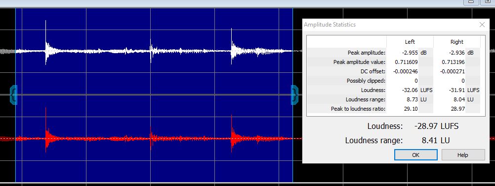

On the dynamics front, having a play with Goldwave (well more a poke and flail) and here is a random 2 second fragment of Rickie Lee where you can see how the snare dominates the track. Over the whole track the Loudness range is 10.7LU. Next step is to work out what that actually means 🙂

hi Krivium, what I meant was to try and get my head around it for a comparion between different music so I can try and translate if 10dB of loudness is good bad or meh. I did that extract whilst on a boring conference call so didn't have any research time 🙂

Start with Kaffiman's post on first page. Ludb was not developed for music at first ( it was for broadcast and in particular commercials) time of integration is very long ( something like 1mn) and will take the whole material into account hence the 'high' reading from this track: the snare take over.
Link given by Mountainman Bob should help too.
