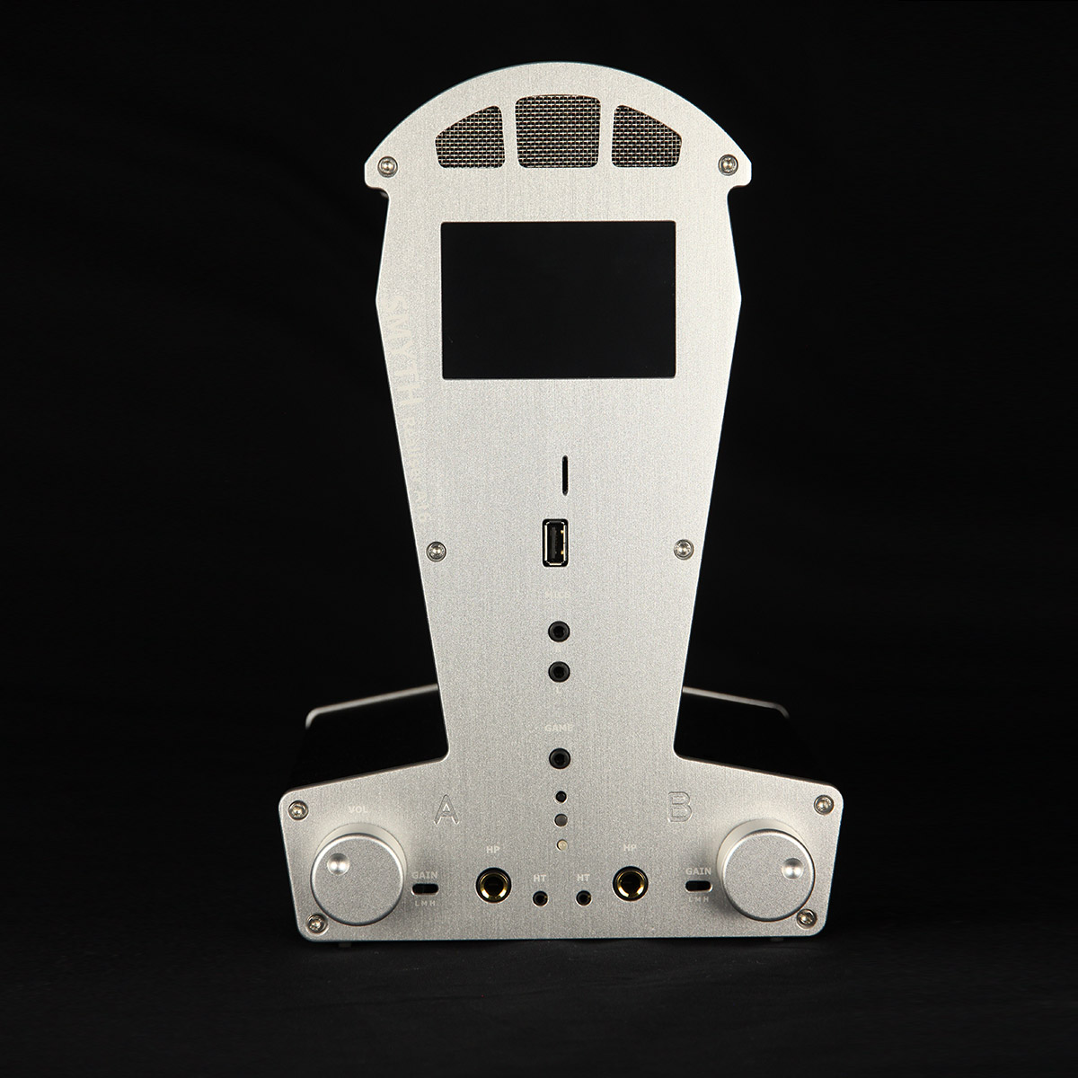

I have also been involved in testing the Smyth Realizer a few years ago
That shape reminds me of something... Hmmmm...
A16 Headstand - SMYTH Research
Yes, the epitome of audio. Nothing quite like having a massive "knob", even with extra knobs on, to shove right in the face of your buddies when showing off your audio system.
Must be very, very good. But I do find it somewhat questionable that they seemingly resort to classic clichés using a phallos, even if it's for marketing purposes.
