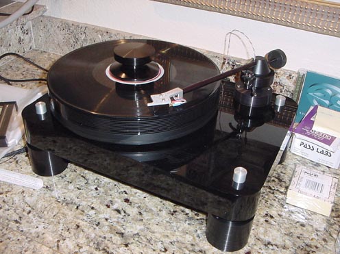

I had a few chances to sit and listen to the Rushmore during my time at the show. I was able to listen to a variety of music and vocals at various levels. When I first arrived, Kent, at the request of a listener was playing some orchestral piece at 116db at the listener (according to an RS SPL meter). The sound was effortless. Kent’s comments somewhere was that there was some headroom to spare. There was no hint of the amps running out steam. From this it was clear that the Rushmore is very capable and highly listenable.
I later got a chance to hear other material, both vinyl and CD, at more reasonable levels. The Rushmore loudspeaker system (Alephs included) were always accurate, engaging, and enjoyable to listen to. Not being a pro critic, you certainly need to take me with a grain of salt, but there are speakers that sound very good, and then there are speakers that not only sound very good, but they just seem to involve you in the music. The Rushmore is the latter. Add to this the granite and vacuum molded cherry wood laminate cabinetry, and the Aleph amplifiers, and you have a loudspeaker system worthy of being a Pass Labs product.
The sound of the Rushmore is no accident. Many kudos are due Nelson, Kent, Desmond, and the Pass Labs crew in developing this jewel of a speaker system.
Thanks again to Nelson and the Pass Labs crew for the hospitality showed me. It was truly my pleasure.
Rodd Yamashita
Rodd Yamashita

Hi Dennis,Dennis Hui said:Rodd,
Thank you for sharing your impressions with us.
Just curious: What was used for the vinyl frontend?
I assume a D1 was used for digital playback.
Dennis
I don't recall if Kent had the D1, but the vinyl was played on a Basis through an Ono.
Rodd Yamashita
