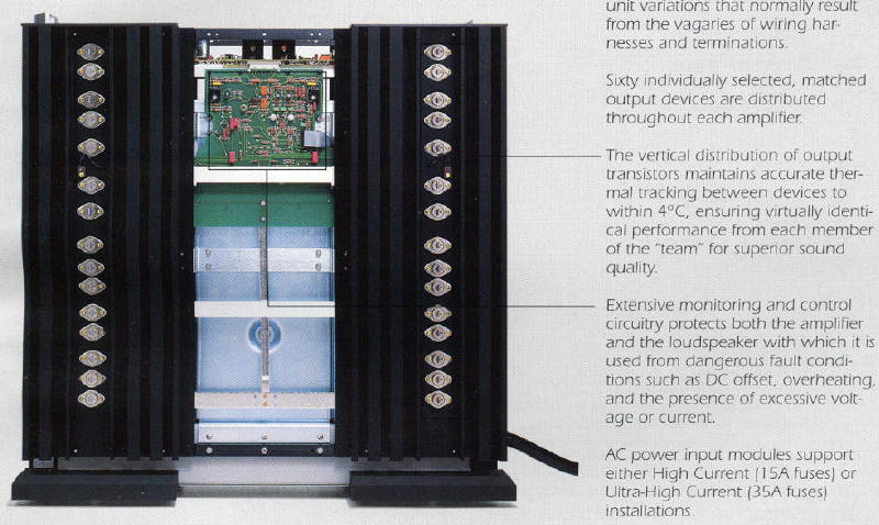

Incidentally, the too-hot-at-the-top thing is why I didn't jump on the heatsink bandwagon recently. The heatsink everyone else seemed to like looked a little tall to me. If you're running one row of devices across the heatsink, you can live with it, but if you intend to put more above that first row they won't cool as well, because the air flowing across that part of the heatsink isn't room temperature air--it's already been heated by the lower rank of devices. At low bias, it'll be all right, but at higher bias, you could punish the upper outputs. Fans will help.

I guess you didn't see this picture before. If you read the small print, you'll notice that although devices are placed in vertical row the temp. difference between them is within 4 deg. C.😉

Yeah Grey I don't understant the comments about the heating issues either. Peter gave an extreme example of the contrary here. Is it just me or these guys placed the transistors in kind of a sloppy manner? Anyways, I have sort of a similar heatsink to the r-theta I can measure no thermal gradients to speak of. I am disspating ~140W.

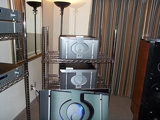

I met "the big guy" today! Here's a snap of the XA amps. Sweet. The lower amp is the XA160. This gear has to be seen in person to truly appreciate the build quality. Mr. Pass was very kind and even signed a few autograps for me, which was the highlight of the trip!

The question is: How much heat is each of the devices in Peter's picture dissipating? If it's a no-holds-barred class A amp, then that's one thing. But if it's a class AB, B, or some sort of sliding bias amp, then that's another. In other words, the picture is incomplete. In order to decide what 4 degrees Centigrade implies, we'd need to know more about the design (specs on heat sink, too). There's a whole lot of difference between 10W/device and 30W/device.

This amp (ML33) is rated 2400w/ch continuous rms power @1ohm. Of course it is variable adaptive biasing scheme.

Are you just teasing or what? and what kind of picture is that? Could you have possibly been standing further away and(or) at an even more extreme angle?
You better have more pics and the full article describing your meeting with Nelson, what you guys talked about, future direction of audio and diyaudio, full report on the setup details and how the system sounds etc, etc.
grataku (in the official capacity of envious bastard) 😉

those amps aren't plugged in are they? all i see are some really
sad looking old generic duplex receptacles in the back left hand
corner of that picture! 😀
i'm glad i haven't seen any of this stuff in person, cause i'd be
drawing up schematics on how to knock off the local bank(s)...
we'd have to have a thread debating the proper thread count
and color of the ski masks used in the heist!!
