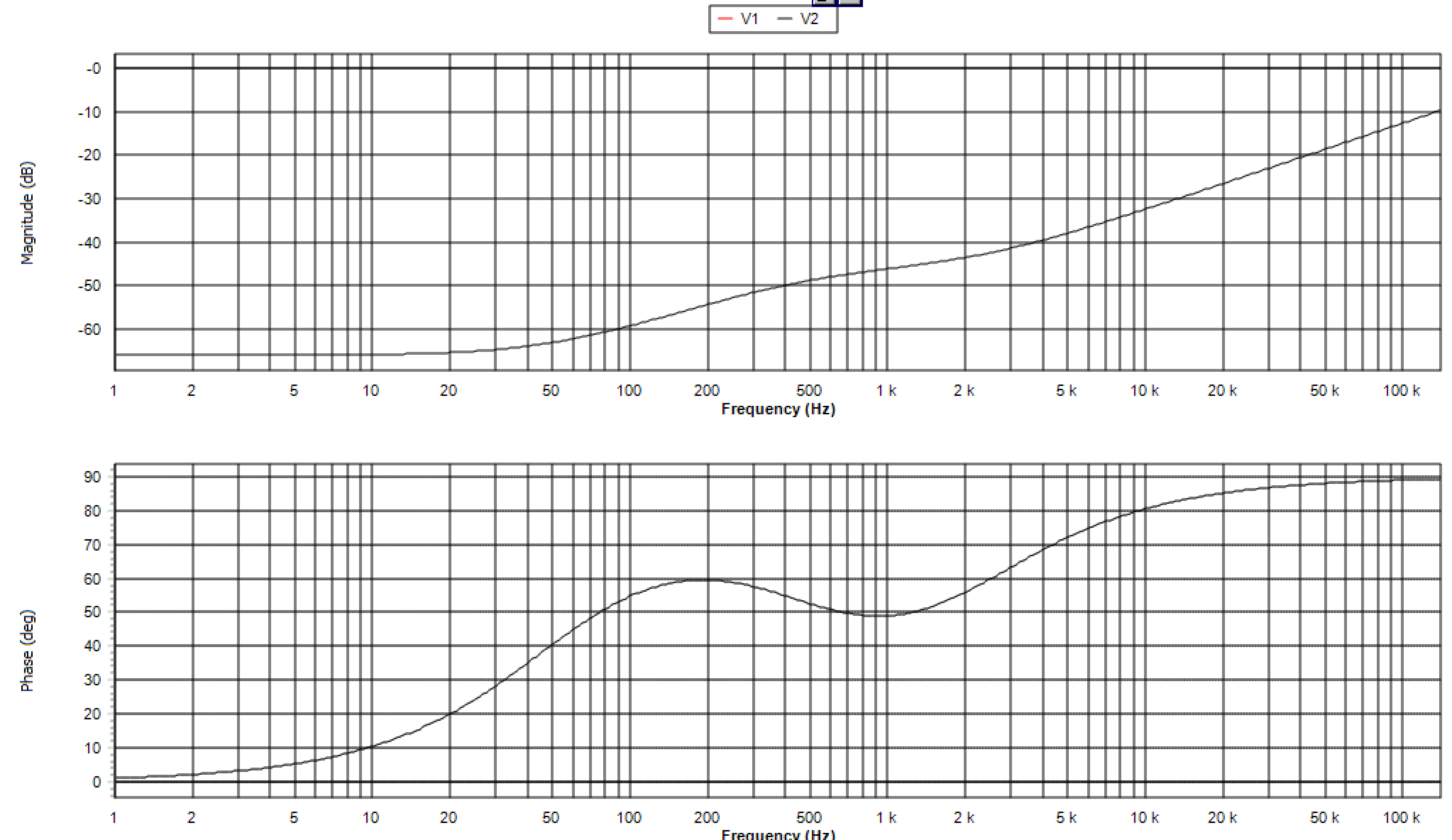

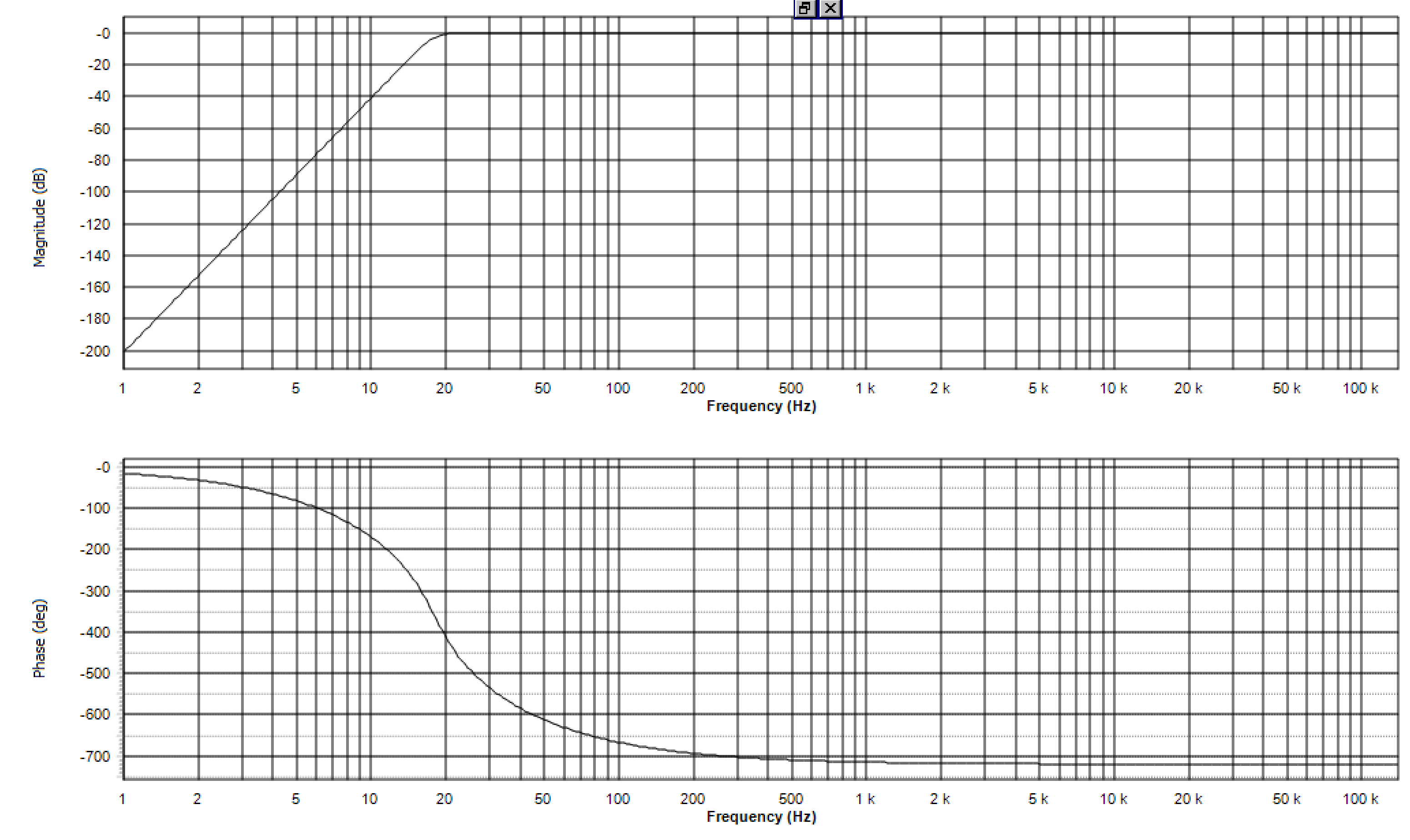

Thanks for those graphs. I've attached the circuit diagram of an 8th Butterworth high pass filter that works quite well for rumble. The response plots are quite similar to yours. Look closely at the 10-12Hz region that may well be critical for things that get excited by rumble such as cartridge/arm resonances. OK, I agree that if the turntable has a mediocre cartridge/arm combination then the best thing is to fix the mechanical problems and after that try electronic remediation.
It uses one quad opamp per channel which is handy for channel separation reasons. The layout is very symmetrical - all the caps are the same and all the resistors are parallel pairs. I use "Veroboard" (that's what it is called in the UK and Commonwealth) which is quick but might be sub-optimal from a layout perspective. I reckon if it works on Veroboard, it can only get better with proper routing software and PCBs!

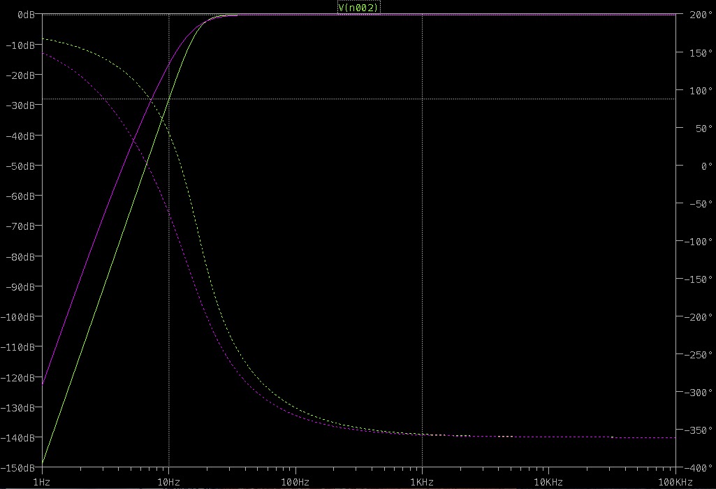

With Rod Elliots topology, faster rolloff is possible using alternate part values, at the expense of 50% more group delay at 20Hz (37mS vs 23mS).
Adjusted to be the same 2dB down @ 20Hz as Elliots. Much better in the 8-12dB range. This graph optimized with 85nF caps, a non-standard film value. Purple trace uses Rod Elliots values, Green trace is with alternate values:
Similar results can be obtained using standard 82nF & 91nF caps (Elliots values in Yellow):
In my builds, I used 100nF/0.1uF caps, and the result was fine.
