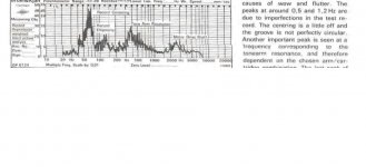

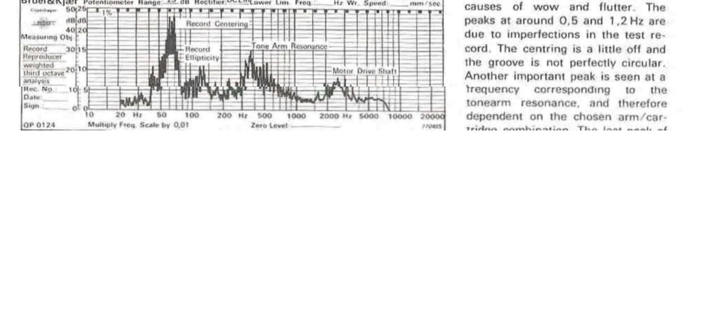

And going by that diagram that you posted, actually anything below 18 hertz is just "noise", and must be removed/damped/eliminated.
For all reasonable intents, particularly with records, anything below 20-25 Hz is noise, robbing power from the amplifier, pumping speakers, etc.
As I have said several times the infrasonic signal frequency modulates the wanted signal. Attached a couple of diagrams from a B&K research paper from the 70s. You can see the modulation.

Hi Bill,
The engineers at B&K are wizards!
You've convinced me that taming the infrasonics is very important.
What is your preferred turntable? Have you measured it and improved it? My everyday TT is a Denon DP-45 that just keeps rolling along.
