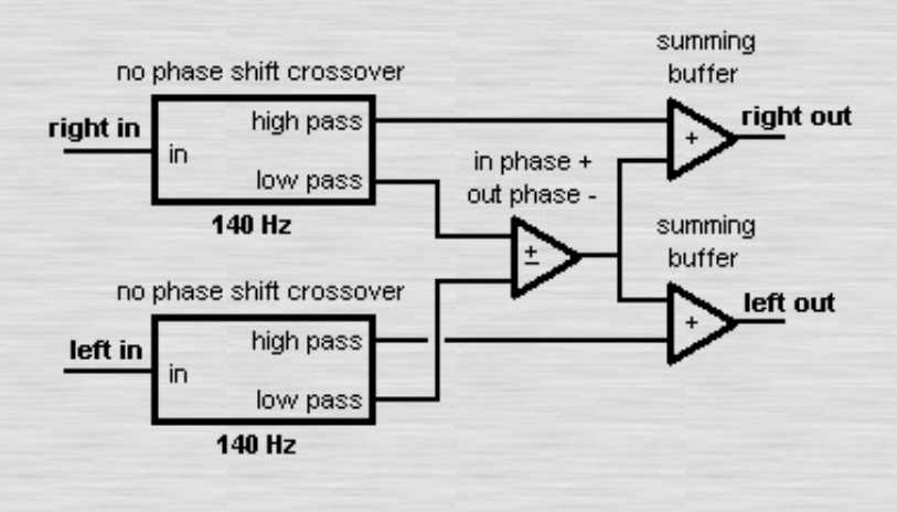

Looks like one of the best way to do this is to use a Linkwitz Riley crossover with the lower frequency output summed together and then combined back in with the high frequency output in separate summing amplifiers for each channel. Even when you've done that you'll still need another steep filter to remove lateral rumble at 15Hz or so.
However a better idea might be to simply construct a DIFFERENTIAL high pass filter between the two channels, say 24dB/octave Bessel? Would certainly cut down on complexity.

I have one of "these" in my preamp collection The Derumbleizer cancels rumble 3 octaves higher than any filter
Ah, ha! Here's another bass processor rather than 'just' a filter
from:
PS Hey Monty, can you describe your two ideas a bit more (or even make flow charts like this?)

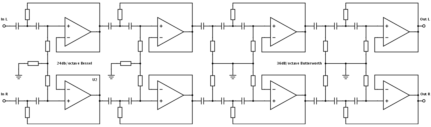

OK, here's a off the top of my head schematic for the differential filter derumbler. First it has a 24dB/ocatve Bessel filter between the two channels filtering the LF out of the stereo difference. The resistors to the opposing channel on this filter should be grounded via a very high value resistor to give the opamps their bias current. This should be set to about 150Hz or so.
Next is a 36dB per octave conventional high pass Butterworth filter to remove the lower frequency rumble set to perhaps 15Hz or maybe even 20Hz.
I have yet to evaluate whether or not this will cause any phase issues, perhaps a crossover veteran could give some advice 😕 ?
This works out to be quite simple, although I've omitted the input buffers and output decoupling.
To be quite honest I'm not mad keen on summing and differential amplifiers they would add to noise and complexity IMO. My idea for using a Linkwitz Riley crossover and summing the lower frequencies is pretty much the same as the block diagram you have presented.

As we are at line level, surely noise from summing is not a major problem? If it is then there is the Self approach of running hot through the filters and attenuating down afterwards which has a significant gain in noise.
I can't help on the phase without doing a sim tho.
Well, the Self approach you describe only works when the input is being fed into a power amplifier that can only handle a volt or two at it's input before clipping occurs. In this application we want all the headroom we can get as transient clipping is a major bugbear in most phono stages.
If sensible resistor values are chosen then noise won't be a major problem but it'll be far higher than in the topology I just posted. Circuit complexity will also be higher, meaning more components, more build time, larger physical size and higher power requirements.
Ah, assumed we were post RIAA so we had some attenuation of the high frequency part of the spectrum for ticks and pops. You might still be very right tho, need to mull some more.
It's just not good practice as it reduces headroom which is never good unless that headroom genuinely won't be used (as in Douglas Self's crossover). This is especially true if you are planning on using supply rails less than the 15V commonly used. I use 16.6V as it can be done with simple 317/337 power supplies and E12 values.

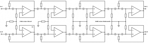

I have incorporated my findings into a circuit that will sit between my phono preamp and control amp (see attached) although a little more complicated than a steep subsonic filter, the extra complexity is well worth it. The circuit applies an 60dB/Decade filter at 12Hz, and collapses the stereo image below 160Hz. When using these filters on Audacity the rumble is reduced by about 24dB at 20Hz.
I'd be interested to hear peoples ideas on this concept, so tell me what you think 🙂. I'm still experimenting so will keep this thread posted with my results.
Question?
See circuit, U2L - inverse and non-inverse input must changeover among themselves ? Or not ?
I think, this is a mistake on circuit.

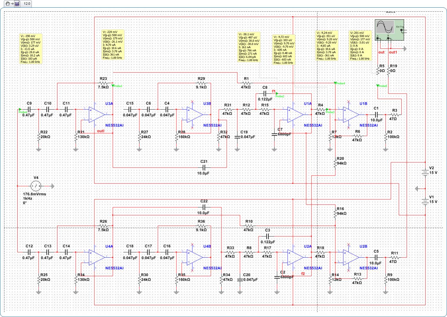

One new circuit.

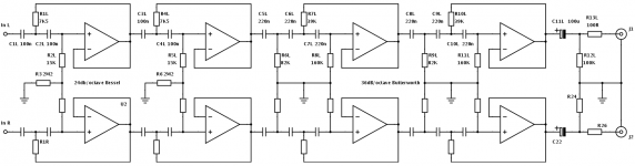

.OK so here are some values I've worked out. The bottom and top half of the circuit are mirror images of themselves R3 and R6 satisfy the need for op-amp offset current while ensuring that the filter remains almost purely differential.
Questions about ciecuit.
Frequency of Bassel filter ?
Frequency of Batterworthe filter ?
