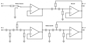

In the February 2011 edition of AudioXpress, Jeff Macaulay describes a warp filter. Jeff is famous because, among other things, he designed a rumble filter back in 1978 that appeared as a circuit idea in Wireless World magazine in the UK.
At the moment, I am working on a design that sums L+R to form X (the lateral signal) and takes the difference L-R to form Y (the vertical signal). The X signal is high-pass filtered at 18Hz and the Y signal is high-pass filtered at 140Hz. X and Y are summed to form L and differenced to form R. The summer is a non-inverting design using 1 opamp. The differential amplifier uses 2 opamps. Each HPF uses 2 opamps. I have a couple of projects that are taking up all my hobby time, but as soon I have built and tested it, I'll post the results on DIYAudio.
One important question is what should I compare my rumble/ warp circuit against? The choices are: nothing, Rod Elliott, Michael Fearnley, Jeff Macaulay, and the KAB RF1. I can build all of them except for the KAB. I'll keep you posted.

Thanks oshifis. You wrote, "I recommend a simpler topology: convert X-Y to M-S, HP filter S (use Bessel filter for minimum group delay), then convert back to X-Y."
What frequency would you suggest for the HPF? If the recording engineers try to record all signals below 140Hz as mono, then I guess the HPF should be tuned to something close to 140Hz. The attenuation down at rumble frequencies would be quite good especially if you used a 4th or 5th order filter.
Would you filter the mono signal? The mono signal should not suffer from warp but will still include some rumble. The consensus seems to be around 18Hz. What do you think?

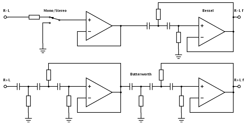

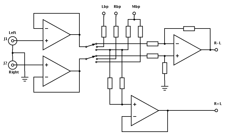

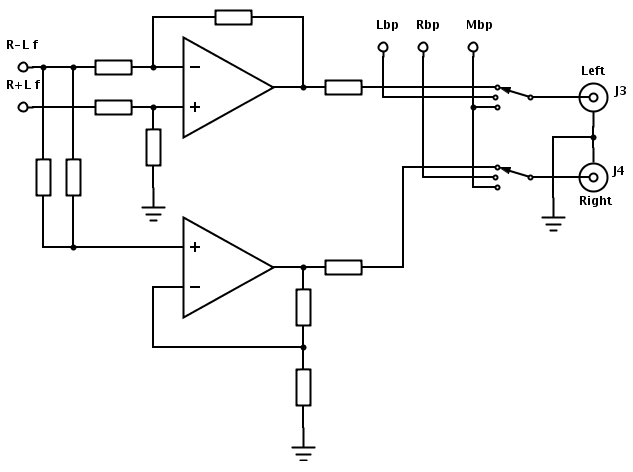

New Topology!
Here's the new topology, haven't got round to working out values yet 😀...
It's basically based around three basic 🙄 subsystems...
1. The mid to side converter. This turns Right and Left to R+L and R-L (or mid and side). Filter bypass options by a 3 way 4 pole rotary switch for stereo (Lbp and Rbp), and mono (Mbp).
2. Filters. A 36dB Butterworth filter tuned to about 15Hz for the R+L channel, as most of the lateral rumble is below audio frequency. A 12dB bessel filter tuned to about 150Hz for the R-L channel - the low group delay of the Bessel filter ensures that the frequency response won't be too bumpy 🙂. Also a stereo collapse option via the Mono/Stereo switch.
3. Mid Side to Right and Left. Takes the filtered R+L (R+L f) and R-L (R-L f) and converts to Right and Left outputs using a summing amp and a difference amp.
It's a little more complex than the first circuit at 10 opamps, I included the buffer into the Bessel filter to keep things even so it can be done with a quad for the first stage, a quad for the second stage, and a dual for the last stage. The buffer is also included because toggle switches are usually MBB and I don't want to ground any opamp outputs or present an output impedance to the input of the Bessel.
I implement an identical system in the digital domain for LPs and 45s. Frequency response is very flat and it's never let me down 😉.
Comments... Questions... Suggestions?

Yes you could do it with DSP but then again you can do it with a couple of TL072s with less hassle. I use this topology but with split rail op-amps instead of emitter followers now.
I use this technique for file processing also, the results are very pleasing.

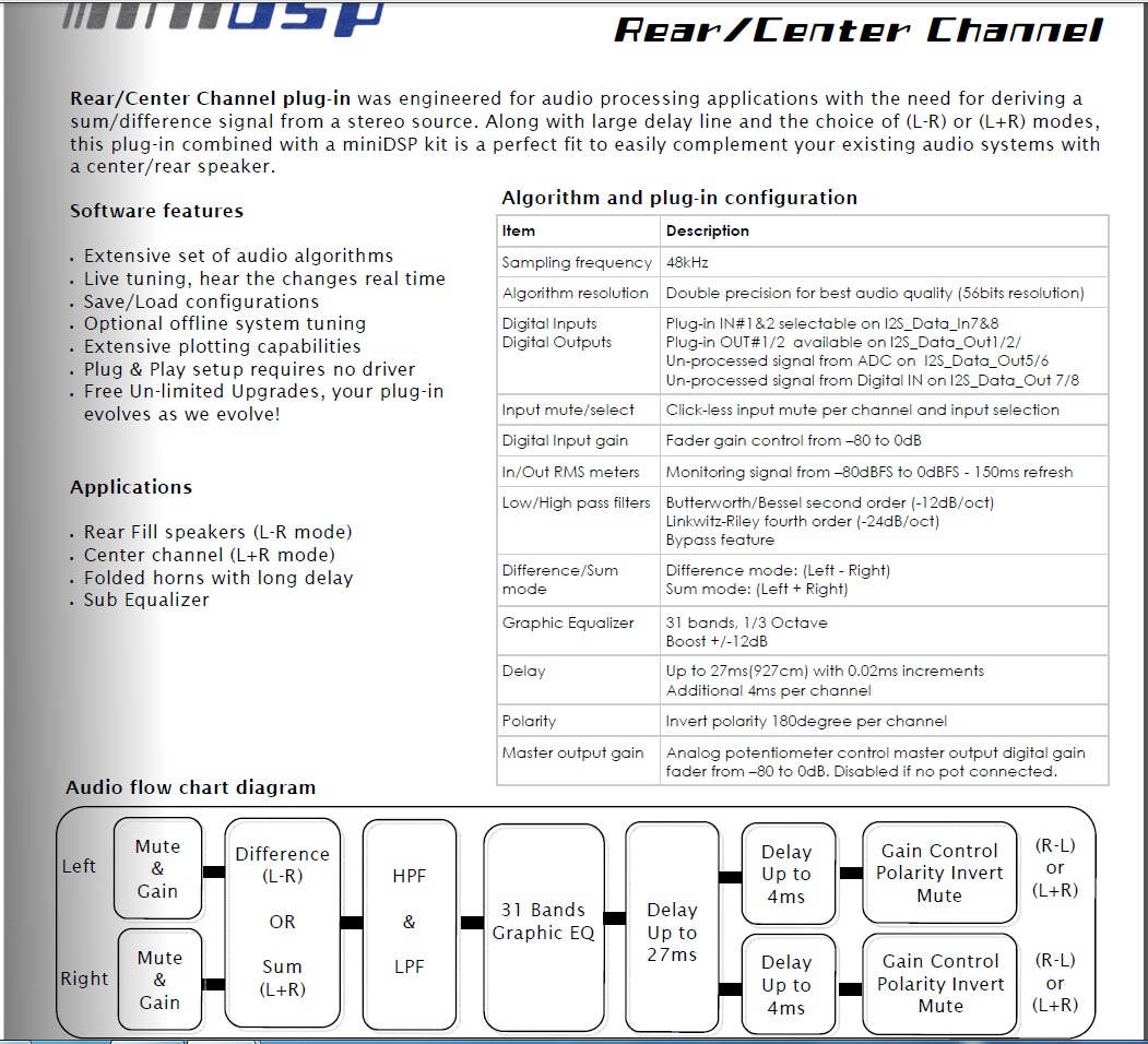

I was thinking of my miniDSP:
Hmm, looks like the sum and difference are gonna be my problem:
There are some mixers but they only do mix (+) [sum].
But they do have invert (-x) too ...
Is inverting, then summing the same as calcing the difference ? Sort of like regular algebra ?
x + (-y) = x - y
No problem here, it has:
From miniDSP 2-way adv plugin
Filter type
Selects the type and slope of the filter. The steeper the slope, the more quickly frequencies above or below the cutoff frequency are attenuated. There are three types of filter:
Butterworth (BW)
Available in 6, 12, 18, 24, 30, 36, 42, and 48 dB/octave, Butterworth crossover filters are 3 dB down at the cutoff frequency.
Linkwitz-Riley (LR)
Available in 12, 24, and 48 dB/octave, Linkwitz-Riley crossover filters are 6 dB down at the cutoff frequency.
for the 36dB Butterworth filter tuned to about 15Hz
and
Bessel
Available in 12 dB/octave only (whew!), a Bessel filter gives a more gradual roll-off through the crossover region...
for the
Again issues with the sum and difference.

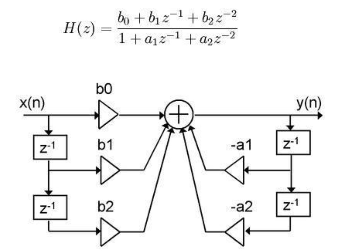

It does have biquads:
"Crossover advanced mode
The Crossover blocks have eight biquads on each output channel, allowing a high pass and low pass filter of up to 48 dB/octave ..."
and miniDSP also has a sweet biquad spreadsheet:
www.minidsp.com/images/fbfiles/files/All_digital_coefs_v1-20101026.zip
... but I don't know if I'm able to select two inputs or ...
:sratch1:
I figured you digital guys might know ...
Thanks,
Jeff

Ah-ha! I think I found it.
In the miniDSP Rear/Center Plugin:
from:
View attachment Product Brief-Rear-Center channel plug-in.pdf
I'll just have to double-check the HP & LP and 31-band EQ filter blocks to make sure they can do:
36dB Butterworth, 15Hz for R+L
12dB bessel, 150Hz for R-L
Or something almost identical.
