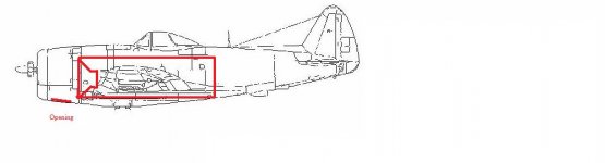

Yes, that looks good if you've got room.
Just curious, what is the approximate diameter of your fuselage? HD Theater channel's Air Combat program this morning was about the P-47 vs the FW109. They commented about how massive the TBolt was and how the pilots had to get used to it.
Yes, and it's only 5 pounds. Mount two of these back to back in a cylindrical enclosure (are you familiar with Sonotube?) and you should get good results. You won't get much high frequency out of it, but you could even add a small tweeter if you wanted.
Since I'm in the planning stage, I can make the plane as big as I want / need it to be to accomplish what I need it to accomplish.
I think that's the benefit of building it from the sound perspective. A lot of other folks build first, then try to shove the sound system in.
I like that 5" driver, but with more than 3 db difference in sensitivity, it looks like I have to more than double the wattage as well as the amount of drivers needed. Trying to shove one big speaker, might also be easier than shoving 4 smaller speakers somewhere in the plane.
