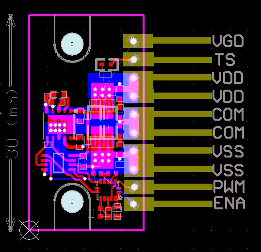

In your demo boards (EPC9002), you only delay the turn on of the low fet , in the hi fet you use a Zero ohms resistor for R4, this is a typo ??
with a resistor of 2k and 10p for the capacitor the turn on delay is around 15ns, is this the recommended value or we can go lower?
what is the effective dead time, for the demo board?

Hi Elevator.
It uses a gate pull-up resistance (0402) but not a sink resistance because of the problem EPCguy explain in the post #41 (preventing the Vgd charge to turn the low fet on wen the hi fet turns on).
This is not a final pcb, it just have the sensible parts on it, i am thinking on include the dead time control.

EPC9002 - the RCD pulse width adjust needs to adjust the required device deadtime as well as the mismatch in propagation delay (high side opto - no opto low side). It turns out I do not need to increase the HS pulse width - only delay and lengthen low side - therefore 'zero' on the HS adjust. Deadtime is relatively large for class-D (5-10ns) 🙂 and can be tuned smaller if it can be controlled over voltage / temp / pulse width.
The values are conservative to make sure all boards don't have cross-conduction - probably could reduce it still a few more ns.
The discrete version has a single PWM input - since deadtime is controlled and minimized, the negative switch node voltage is too short duration to be an issue - those Si schottky diodes are pretty slow 🙂. The board can be modified for two input operation, which will require an optional high side regulator (footprint for Mic5213) to avoid OV on HS with extended dead-time (such as isolated half-bridge application).

Very nice pcb, i like it very much elevator, congratulations, i think you are almost there.
Try to use thicker traces in the connection between the lt5113 and the fet.

Yes, i see now, you only use the optocoupler for the high side.
If you use the two optocouplers (no mismatch in propagation delay), what will be the value of the resistence in the RCD circuit?
5ns-10ns of dead time is not a problem, there are ways of dealing with that.
One way is making the output inductor current ripple larger than the load current. As long as the inductor current ripple is larger than the load current at the moment of switching, its current is in the right direction to force the switch node voltage to begin slewing to the other rail immediately in the beginning of dead time. So no dead time error. this method is not widely use because of the relative high Rds of the output mosfet (increase conduction loss), but this is not a problem with the eGaN FET as they have very low Rds resistance. I use another method .

I am thinking in using a lm317 instead of the lt3011 for the 5.6V, is any problem with that?
And, if i go with a discrete solution (probably i will). I will use the Complementary mosfet BSD235c instead of the Sia513,it has a Qg of only 0.4nc and Rds 350mohm (N Channel) 1200mohm (P Channel). I think it is a better choice, as the Sia513 is no longer recommended for new designs, by Vishay ,and need a higher gate charge.

The RCD circuit will then just be the deadtime +/- the matching error between the two paths. Could be around 100 ohms or so.Yes, i see now, you only use the optocoupler for the high side.
Doh. Yes the EPC9001 uses schottkys. The EPC9002/3 are the BAV19/21"those Si schottky diodes are pretty slow 🙂."
Are you referring to the BAV19WS? they are not schottky.
The reason for the LT was a small regulator with a PGOOD - this acts as UVLO to have both fets off when the bias supply is removed (else "BANG"). If sequencing is ok, then any old regulator should do. I find the LT3011 being limited to 50mA is limiting for HF on the EPC9001 for going past ~2MHz.
I agree - I've tried to replace the SiA513 with the 511/519, but they have too large a gate change and too slow if you still want the pre-drive to realize the offset voltage to avoid cross conduction in the final stage. Still looking for a replacement. Si1563? (haven't got around to trying it yet)
The BSD235c seems a good choice although I'd like to see it in the thermally enhanced DFN package. You may have to also adjust R9, R10 for best speed / zero cross conduction.
