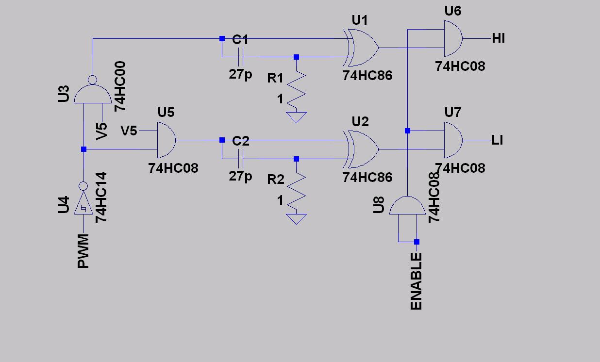

Meanwhile I have been toying with dead time control and going from PWM to HIN/LIN. The principle is easy enough, this sim gives DT from essentially 0 to around 1us when setting R1=R2 from 0 to 50KR. The prop. delays through the two arms should match.
We only need like 5ns to 15ns.
One thing that would be nice, is a Dt control like the Si8244 use (only regulation in one resistor).

Sure, 1us is bad for distortion but good when you leave your beer on the heatsink and it's still cool after 10 minutes😀We only need like 5ns to 15ns.
Seriously, 1us is way too much for the GaNs.
One resistor for both? I guess that would need two current mirrors?

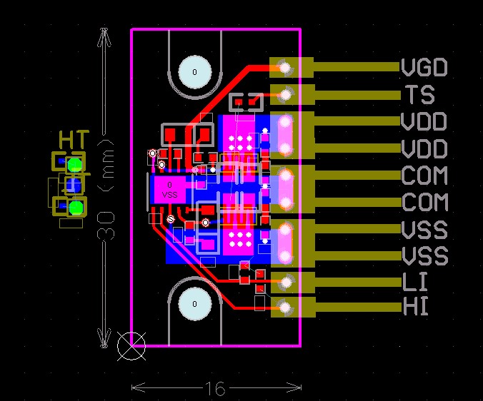

eGan driven by LM5113
E

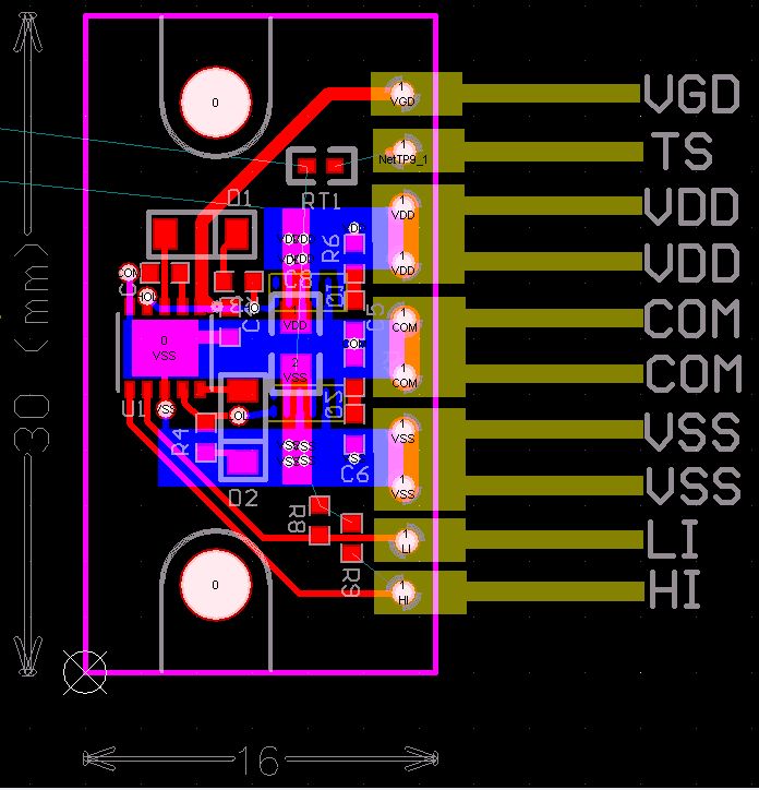

Here's a quick stab at a module using the LM5113 as driver. Again, half-baked. Note the only components on the bottom are the EPC2010s. BTW I didn't find the LM5113 to be very layout-friendly. But maybe it's just me trying to avoid 0402 sized components.... You seem to be very fast in designing pcb 😀 Thanks.

Meanwhile I'm off on a slightly different direction, but here's my take on the LM5113 from a few days ago, schematic and layout (less auxiliary temp sensors). I didn't follow the NS layout guidelines exactly, because I did not want to use 0402 components.
Note the only components on the bottom side are the mosfets. This should ease the mechanical (assembly) problems. Also, I'd make sure that the last (2nd) reflow pass is for the bottom side, since the mosfets are soooo sensitive... Which BTW means that the top components will have to be glued.

Curious about the diodes in series with the gate pull up resistors...Here's a quick stab at a module using the LM5113 as driver. Again, half-baked. Note the only components on the bottom are the EPC2010s. BTW I didn't find the LM5113 to be very layout-friendly. But maybe it's just me trying to avoid 0402 sized components.
E
Also from the layout I can't tell if the substrate pin (small pin next to gate) is connected to source of not. This is vital for operation as we found out.
Thanks EPCguy,
the diodes are a desperate measure. Somebody here remarked that 5V on the gate would kill the mosfets instantly, but OTOH the LM5113 wants at least 4.5V as Vdd. With Vdd=4.5V minus the diode drop, the mosfets would hopefully only go into a coma 😉
Noted re the substrate connection.
I also found that the LM5113 already pulls down the two inputs (HI and LI) so the two resistors are not needed.
