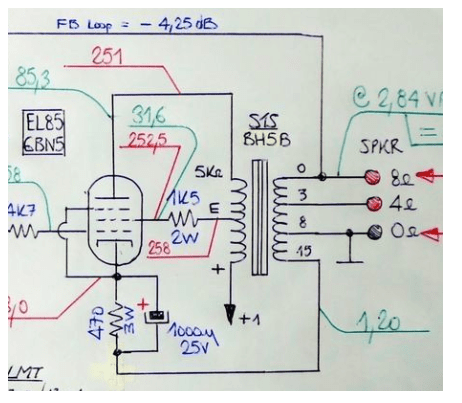

Yes, the OPT effectively becomes an autoformer with a higher turns ratio and a bit of extra primary inductance. In cathode biased output stages with CFB the DC can be kept out of the speaker by connecting the decoupling cap from the cathode to the secondary winding while the bias resistor connects to ground as usual.
Another advantage of having the secondary in the cathode side is you increase the primary impedance more than you might expect.
Aha, interesting - I never had the curiosity to compare : this may explain why the EL85/6BN5 operates as best on the 5K UL connection than with the required 10K primary load, hence to the cathode included winding then :
T
I am thinking: a 5k to 16r OPT has a turn ratio of circa 17.7 to 1. If the 1 is added in series with the 17.7, one gets 18.7, which becomes the new turn ratio. With a load of 16 ohms, this would make for abut 5k6 primary. Is my calculation right, or am I missing some other part that influences the change in primary impedance?Another advantage of having the secondary in the cathode side is you increase the primary impedance more than you might expect.
I run an 845 amp with a 5K primary and use the 0-16 on the cathode side.
Primary impedance increases to more like 6K in that case. Increasing the impedance was mostly my reason for going that route.
It has been my daily driver for about 6 years.
best regards,
Erik
I agree with the 17,7+1 calculation. This should result in a 11% increase of the primary inductance but also a slightly decreased DC rating, around 150mA I believe.
I must say the claimed 160mA seems a bit optimistic and probably applies to the 2,5k tap on the primary.

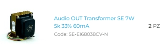

I see on another forum that I have mentioned that the Piemmes have full output up to 30kHz. Full output would in this case be ~3,5W @50mA from a triode wired 807. No notes about the LF performance though.
Yes. This model from PIEMME is probably interesting for a 10Y : https://shop.piemme-elektra.it/Categories/93/Products/8377

The transformer in your link is probably the best choice for your needs of the ones offered by Piemme. I picked their other 8k transformer because of its lower Dcr and 16R tap (for CFB). The lower Dcr, higher DC rating and different freq response indicates a lower Lprim which isn't a big issue for me as my front speakers only reach 50-55Hz and are supposed to be crossed over to a pair of subs at 70Hz or so with an active XO.
Both versions of Piemmes 8k transformers (there is also a third one with less interleaving, intended for guitar use) are probably a much better match for your 10Ys than the 2,5/5k OPT from TubeTown.

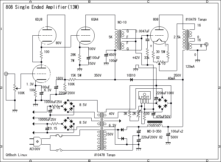

Possibly 7-8 dB. The 808 has a relatively hi amplification factor similar to the 811a. DF should be 2 or better, so in line with most zero fbk triode amps. Distortion figures will be good as well if the driver is capable, better than average.With the high mu 808 and the 16R tap at the TT transformer, I should get something like 4-5dB of CFB which might be just enough if I'm lucky.
It seems like CFB from the 16R tap was good enough for Mr Shishido when he designed his 808 SET:

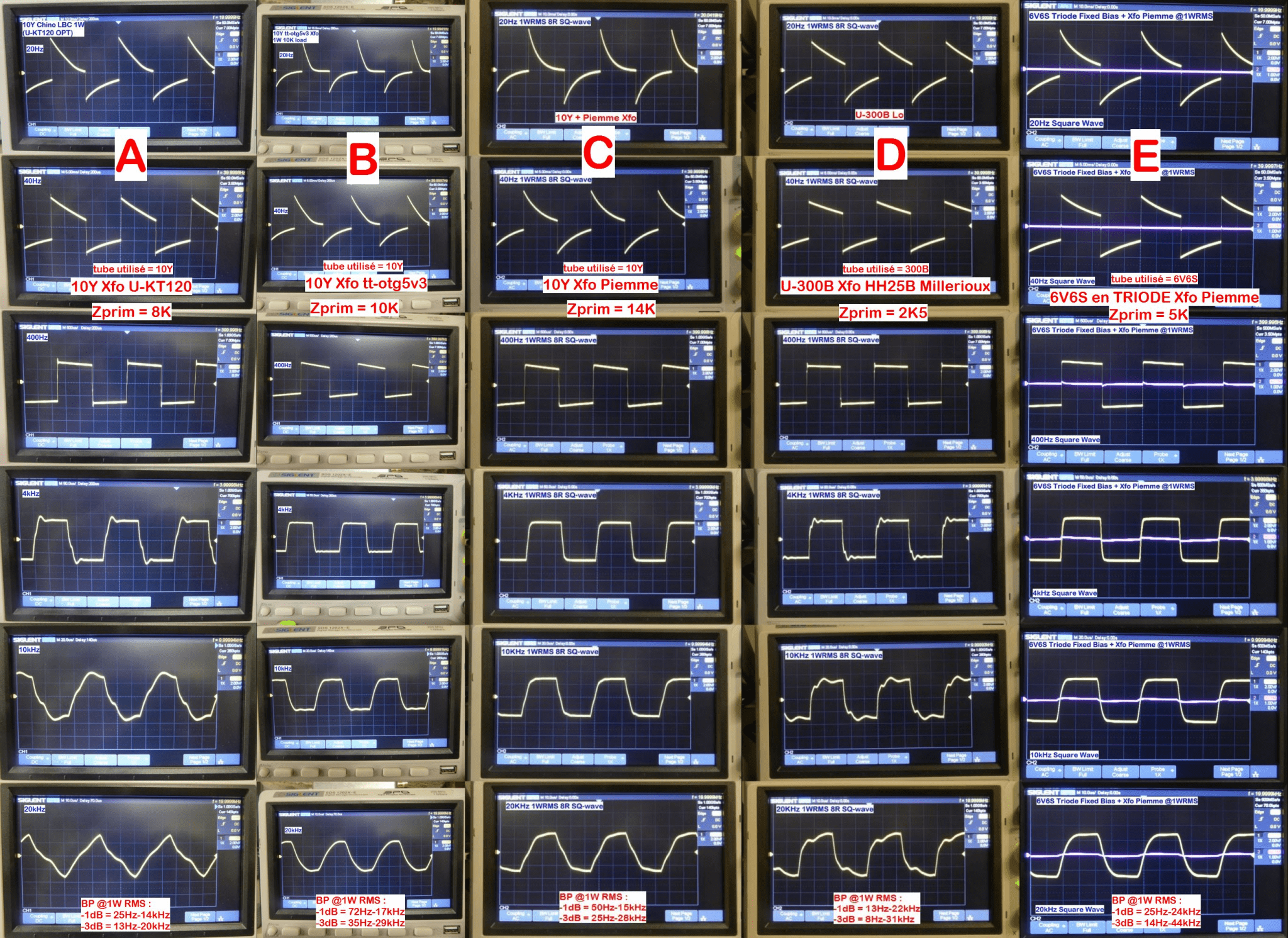

Yes @Fuling !
Here is below the comparison of the square wave response of different configurations :
A = 10Y with large Chino output transformer of excellent performance with KT120 (3K5).
B = 10Y with tt-otg5v3 output transformer (set at 10K).
C = 10Y with PIEMME output transformer (set at 14K).
D = 300B with STS HH25B output transformer (2K5).
E = 6V6S in triode connection with PIEMME output transformer (set at 5K).
The 10Y was in fixed bias operation, with 400VDC plate and 20mA current.
The coupling cap was 2.2µF and the grid resistor was 220K.
The power output was 1WRMS.
Tested, those 10Y met their datasheet specs plentifully at 250, 350 and 425VDC, no flaw.

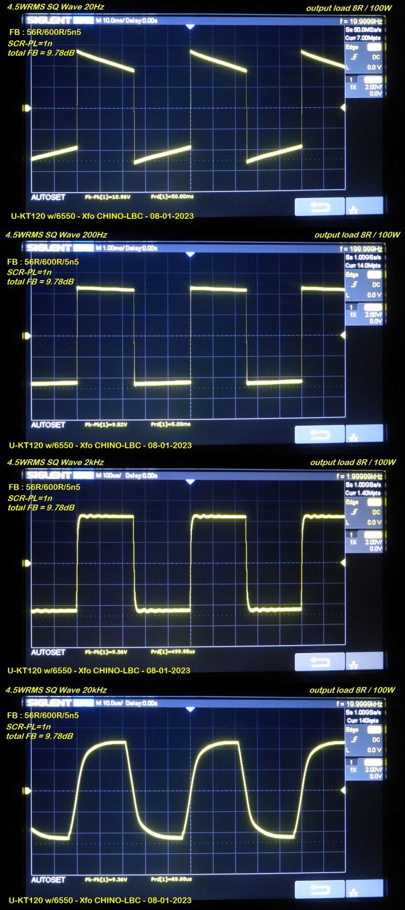

Below, the square waves with the KT120 and the Chino excellent performance output transformer, at 4.5WRMS :
As you can see, the square waves result is quite puzzling : the 10Y is defeated by a mere 6V6 or KT120... Despite being a true triode, direct heated, with low plate current and reputedly good linearity (according to the datasheets curves).
With an Audio friend, who like me held the 10Y in high consideration, we made listening tests with the PIEMME transformer using the 6V6S in triode connection and the 10Y, with suitable load impedance each time.
NOTE : my Audio friend was the "Candide", as he did not knew anything about my waveform test done previously, he was just here to judge by his ears. His conclusion was that the 10Y sounded very pleasantly, more "rounded", but also a bit more "shy" in the extremes.
My friend and I were waiting for a better listening performance - not to say amazing - compared to a 6V6S triode-connected, and we came to something finally not really significative, I mean : no undisputable gap in tone turning at the advantage of the 10Y...
Given the hassle to heat a 10Y in a compact tube amp design, the project is not really worth the expense, and at best is postponed, if not discarded.
That said, these little PIEMME SE-EI168038CV-N transformers are far from being an average one, and could be used suitably with other tubes !
