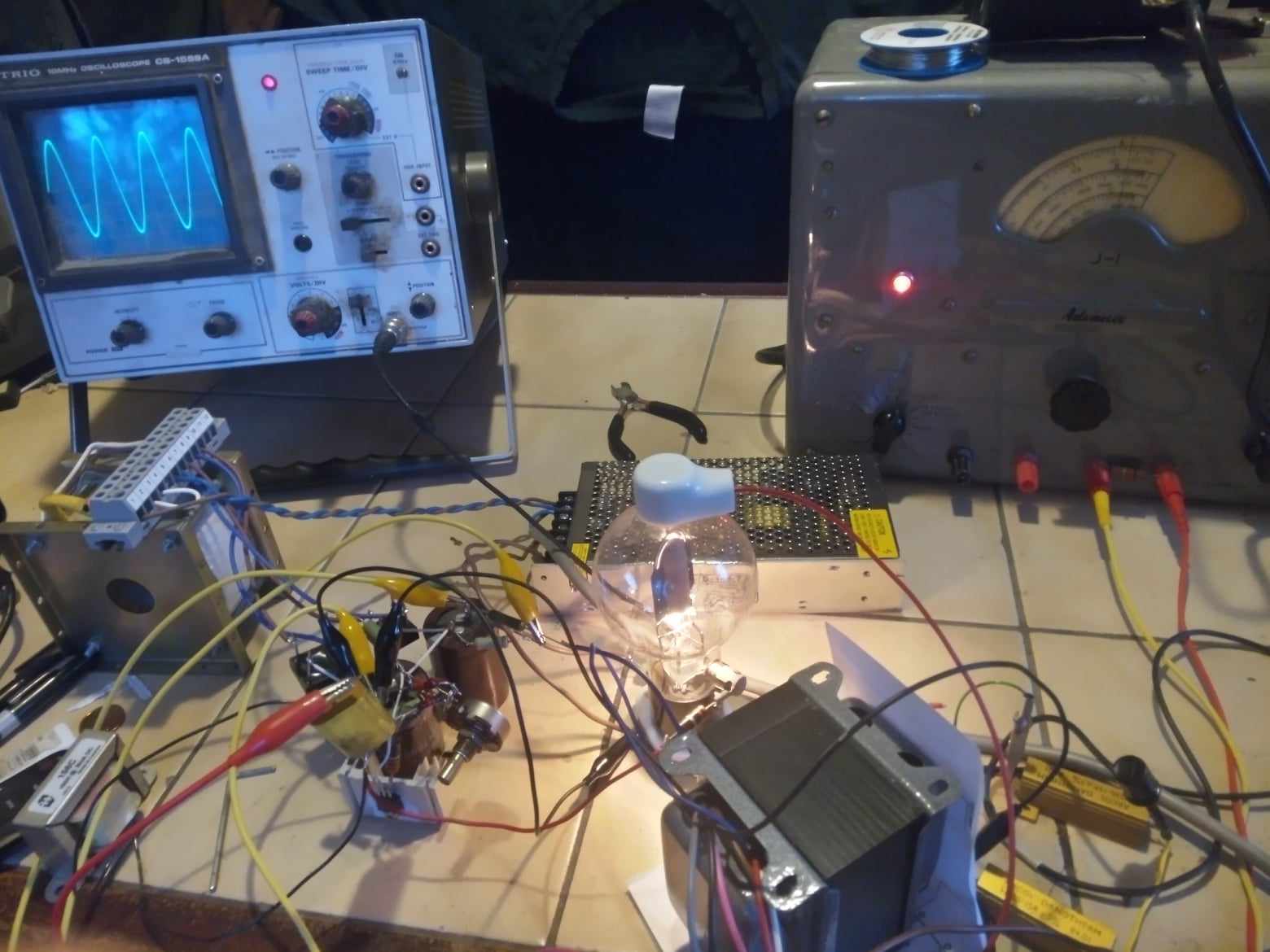

5k/8R is correct, I used a 7,5R dummy load on the 8R tap and most of the measurements where taken with a 12Vpp output signal (2,4W). I ran 80-90mA through the transformer most of the time. An 808 with a 5k plate load should be able to deliver closer to 10W but the power supply I'm using for the tests is not quite up to the task.

Some new test results:
With the tube running at 331V 91mA I get about 6,6W (10V peak into 7,5R) before visible clipping. I'm aiming for something like 450V 100mA in the final version and 10-12W output power. As far as I know 808 should be operating with a dull red color on the plates and that happens somewhere north of 40W.
With 8V peak (4,2W) as a reference point, the transformer rolls off -1dB at 53Hz and 25kHz and -3dB at 24Hz and 33kHz. Not great, not terrible 😎
My vintage tone generator is a bit shaky in the 4k-50k range but these numbers shouldn't be too far from the truth.
Worth mentioning is that the 808 is a high mu triode with pentode-like plate curves, a "real" triode with lower Rp would probably produce different test results from the transformer.

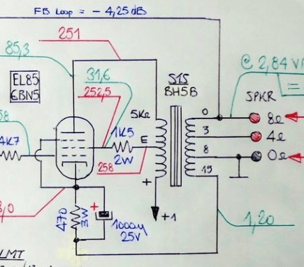

Yes, some kind of NFB will be necessary here. I can possibly get 4-5dB cathode feedback if I connect the cathode to the 16R tap instead of to ground, but this doesn't work well with all transformers and must be evaluated in a working circuit. Plate to grid feedback or output plate to input cathode feedback are also options, regular global feedback would be a last resort.

Yes, sort of. Seems to be some kind of balanced feedback there, one phase connects to the cathode of the output tube and the other, presumably, to the cathode of the driver through a resistive divider. An elegant circuit for sure!
Personally, I usually employ the full secondary winding for CFB whenever possible. Not every transformer likes this and with high transformer ratios and low mu triodes the amount of feedback becomes vanishingly small, like 1-2dB or so. Often it can still be a small step in the right direction re. DF, bandwidth and distortion at the expense of exactly zero extra components, but it must be evaluated from case to case.
With the high mu 808 and the 16R tap at the TT transformer, I should get something like 4-5dB of CFB which might be just enough if I'm lucky.

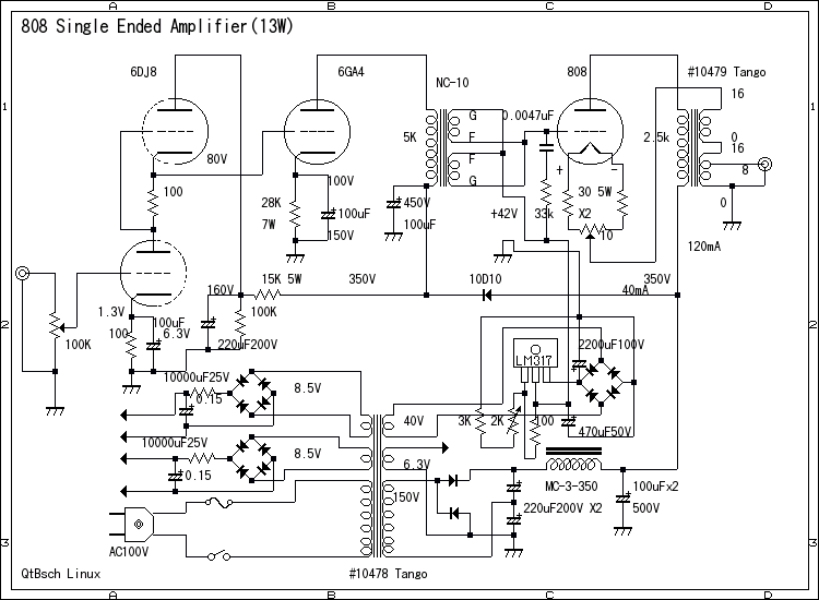

It seems like CFB from the 16R tap was good enough for Mr Shishido when he designed his 808 SET:
Yes, the same principle. Sometimes a part of the primary winding is "cut off" and connected between cathode and ground, allowing much higher feedback ratios. An effective way to reduce distortion and output impedance, but the driver stage must work harder to deliver large voltage swings instead.

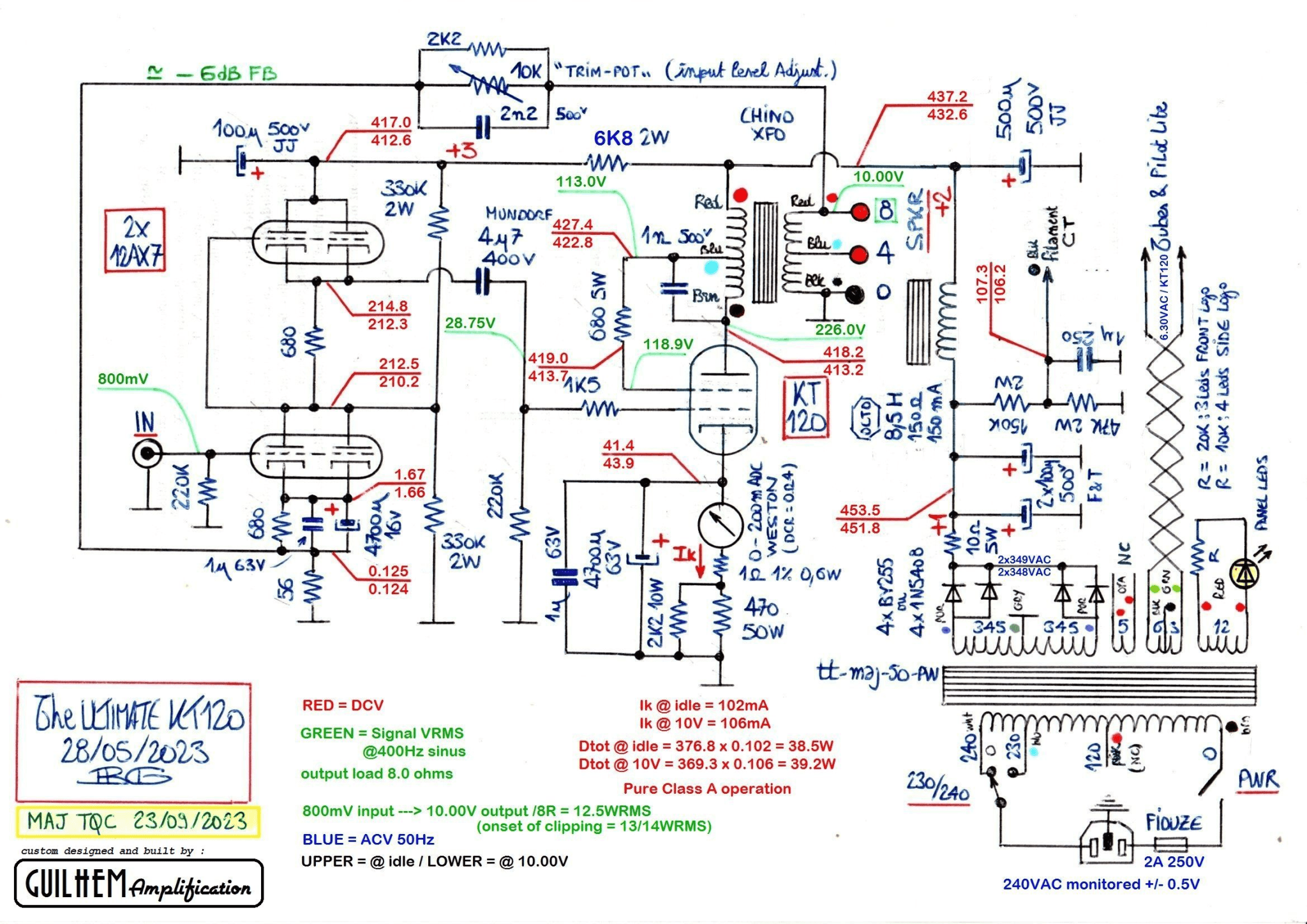

While writing this, I saw that I did not posted the schematic of the U-KT120... Here it is, with all numbers :
As you can see, on this one I did not used the cathode-speaker winding trick, the transformer proved good enough to avoid it. But there's a global 6dB trimmable FB loop though, plus a screen-to-plate bandwidth/overshoot correction (1n 500V).

Nice looking schematic, I bet that amp sounds good!
