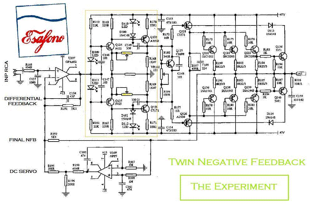

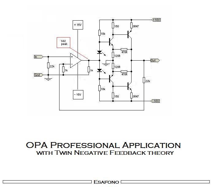

it's correct like this
Hello
GND on mosfets drivers is forced for TNFB (TwinNFB) reference
you can joint to transistor on output
it's not important
current stage is free from NFB because don't have gain in Voltage
Nelson I have seen F5
there are two NFB because it's balanced
this Sound's Revolution Amp have two NFB, one one each rail
for auto-adjusting different gain of PNP/NPN
in separate devices for better error-control
maybe (never tested)
Regards

Re: already exist in Current Stage
That is current limiting protection.
Tha aim to prevent the output stage from going ffzzzttt.
Glen
Stee said:need just in Voltage
a local feedback
the aim is to reduce the work of the input operational stage
Glen
Thanks a lot Glen
but do you think it's intelligent
modify sensibility of this stage
to have double local feedback ( one for each rail ) ?
http://cgi.ebay.it/Bal-Class-A-Powe...39783QQcmdZViewItemQQ_trksidZp1742.m153.l1262
http://www.esafono.it/a700.pdf
Regards

Stee
just some friendly advice.
First,
you learn how to design some basic amplifiers, with transistors:
this will give you knowledge to know more
what we can do
what we can not do
what is good
what is not good
what is really problematic
what we never should do
what is usually the best to do
After this, you Stee,
can start making Mark Levinson clones, copy
And maybe one day even some great & working amplifiers based on your own interesting ideas.
But to get into the same league as Mark Levinson
is not what some new diy hobbyist will make very quickly.
Some would get close .. after many years.
Some would never make it .. no matter how long it takes.

lineup said:Stee
any news
.... or you put this Twin FB into garbage now
No, he supposedly split everything on a complementary pair of amplifiers with own feedback in each one.
- The Twin Negative FeedBack Theory
