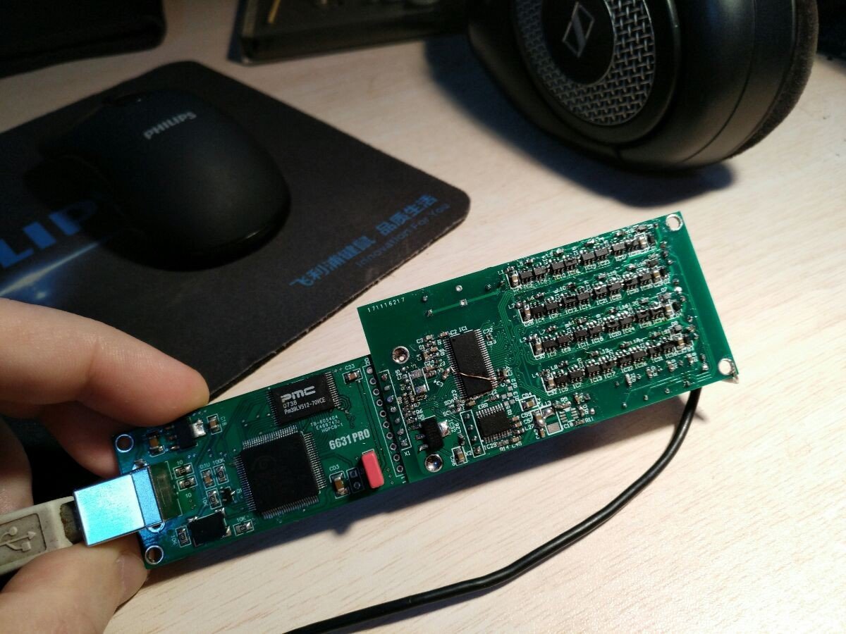

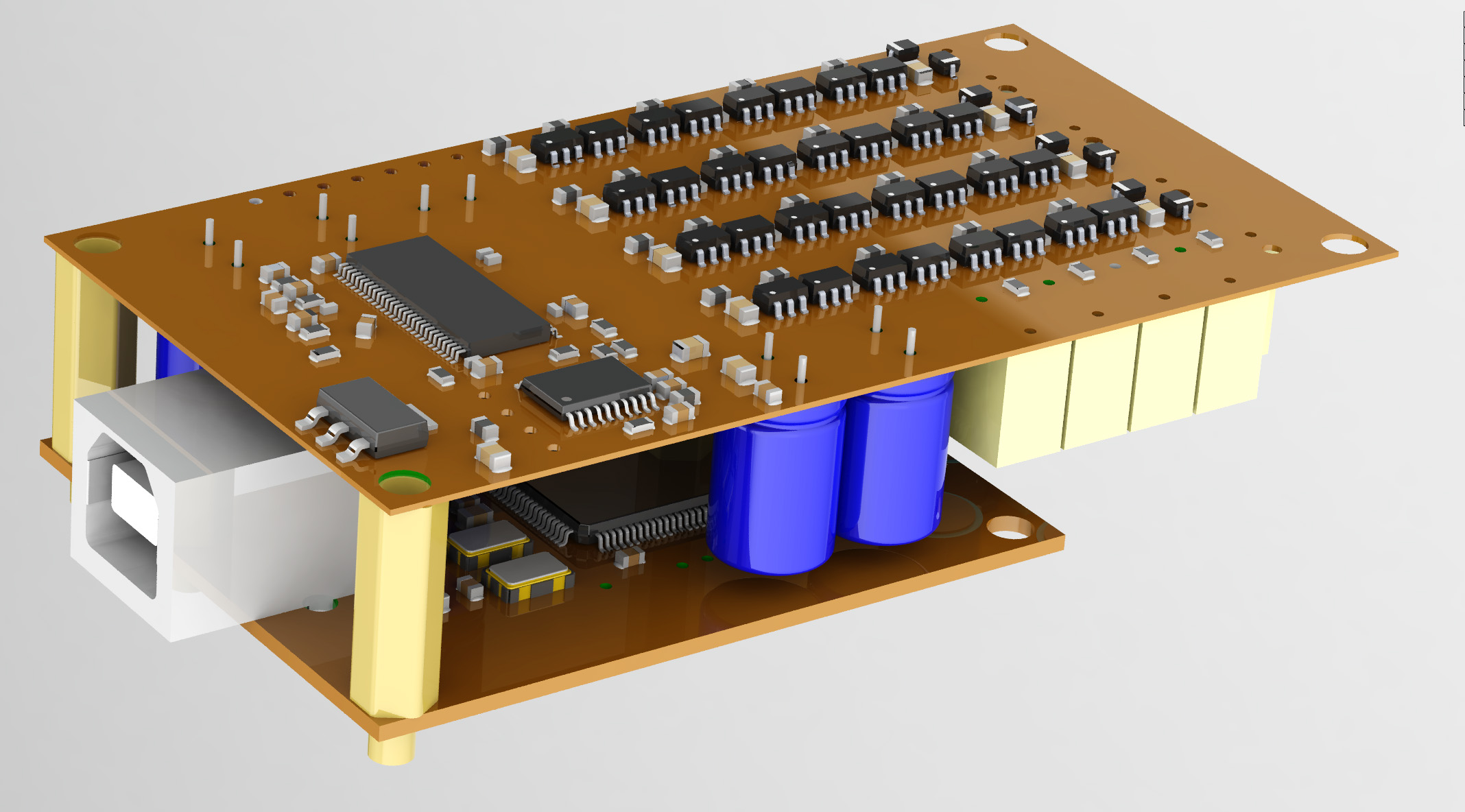

Hi guys, does someone listened really digital headphone amp ever? So-called Power DAC? I ready to bet if mine is most digital one! )) Why??77 Just because I used standard LVC logic as a power stage. Actually, it is well argumented choice for a headphone's amp due to very fast switching of the LVC logic gates and relatively high output current. Sure, a single gate has no enough output current to drive my HiFiMan HE400i, but tied (32pcs/ch) in parallel does work fine. Fortunately, HE400i has differential inputs(4 wires instead of 3), so using H-bridge output stage making possible to use 5V USB power for a whole thing, with a lot of SPL room. Here we go: CM6631A->TAS5558->64pcs of LVC invertors + STM8S003 MCU to control TAS5558 digital modulator. TAS5558's 4 PWM modulators tied in parallel for the left channel, and another 4 for the right. I had idea regarding step-up boost invertor to lift up and regulate >5V but finally gave up that for simplicity. I have to say that this is an open loop design i.e. no any f** feedback is implemented there, so S/N -94db(A) wasn't surprising for me(powered by dirty USB). However, -94db is the noise level which almost matched with theoretical CD (16/44) resolution. Furthermore, my headphones are opened back type so I feel zero noise with it(Power DAC noise just masked by environment noise). THD at 1/2 max power and HE400i load .02% but THD+N .04%, if TAS5558 and output stage powered from the same 3.3V rail THD and THD+N pretty much the same and looks much better(on the moderate volume I saw .003%) but output power become less. The sound to me is crazy detailed and dry(neutral, no harshness) as actually, planars like HE400i does.

I have built (well not from scratch, heavily modified) a number of 'digital' headphone amps, some using STA3xx chips and some using D2Audio chips with discrete MOSFET output stages. All used transformers for step-down and to allow me to drive standard 3-wire headphones. And yes, the sound is extremely good - dynamic and shed-loads of details (the right kind of details I mean, not 'detail').
Highly recommended.

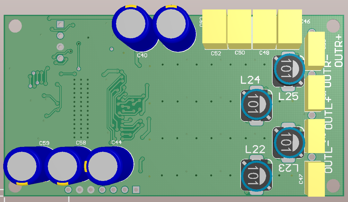

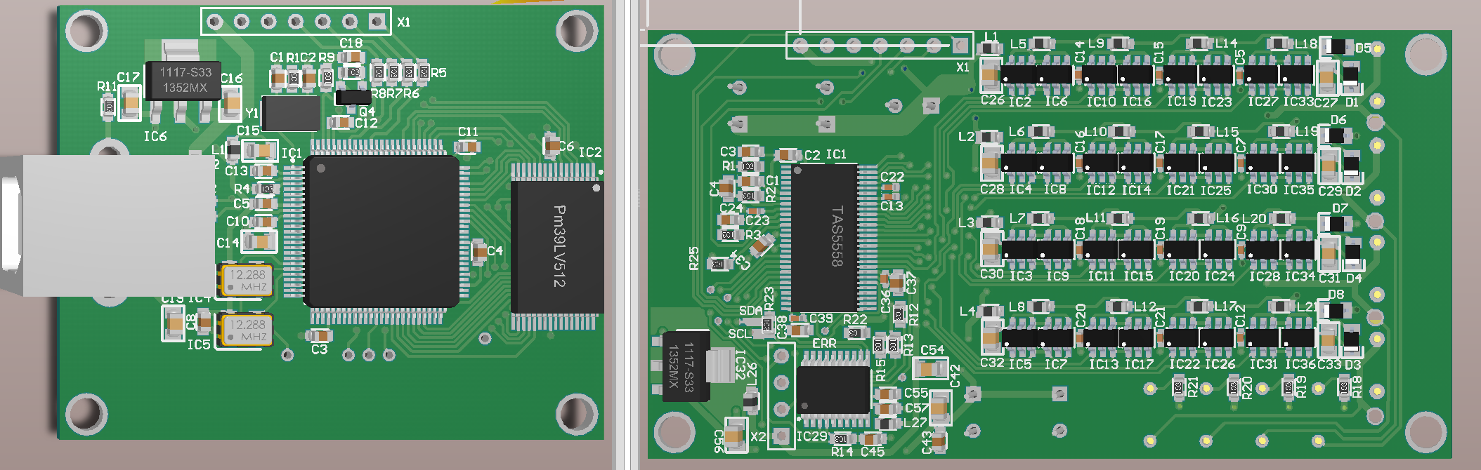

Two PCBAs(USB as a first, DAC as the second floor) fits 76x41x25mm of space, so it could look like long USB cable, little Power DAC case and short two cables to headphones i.e. pretty much like a fat cable 😉

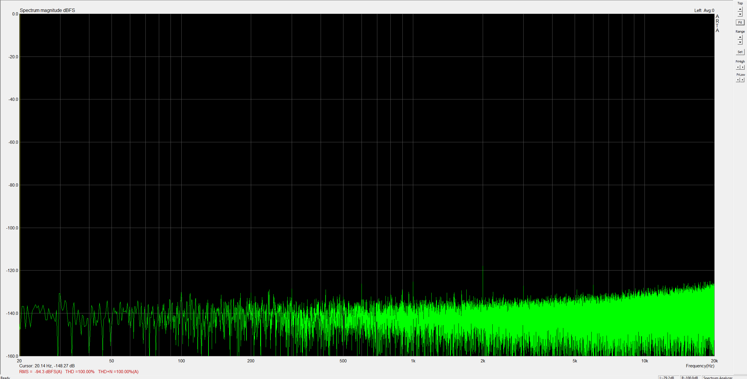

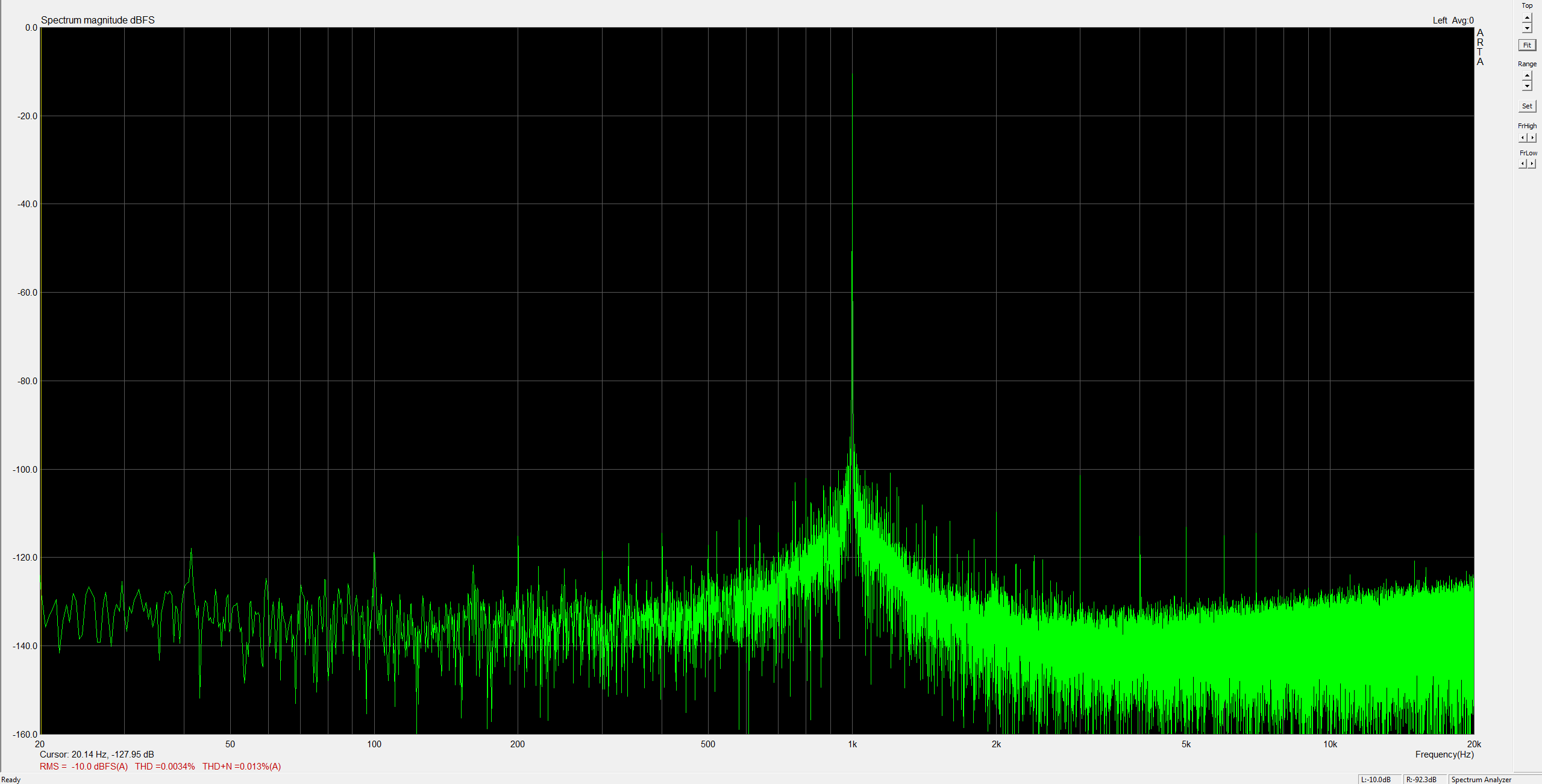

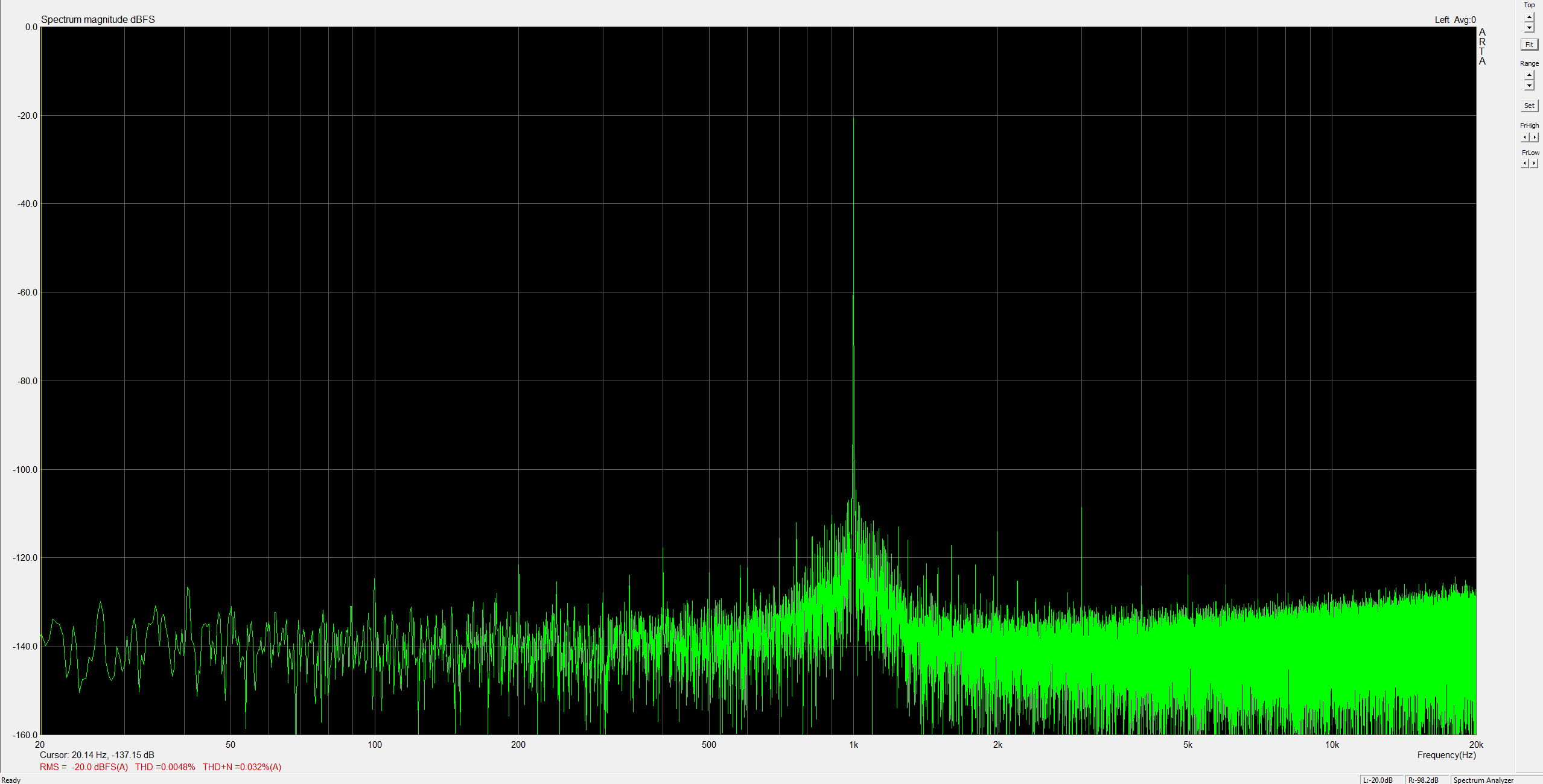

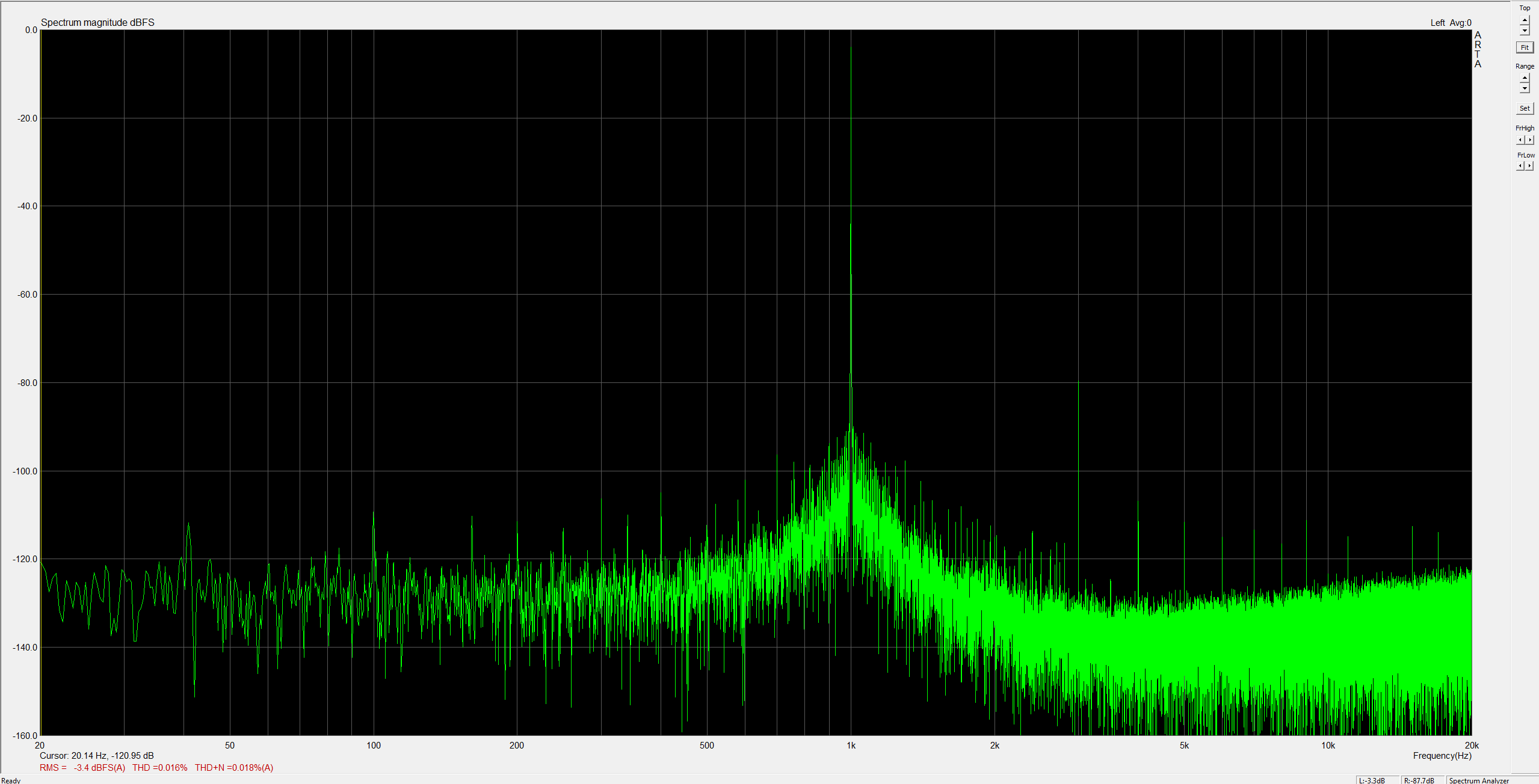

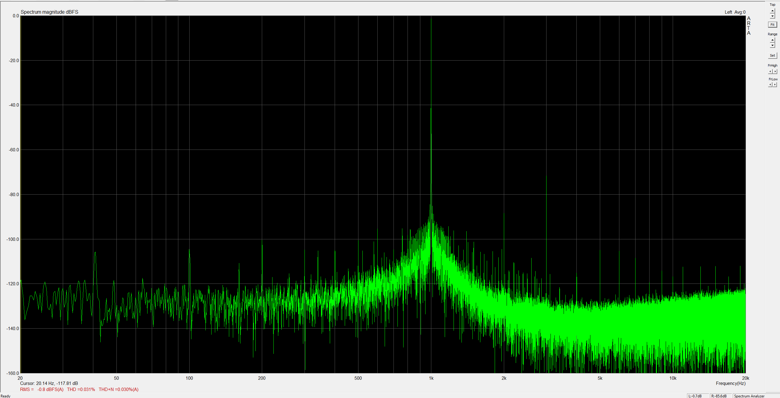

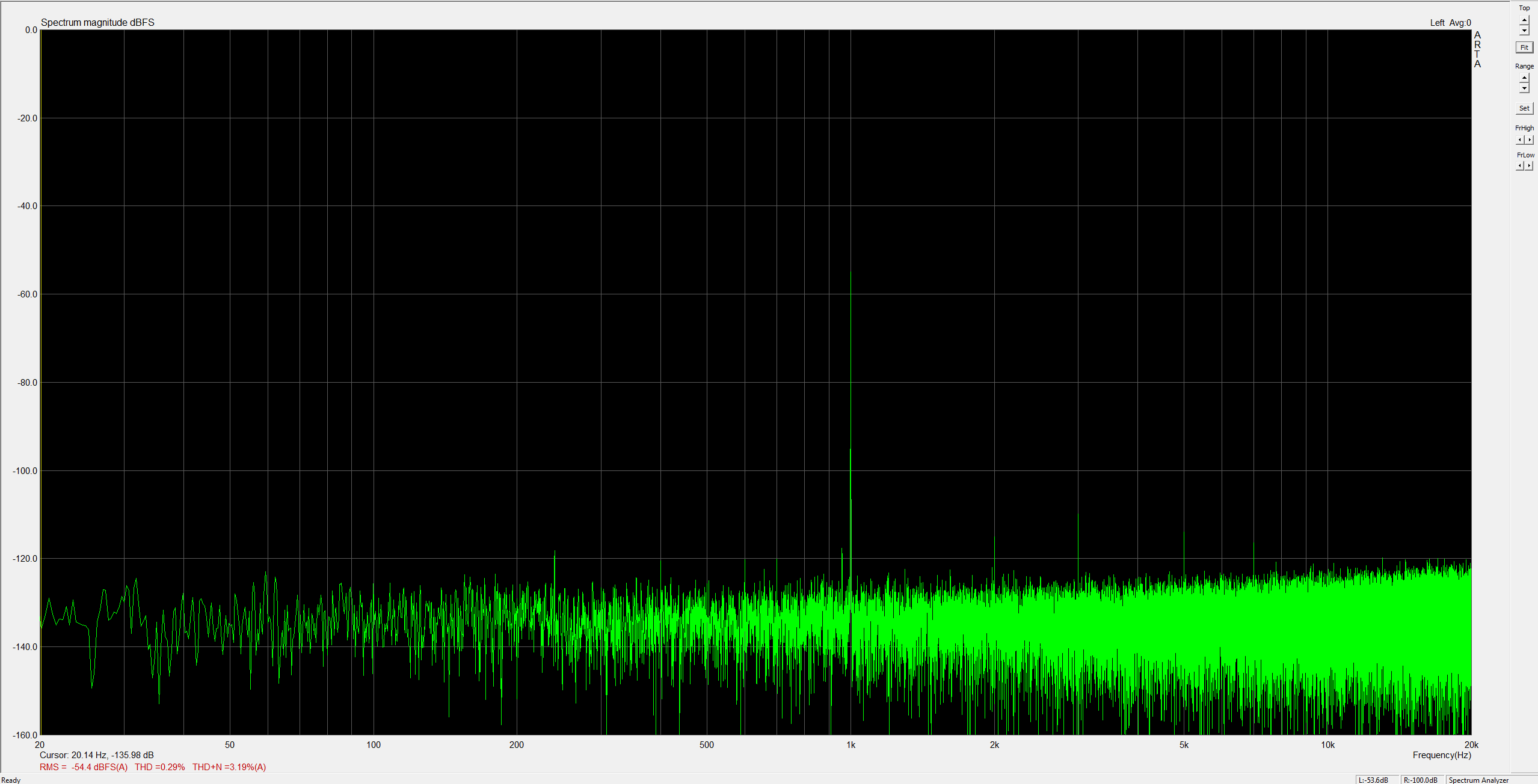

abraxalito, got it, however, LVC output 100% outperform your discrete mosfets regarding dead time distortion 😉 Look at this(sorry I mixed up the THD figures with my HiFi-TOY MK-2 project, which is also open loop but 2x100W yet):

Does dead time distortion get generated when the output devices are running soft-switched (insufficient load current for the output L current to change direction)? I had the impression that it didn't but I'm really a novice on classD stuff.😛
Actually, It does but differently for before and after critical current. Even 1W THD could be improved by the less dead time but of course, at 1/4 of max power the effect will be more bright. You can see(if loop gain is not too big, like UcD) some bump on the power sweep vs THD, where critical current reached. Anyway, if you'll see open loop headphone's amp with -3db THD<.02% let me know ))
